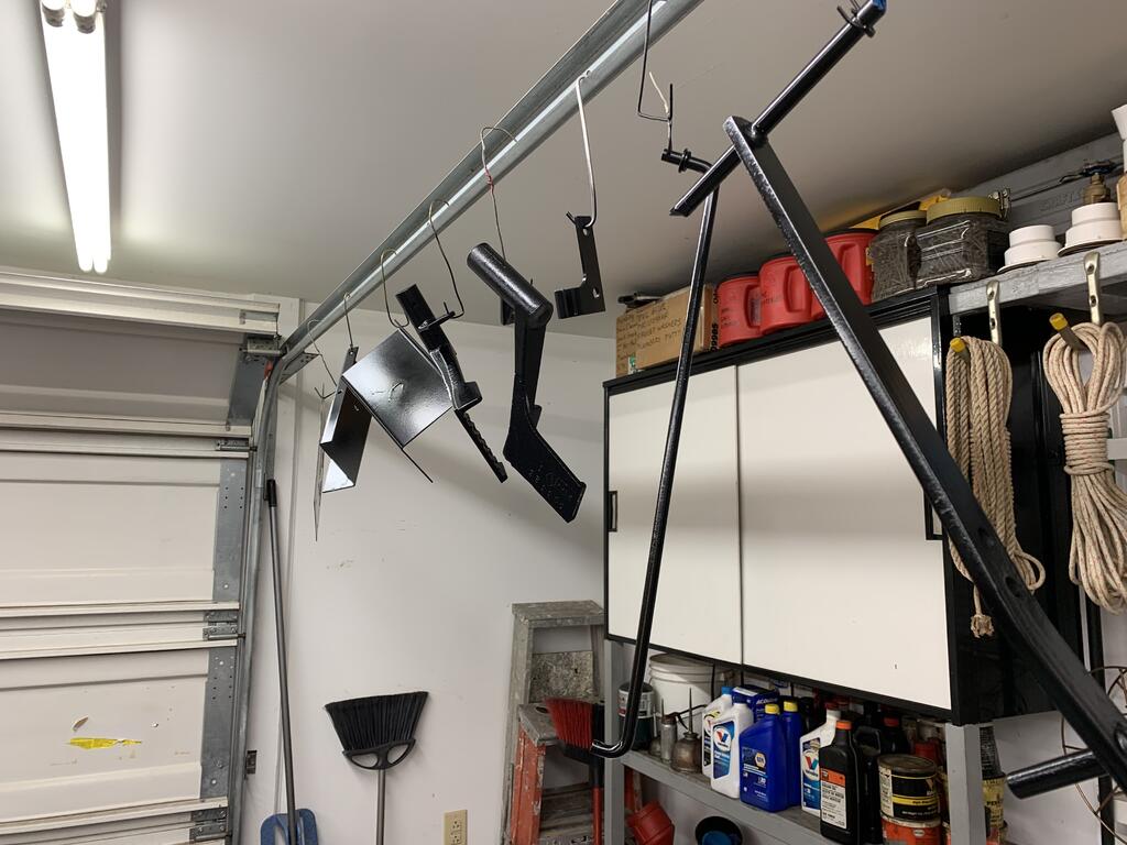

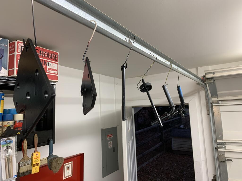

Horse Newbie 7,405 #358 Posted November 17, 2021 I painted some more parts today after work… 4 2 Share this post Link to post Share on other sites
Jeff-C175 7,212 #359 Posted November 18, 2021 1 hour ago, Horse Newbie said: painted some more parts today Me too! looks just like your place with stuff hanging from the garage tracks. DON'T FORGET THEY"RE THERE AND OPEN THE DOOR! and don't ask how I know this either! I even have a piece of cardboard just like yours! (working on my 'new to me' C-125 ) 2 Share this post Link to post Share on other sites
Horse Newbie 7,405 #360 Posted November 18, 2021 2 hours ago, Jeff-C175 said: DON'T FORGET THEY"RE THERE AND OPEN THE DOOR! I have slid them down the track before ! 2 Share this post Link to post Share on other sites
kpinnc 19,107 #361 Posted November 18, 2021 Nice to see I'm not the only one who "multi-purposes" the garage door track! 2 Share this post Link to post Share on other sites

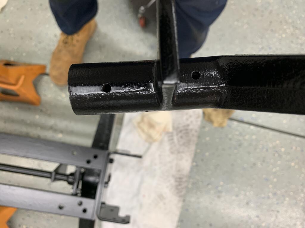

Horse Newbie 7,405 #362 Posted November 18, 2021 I would like to put grease zeros in these oil holes in my foot pedals… does anybody know the thread size for grease zeros ? 1 Share this post Link to post Share on other sites
ebinmaine 81,283 #363 Posted November 18, 2021 Grease zerks are normally 1/4 fine (28?). They can be had in other sizeseseses 3 1 Share this post Link to post Share on other sites
Jeff-C175 7,212 #364 Posted November 19, 2021 1 hour ago, ebinmaine said: 1/4 fine (28?). Correct, 1/4-28 is the so-called 'standard' size, but they make some 'bigguns' too. 2 1 Share this post Link to post Share on other sites

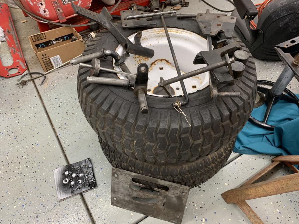

Horse Newbie 7,405 #365 Posted December 1, 2021 Got some more parts sanded … Supposed to have temps here in the high 60’s to low 70’s this week. I’ll get some more parts painted. 2 Share this post Link to post Share on other sites
oliver2-44 11,850 #366 Posted December 1, 2021 (edited) They make a smaller roughly 1/8” zerk . But I don’t know the exact size. Edited December 1, 2021 by oliver2-44 1 Share this post Link to post Share on other sites

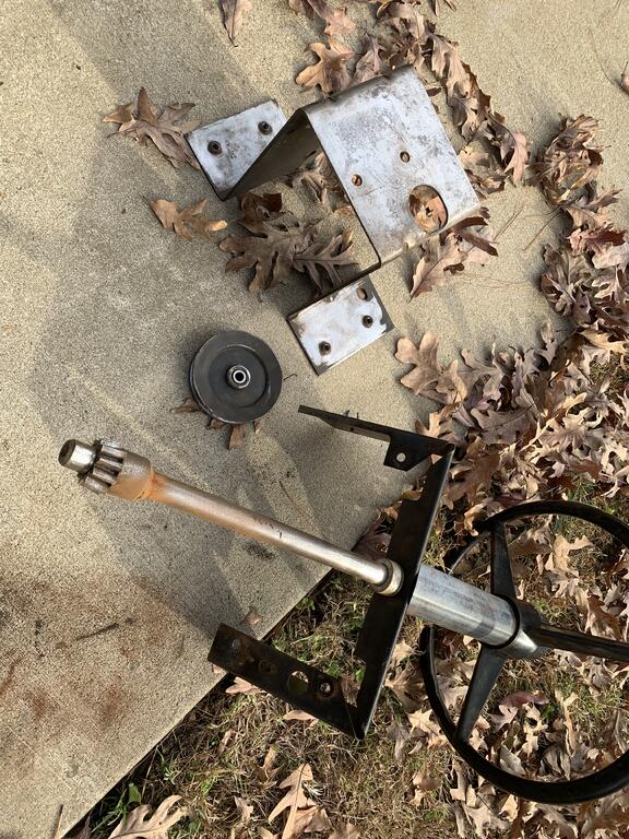

peter lena 10,126 #369 Posted December 1, 2021 @Horse Newbie looking at a lot of opportunities to correct things at build up , building that front end , use this lucas chassis grease , bombproof no fail . grease. https://www.amazon.com/Lucas-Oil-Ounce-10301-Grease/dp/B000IG20RW mount a 2 bolt flange bearing under the steering column cross brace, looking at that pulley with the tiny bearing , get the same type pulley with a larger bearing , and bush it down to 3/8 " for bolt on fit , upgrade lube , you could also correct the sloppy pto lever end fit . don't get scared, none of what I just suggested is in the book , but it works much better . pete Share this post Link to post Share on other sites
