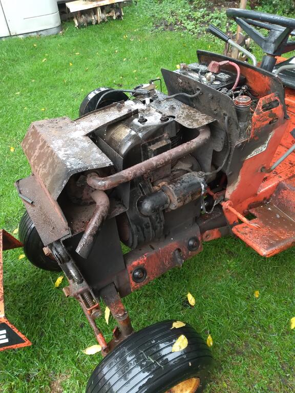

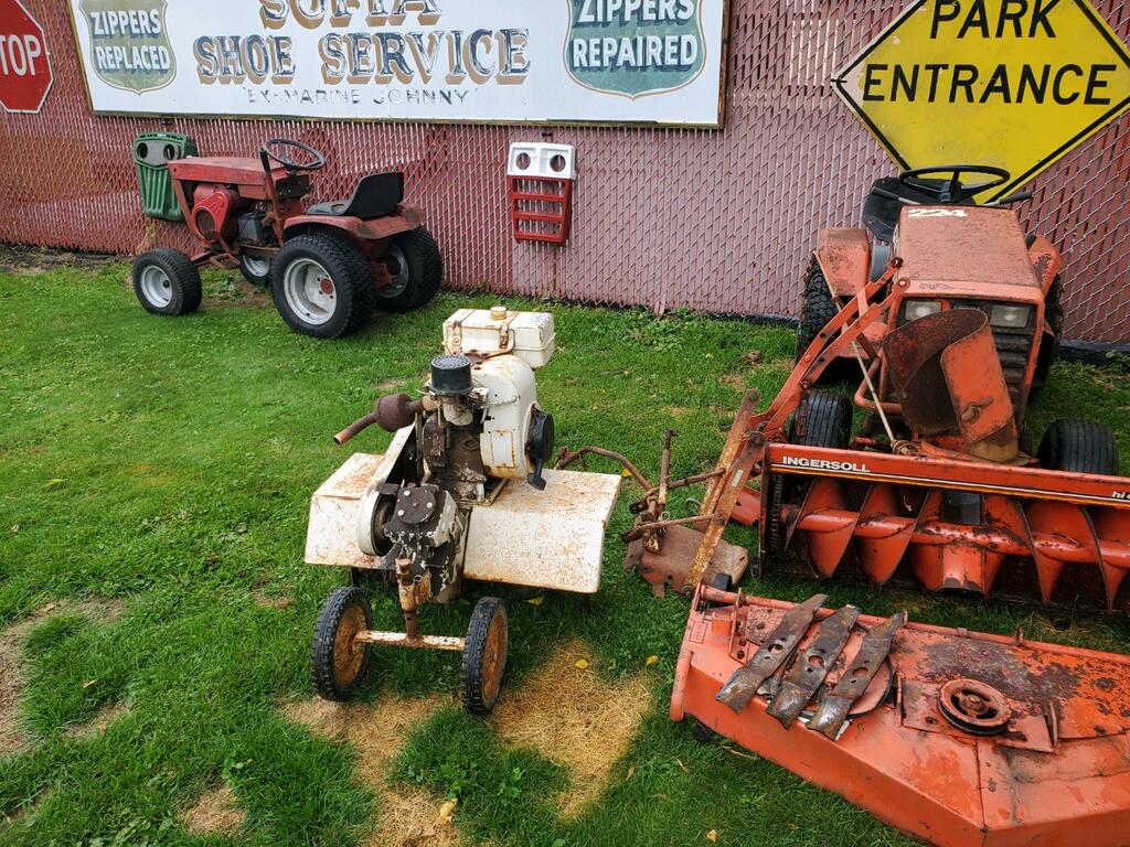

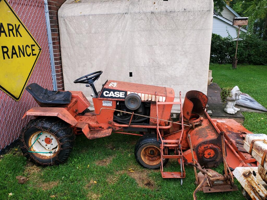

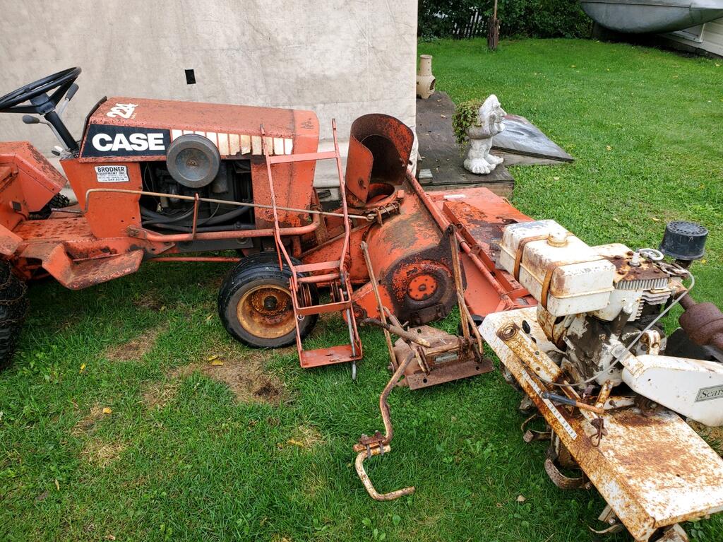

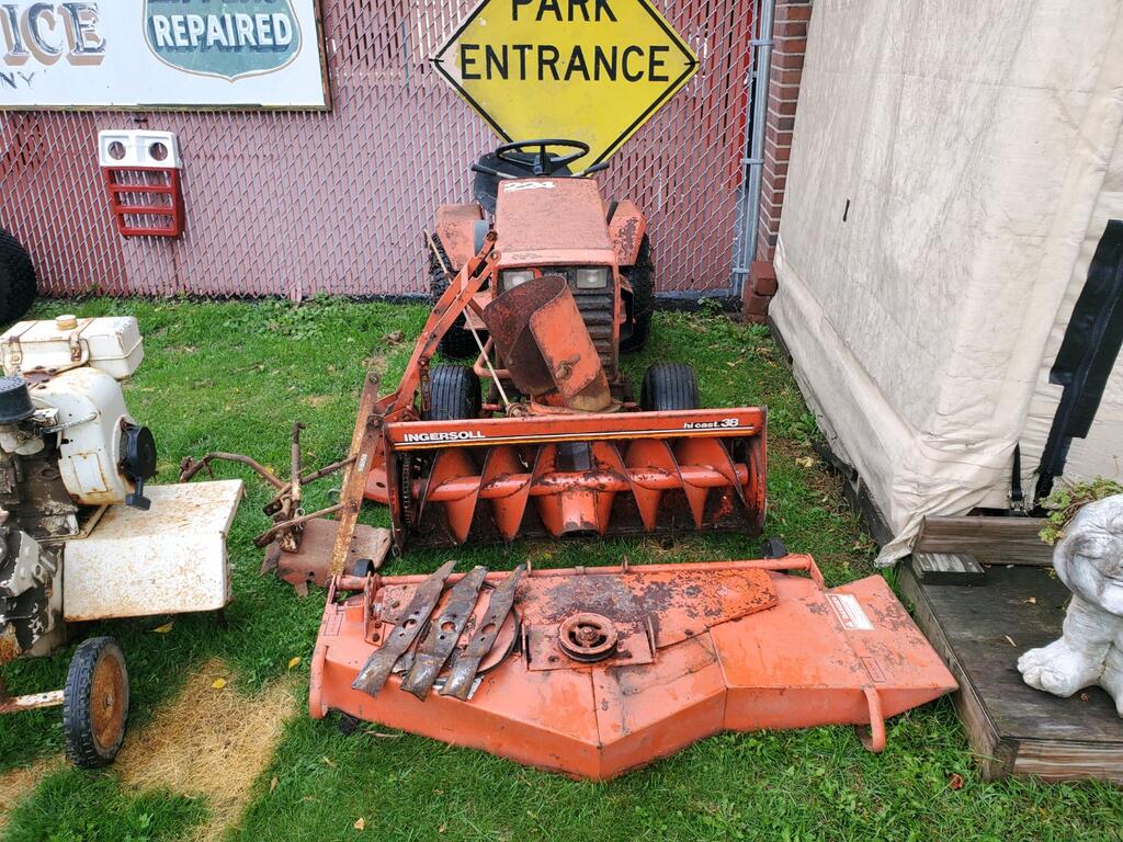

D_Mac 9,339 #1 Posted October 3, 2021 (edited) So I got this dropped of in my yard today. I have never owed one before, i know nothing about them or it for that matter. You guys know the story... ran years ago when it was parked. Case 224 with deck, snow blower, and a Sears rear mount rototiller. Any advice or knowledge anyone wants to pass along I would appreciate. See if I can't get it running and driving again. Thanks Edited October 3, 2021 by D_Mac 5 1 Share this post Link to post Share on other sites
squonk 48,303 #2 Posted October 3, 2021 Man look at all those brackets! Jigsaw puzzles are great to pass the time when the weather turns nasty! 1 Share this post Link to post Share on other sites
squonk 48,303 #3 Posted October 3, 2021 https://www.mytractorforum.com/forums/case_ingersoll_colt-forum.21/ 1 1 Share this post Link to post Share on other sites

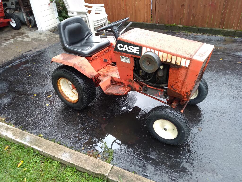

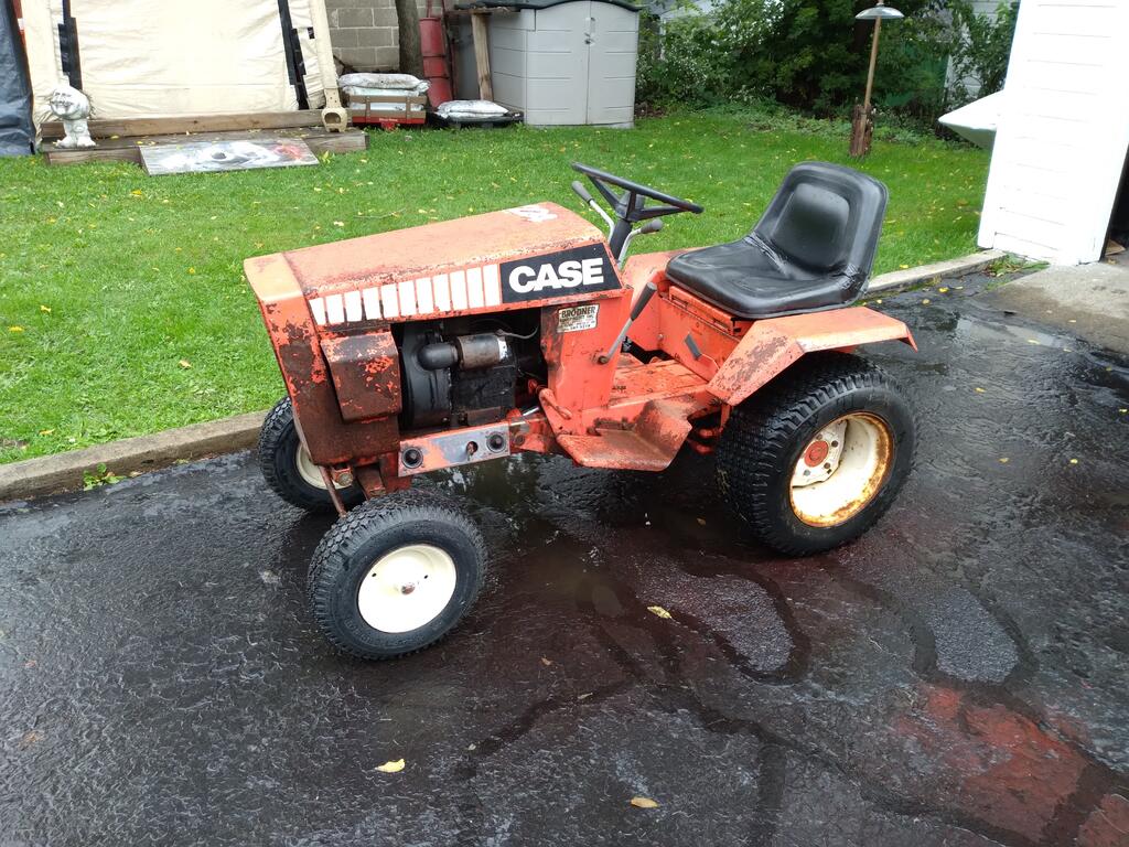

D_Mac 9,339 #6 Posted October 3, 2021 Got home and checked it out. Seems to be all there. It's ruff but definitely saveable. Going to try and figure out how to get the blower off of it tomorrow. If I can do that I can push it around, get air in the tire, then see about cranking it over. Share this post Link to post Share on other sites
slim67 2,825 #7 Posted October 3, 2021 If I had a nickel for every time I heard “it ran when I parked it” , we’d all be rich! Share this post Link to post Share on other sites
D_Mac 9,339 #8 Posted October 4, 2021 I couldn't wait until morning. I got the blower off. Pushed it over by my truck, filled the front tire with air. Popped the hood of my truck and got out the jumper cables. Tractor turns over good. Won't start, it isn't getting a spark. Not sure if there are any safety switches. I will clean the points and try again in the morning. I was working outside in the pouring rain and darkness. Any pointers are appreciated. Share this post Link to post Share on other sites

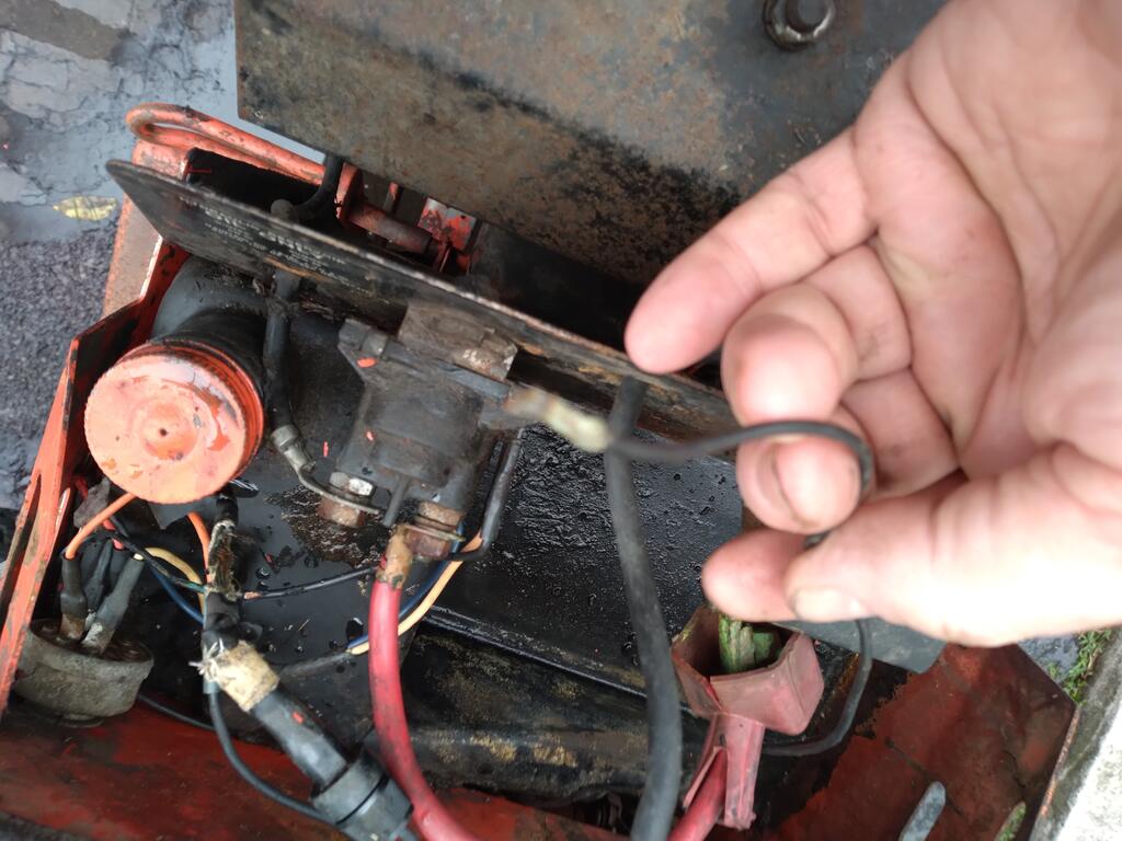

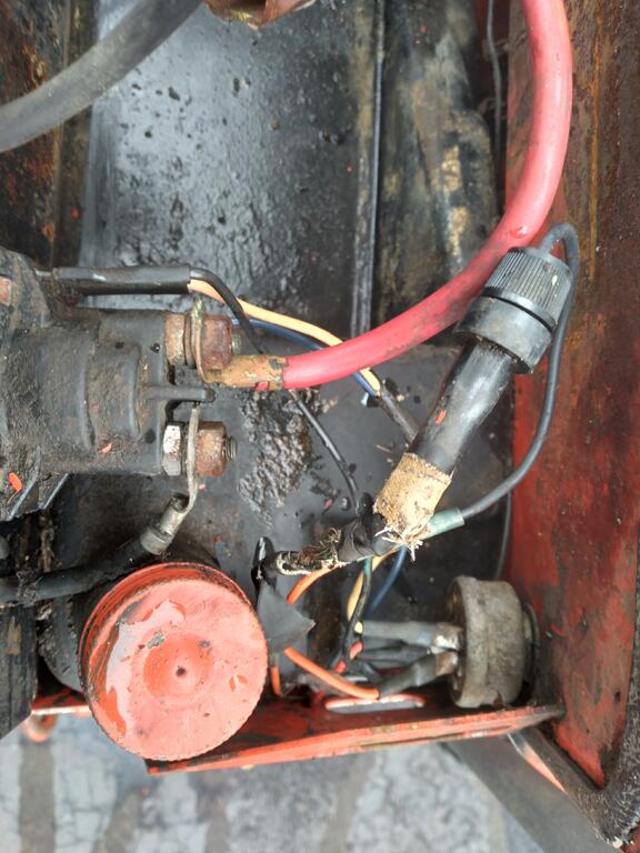

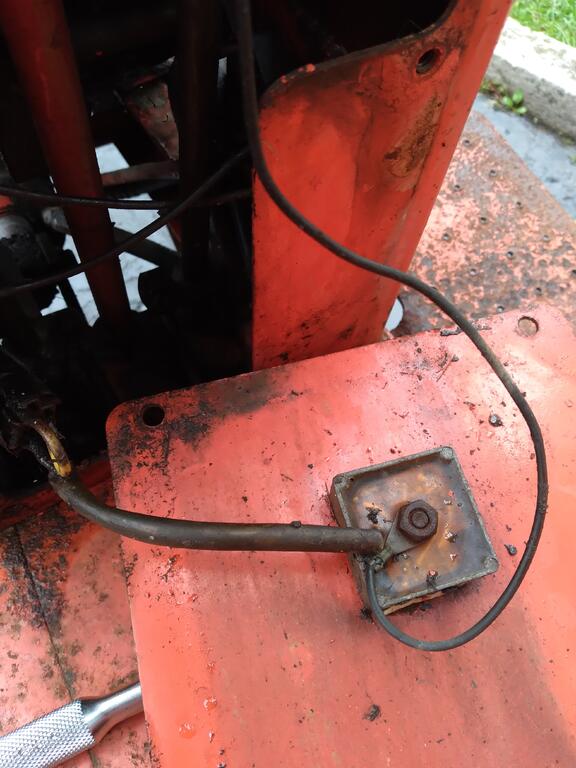

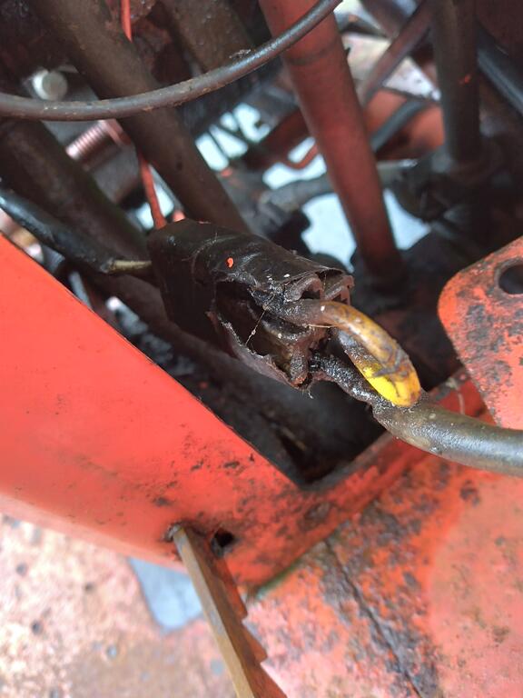

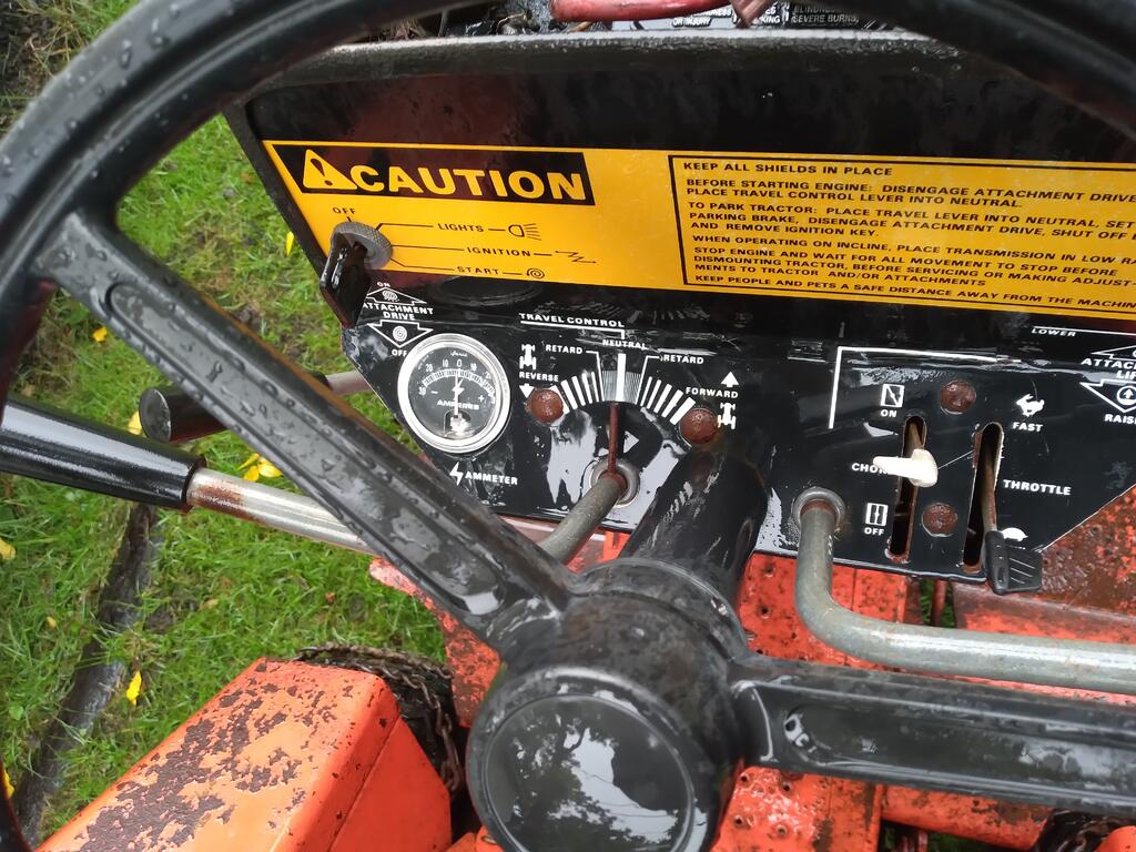

D_Mac 9,339 #11 Posted October 5, 2021 Well back outside again this morning. Front tire won't hold air making it hard to push around. I changed the two front tires and took the chains off the rears so I push it from the shed to the driveway easily. The seat was also barely hanging on so I removed it and put a better one on. Took the battery out and removed a plate in the dash to expose some wiring. Dosnt look to good. The wiring for the fuse holder seen better days. That loose black wire runs behind the dash down to that square box behind the cover. Someone hacked the connector that I belive is a safety switch. I need electrician. 1 Share this post Link to post Share on other sites
squonk 48,303 #12 Posted October 5, 2021 You need an Exorcist! 1 Share this post Link to post Share on other sites
D_Mac 9,339 #13 Posted October 5, 2021 48 minutes ago, squonk said: You need an Exorcist! I don't have a clue when it comes to electrical issues. I do know that it needs some professional attention ! Share this post Link to post Share on other sites
D_Mac 9,339 #14 Posted October 12, 2021 I got the professional help the Case needed. My cousin came over today and within a couple of hours he has up and running. Amazing how good it runs for setting outside for the past 5 yrs. It's even running on the 5 yr old gas. He did some rewiring and we put a new coil on it. Had to bypass a safety switch. I'm shocked at how smooth it runs. Drives well. Those familiar with these know that they are hydrolic drive with high / low drive. So tomorrow I will attempt to install either the mowing deck or snowblower. 2 Share this post Link to post Share on other sites

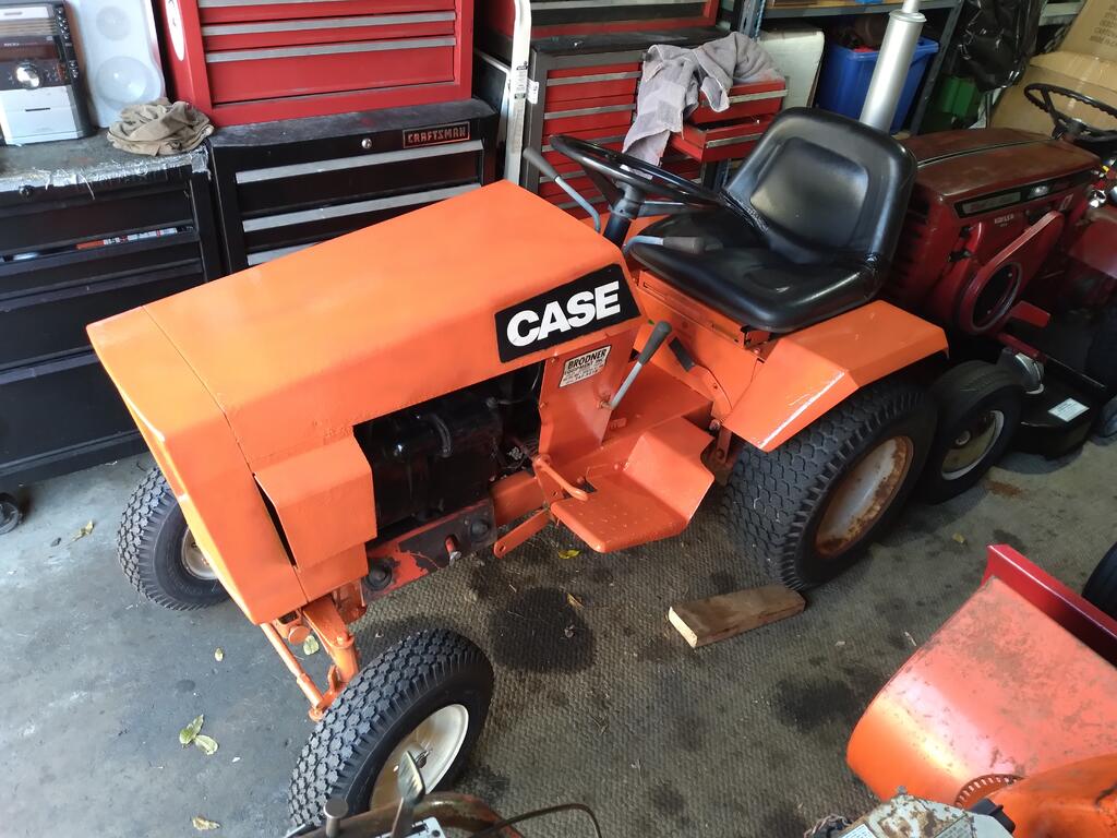

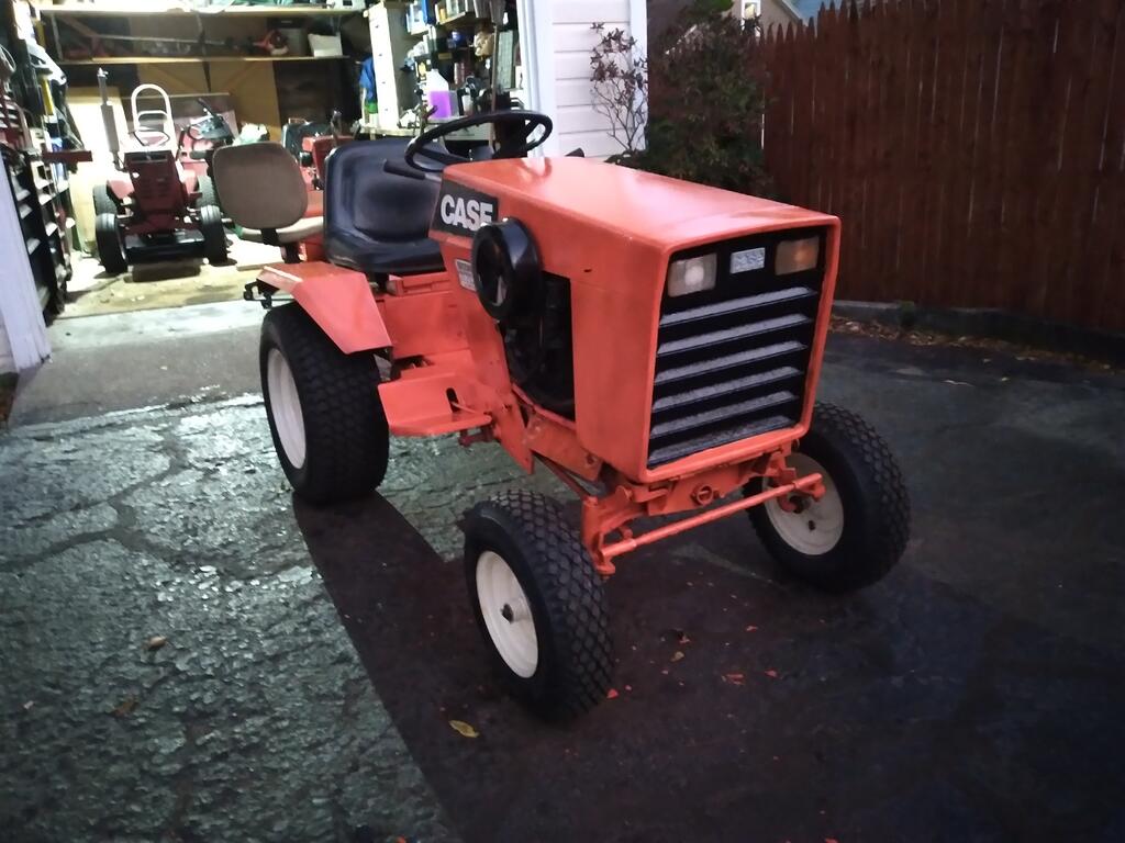

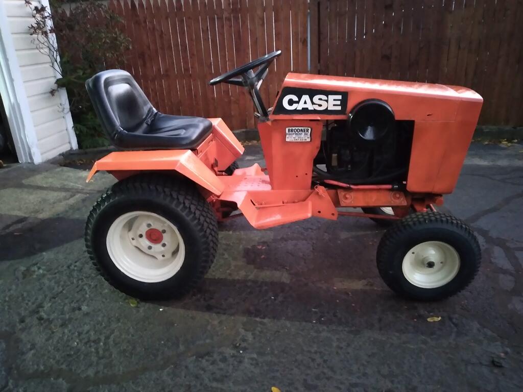

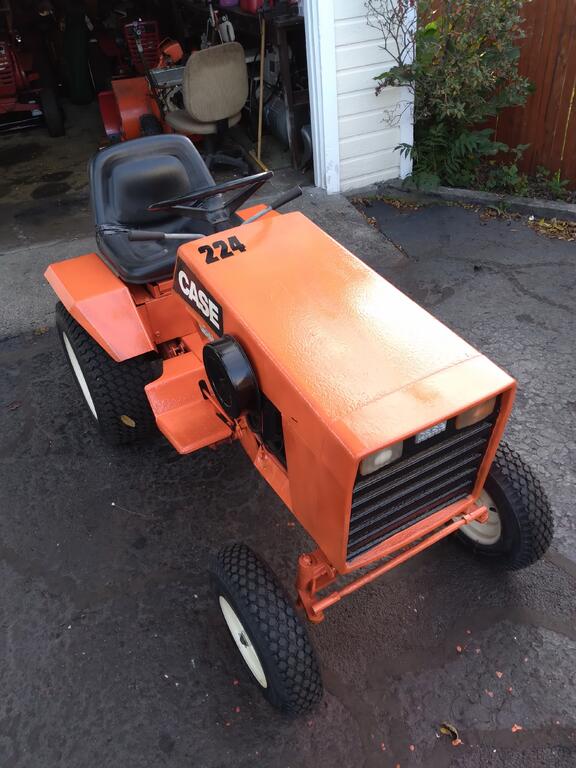

D_Mac 9,339 #19 Posted October 12, 2021 Thanks for the link. Explains it pretty good. I gave it a coat of paint. Worst paint job I have ever done. I rushed it because I am trying to get some projects done before my surgery. Color is awful. It's not finished yet but here it is. 1 Share this post Link to post Share on other sites

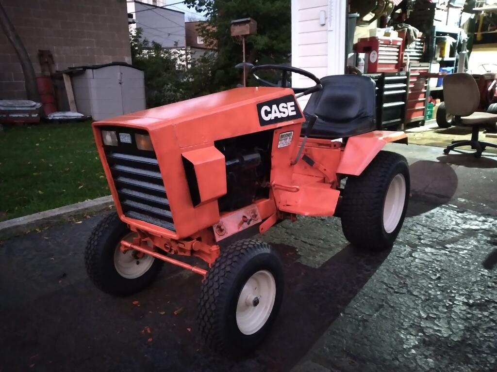

D_Mac 9,339 #20 Posted October 12, 2021 (edited) So not my best work on the paint but it's an improvement. I still can't believe how well it runs. It has 5 yr old gas in it. I did nothing to clean the carb. Turn the key it fires right up. Runs real smooth at super low idle and at wide open throttle. Engine is no joke. Before I painted it I changed the oil and replaced the headlight bulbs. Couldn't be happier with it. Edited October 12, 2021 by D_Mac 2 Share this post Link to post Share on other sites
rjg854 13,418 #21 Posted October 13, 2021 That cleaned up really nice Don. What are your plans for it now? 1 Share this post Link to post Share on other sites
D_Mac 9,339 #22 Posted October 13, 2021 (edited) Most likely sell it. It has a 48inch deck and a snowblower attachment as well. I haven't looked into either of those yet but I believe they are complete and in working condition. Paint won't mat h now but oh well. Plan B is keep it to use on my driveway !! Edited October 13, 2021 by D_Mac Share this post Link to post Share on other sites
