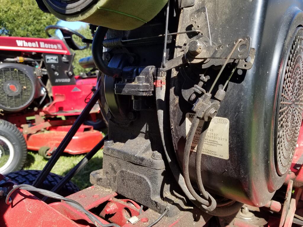

acc7484 52 #1 Posted September 30, 2021 Hello All. I have a 312-8 Wheel Horse with a Kohler M12. The other day I was mowing the lawn and all of a sudden the engine revved up real high. The governor was not loose. Everything seems to be in place. I loosened the nut and checked the adjustment of the governor according to the manual However it still over revs. Could this be an internal problem . Am I missing something? Any help or guidance would be appreciated. Thank you. Share this post Link to post Share on other sites

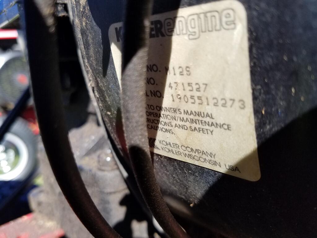

Gregor 4,848 #7 Posted October 1, 2021 (edited) Do you have a spec # on that motor? Possibly..... Spec # 421527 Edited October 1, 2021 by Gregor 1 Share this post Link to post Share on other sites

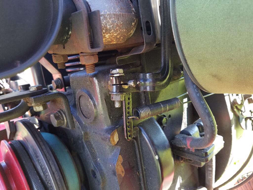

acc7484 52 #12 Posted October 1, 2021 (edited) OK Folks.... When at 1/3 throttle (that relaxes the spring to the linkage) I can push the linkage over and it has little resistance. It would seem to me that it should be a little more but I really don't know. The linkage and springs on the outside look to be OK. The shaft will turn clockwise and will stop turning counter clockwise. I adjusted the linkage by turning the shaft counter clockwise till it stopped. Them moved the lever counter clockwise all the way as well and tightened the nut. Edited October 1, 2021 by acc7484 Share this post Link to post Share on other sites
Gregor 4,848 #13 Posted October 1, 2021 12 minutes ago, acc7484 said: I adjusted the linkage by turning the shaft counter clockwise till it stopped. Them moved the lever counter clockwise all the way as well and tightened the nut. And did that work? Share this post Link to post Share on other sites
acc7484 52 #14 Posted October 1, 2021 No difference it still over revved.. Share this post Link to post Share on other sites
Gregor 4,848 #15 Posted October 1, 2021 I know of no way to inspect the governor internals, without tearing it down. Nor am I familiar with an MV series engine. Hopefully, someone smarter will chime in. Share this post Link to post Share on other sites

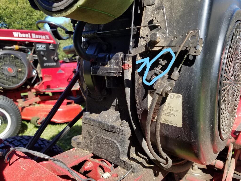

pfrederi 20,885 #16 Posted October 1, 2021 (edited) That you r governor shaft stopped when you turned it counter clockwise would indicate he stop pin was not broken. Check and make sure the small tab on the linkage contacts the high speed set screw ( blue circle) when throttle is wide open. if it does make a major adjustment to the high speed stop run it up about half way. Then see if the over rev continues. If it still wants to over rev then there maybe something wrong internally. The sudden onset leans toward something breaking.... Edited October 1, 2021 by pfrederi Share this post Link to post Share on other sites
acc7484 52 #17 Posted October 1, 2021 This tractor always ran slow. I never adjusted the high speed setting. From what I can see the lever does not reach the top of the screw head at full throttle. Its painted in place. Im leaning towards an internal issue. I shut it down. The engine has developed a slight knock ..... I have a very bad sickness...... and now that Im retired its getting worse. Yes ..... I save unwanted tractors and bring them back to life. Im right in the middle of painting my newest acquisition. So this guy will be on the back burner. Share this post Link to post Share on other sites
