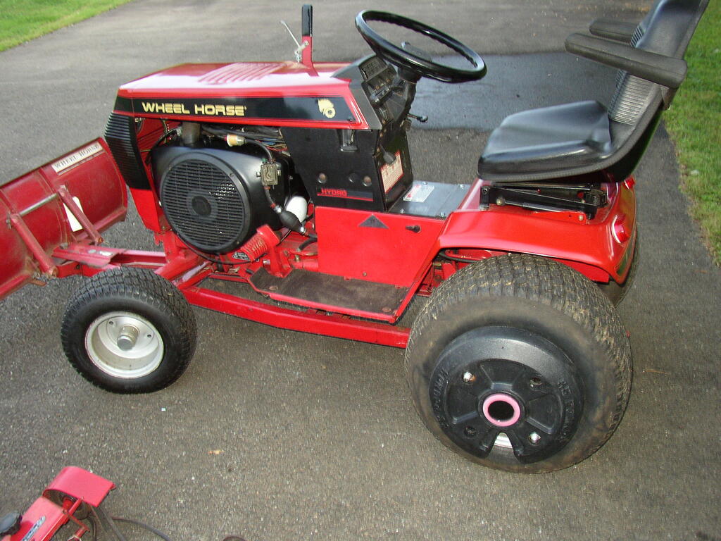

SPINJIM 1,996 #11 Posted September 30, 2021 (edited) You're about 40 minutes north of me. There are a lot of rear wheel weights on local Craigslist and Facebook Marketplace that will fit 12" rear wheels. Many of them came from older Craftsman tractors that had the same rear wheels. Just have to black out or remove the center medallion. I just picked up a set of Craftsman weights (55 lbs.each) for $25 to put on a 520-H. They're cheaper and won't rust your wheel rims with leaking fluid. Edited October 1, 2021 by SPINJIM 1 1 Share this post Link to post Share on other sites

ebinmaine 77,307 #13 Posted October 1, 2021 19 minutes ago, BOB ELLISON said: filled I do both fluid and steel weights. 255 lb of fluid and this year I'll try inner and outer weights. Should be (65 + 25) x 2. 180 additional lbs. Tractor alone will be around 1000 lbs. Plus 60" plow. Plus me Bear. 1400 maybe? Sheeesh. 1 Share this post Link to post Share on other sites
