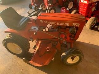

Jhawkins 43 #1 Posted September 29, 2021 I HAVE AQUIRED A 1276. THE HYDRO SEEM SLUGISH AT TIMES. IT HAS 10W30 IN IT AND I PLAN ON DRAINING IT AND INSTALLING A NEW FILTER AND FULL SYNTHETIC 10W30. I HAVE BEEN TOLD THAT THE PROPER BELT IS IMPORTANT HOWEVER, I'M HAVING TROUBLE ON THE RIGHT SIZE AS THE ONE ON THERE IS RAN INCORRECTLY. ANY HELP WOULD BE APPRECIATED. Share this post Link to post Share on other sites

Jhawkins 43 #4 Posted September 29, 2021 NOW THAT I HAVE PUT ON A NEW FILTER AND FLUID IT DOES THE SAME PUT I SEEM TO TRAVEL ALOT FASTER WHEN I AM TURNING LEFT. Share this post Link to post Share on other sites
RandyLittrell 3,942 #5 Posted September 29, 2021 3 hours ago, Jhawkins said: NOW THAT I HAVE PUT ON A NEW FILTER AND FLUID IT DOES THE SAME PUT I SEEM TO TRAVEL ALOT FASTER WHEN I AM TURNING LEFT. Nothing in the system should cause any change in speed when turning, so not sure how to help you there unless you have some wheel bearing issues in the front maybe?? Not likely, but can't really think of anything else to do with turning. Randy 1 Share this post Link to post Share on other sites
pfrederi 19,278 #6 Posted September 29, 2021 1 minute ago, RandyLittrell said: Nothing in the system should cause any change in speed when turning, so not sure how to help you there unless you have some wheel bearing issues in the front maybe?? Not likely, but can't really think of anything else to do with turning. Randy Bad rear hub key allowing slippage??? Or really off the wall but actually happened to me. Thought the belt was slipping on my L-107 replaced it, still seemed to slip marked the hubs to check the keys no problem..Then noticed the rear tire was flat but the side walls are pretty stiff so it wasn't noticeable the bead had loosened and the wheel actually slipped in side the tire.... 2 Share this post Link to post Share on other sites

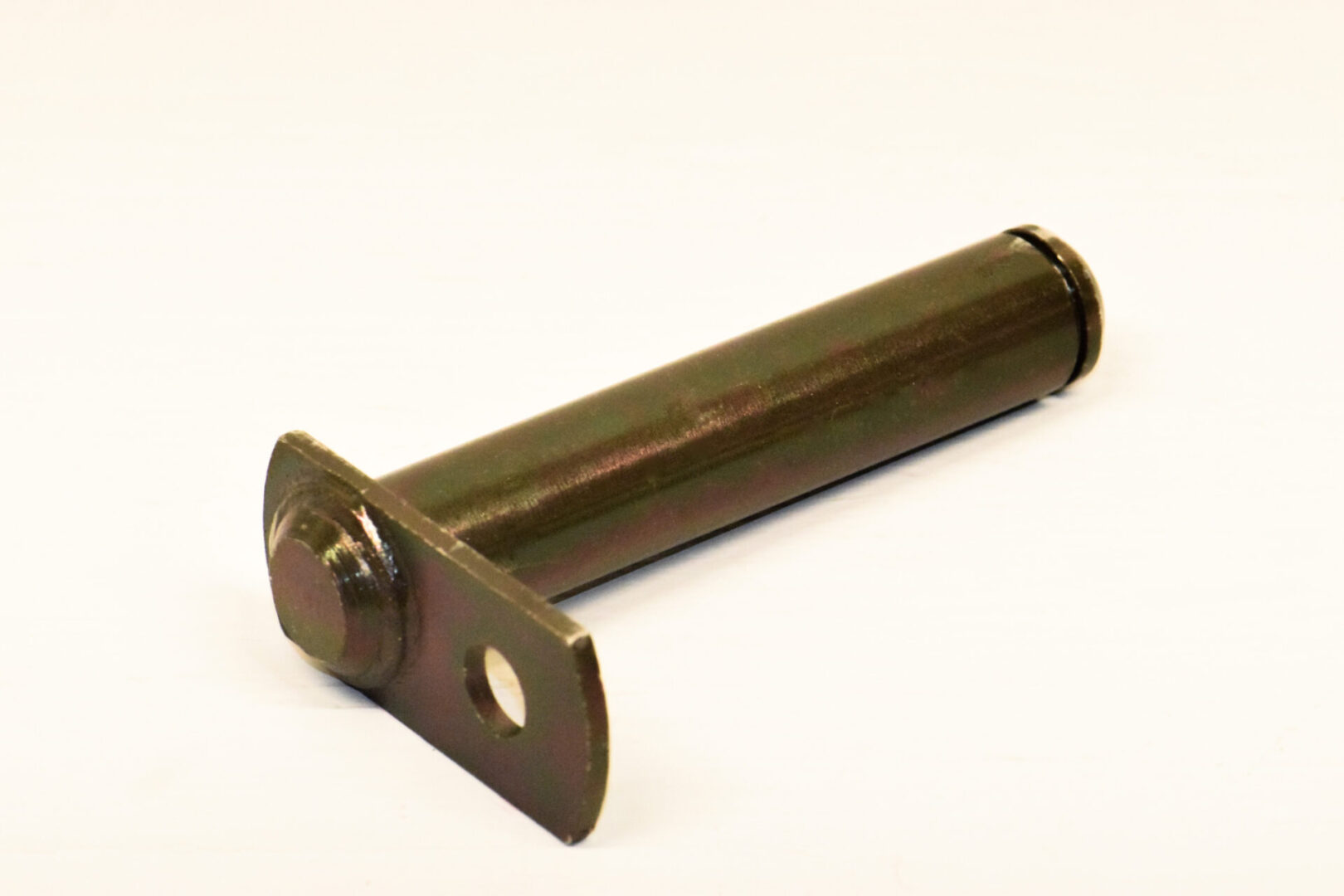

Jhawkins 43 #7 Posted September 29, 2021 I DO HAVE SOME FRONT END ISSUES. I'M REPLACING BEARINGS AND IT SEEMS MY FRONT AXLE HAS ALOT OF PLAY. IM GOING TO REPLACE THE PIN IF I CAN FIND A GOOD ONE AND SEE WHAT THAT DOES. HOPEFULLY I DONT HAVE TO REPLACE THE WHOLE FRONT AXLE, Share this post Link to post Share on other sites

Jhawkins 43 #9 Posted September 29, 2021 Thanks Randy. I have a big 220 welder that and different grinders that I could build it up and then grind it back to normal. I might try that. Share this post Link to post Share on other sites

ri702bill 10,583 #12 Posted September 30, 2021 Since the axle pivot pin is a simple weldment, you may wish to make a new one rather that attempt to grind your welded up repair back to shape?? The pivot pin only wears on the bottom due to the weight of the tractor - that is where you ground weld will be. You could grind off the existing weld, rotate the locking tab 180 degrees and reweld it instead. I recently posted a thread under Restorations and Modifications about drilling & reaming the axle pivot and spindle bores to accept bronze bearings - done a few and it works well. Bill 1 Share this post Link to post Share on other sites
squonk 44,870 #13 Posted September 30, 2021 Lowell has the axle pins https://wheelhorsepartsandmore.com/product/6216-axle-pivot-pin-for-wheel-horse/ 1 Share this post Link to post Share on other sites
Jhawkins 43 #14 Posted September 30, 2021 Just ordered one 1 Share this post Link to post Share on other sites
