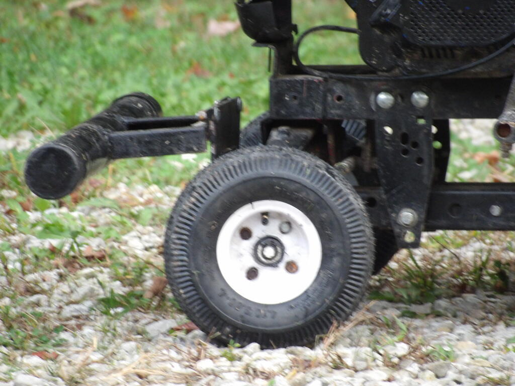

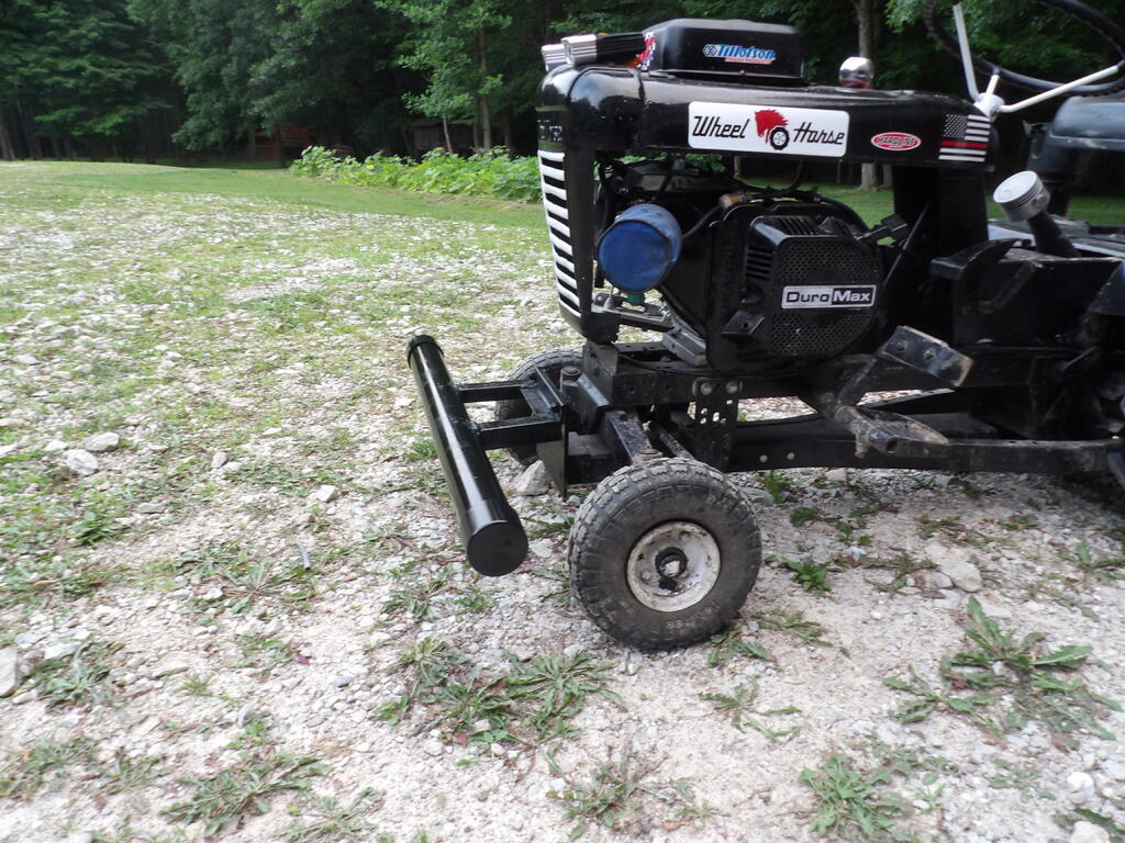

Well, the good thing is... guys... this topic is not limited to guys who have bushings... as when I presented the Stens 215-267, I mentioned that these needle bearings work with stock rims, and with aftermarket rims.
The Stens 215-267 is an excellent alternative to both bushings and regular bearings... :thumbs:
Right now, I am running aftermarket rims and tires with my Stens bearings...

Snoopy11
Before:
After:
Don
  • Like 1
