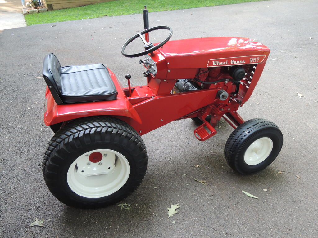

rmaynard 17,409 #57 Posted October 17, 2021 (edited) On 10/16/2021 at 11:53 AM, Brockport Bill said: CAN YOU BE SPECIFIC -- MAKE, MFG ETC? THANKS PPG Automotive. Shop-Line or Omni. Color - Wheel Horse Red #70234. This can be mixed in acrylic urethane or enamel. Here is an example of 70234 urethane - Other PPG colors are Ford New Tractor Red #71969 mixed in enamel - and urethane Edited October 17, 2021 by rmaynard 2 Share this post Link to post Share on other sites

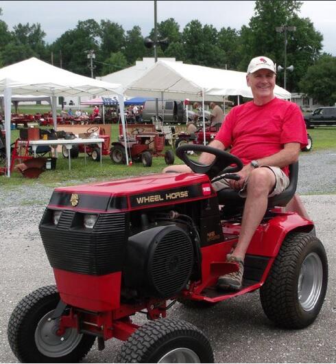

Brockport Bill 2,409 #58 Posted October 17, 2021 super looking Bob - the tractor too!!! Haha -------------------- great job -- i am all envy - the shine gloss is spectacular - even the cream/almond rims are awesome!! As a side note i read your inventory list -- see you have 416H ----- I am working on a 416 H right now - a 1991 - Bill 1 hour ago, rmaynard said: PPG Automotive. Shop-Line or Omni. Color - Wheel Horse Red #70234. This can be mixed in acrylic urethane or enamel. Here is an example of 70234 urethane - Other PPG colors are Ford New Tractor Red #71969 mixed in enamel - and 1 1 Share this post Link to post Share on other sites
