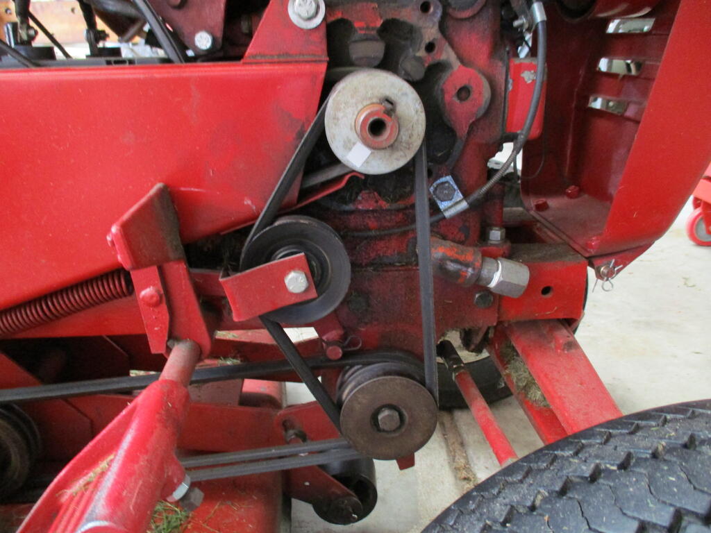

pfrederi 21,046 #2 Posted September 27, 2021 Is your belt guide in the proper location. First pic disengaged second engaged Share this post Link to post Share on other sites
JustinW.73 224 #3 Posted September 27, 2021 15 minutes ago, pfrederi said: Is your belt guide in the proper location. First pic disengaged second engaged Mine doesn’t have the keeper on the moving pulley. Just has 2 small rods bolted to the engine block. Share this post Link to post Share on other sites
pfrederi 21,046 #4 Posted September 27, 2021 That would be your problem. Picture ??? Share this post Link to post Share on other sites

71_Bronco 1,072 #10 Posted September 28, 2021 My commando 8 did the same thing, gear drive deck spun super slowly when disengaged. I tried adjusting the guide on the pulley numerous times. There is also supposed to be a bent steel rod that helps guide the belt too, attached to the block. Its part 85 in the diagram below. Share this post Link to post Share on other sites
pfrederi 21,046 #11 Posted September 28, 2021 Would not be hard to make one. Piece of sheet metal about 1" wide and bend it drill a hole in it... Share this post Link to post Share on other sites
