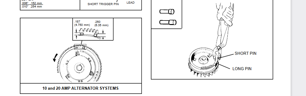

pfrederi 21,181 #51 Posted September 28, 2021 4 minutes ago, Gregor said: I looked at that manual. I could not find any corresponding numbers to identify the engine. Maybe because it was made for Sears? Page 66 1 Share this post Link to post Share on other sites

Gregor 4,848 #64 Posted September 28, 2021 40 minutes ago, Jimdad85 said: It sticks on the intake stroke... IT ? What is IT ? Intake valve? Exhaust valve? Pour a little light weight oil (MMO) in there and work IT. IT will free up. It appears you have the flywheel off, I think. Any magnets in the flywheel, either on the outside or the inside? Any trigger pins located on the outer edge of the flywheel? Share this post Link to post Share on other sites

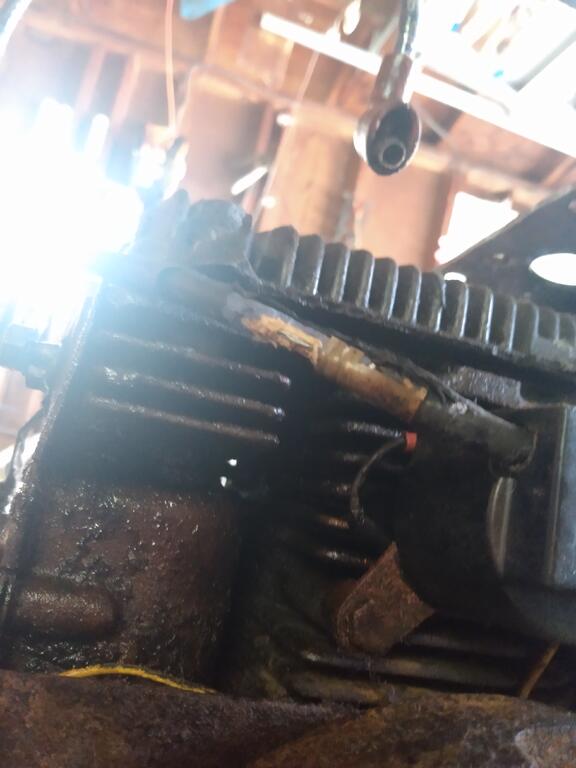

Jimdad85 12 #65 Posted September 28, 2021 The yellow wire grounds to the motor with the ignition switch. Is this the coil Share this post Link to post Share on other sites
Jimdad85 12 #66 Posted September 28, 2021 It would appear that i have spark.. VID_20210928_133554190~2.mp4 1 Share this post Link to post Share on other sites
Gregor 4,848 #67 Posted September 28, 2021 If the spark plug wire is coming from it, that's the coil. Pic isn't too clear to me. Share this post Link to post Share on other sites
Jimdad85 12 #68 Posted September 28, 2021 I think its a metal on metal grab or stick...valves move freely..dead spot in bearing maybe Share this post Link to post Share on other sites
Jimdad85 12 #69 Posted September 28, 2021 Yes, its the coil. Thank you guys..gotta fix that stick Share this post Link to post Share on other sites

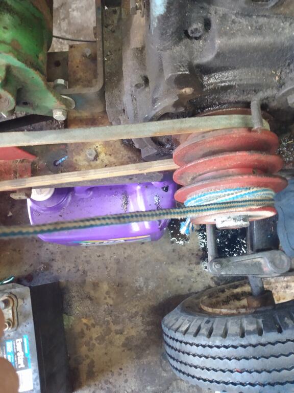

Jimdad85 12 #71 Posted September 28, 2021 This morning i drained the black sludge, added 20% lucas high mileage and 15-20 the rest. I keep using a rope on the outside pulley and it turns over but has a rough spot. And just now as you read this, i dribbled a small amount of gasoline in the spark hole. Pulled my rope and she ran!!!! 1 Share this post Link to post Share on other sites
Gregor 4,848 #72 Posted September 28, 2021 Aint as "DEAD" as you think ! Share this post Link to post Share on other sites
Jimdad85 12 #73 Posted September 28, 2021 That really is the greatest feeling Share this post Link to post Share on other sites
Gregor 4,848 #74 Posted September 28, 2021 (edited) 13 minutes ago, Jimdad85 said: Pulled my rope and she ran!!!! Does this thing have notches for a rope AND a V for a belt on the pulley? Is there a V in the pulley, or did someone simply stick a belt into the rope groove? Edited September 28, 2021 by Gregor Share this post Link to post Share on other sites
Jimdad85 12 #75 Posted September 28, 2021 Nope, im just a redneck and wrapped the rope around the pulley😂 Share this post Link to post Share on other sites
