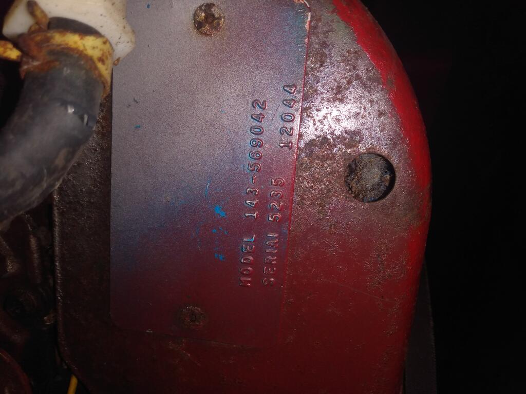

Achto 32,795 #26 Posted September 28, 2021 1 minute ago, Jimdad85 said: Ok also, they said that this is a 15hp briggs...any truth in that? Need numbers to verify that. There should be number stamped into the fan shroud, usually near the top but could be else where on the shroud. Share this post Link to post Share on other sites

Achto 32,795 #31 Posted September 28, 2021 (edited) 22 minutes ago, Jimdad85 said: The fan shroud on your engine looks more like a Tecumseh than a Brigg & Stratton. Besides the shape, I have not seen an ID tag on a Briggs like the one riveted on the front of yours. Edited September 28, 2021 by Achto Share this post Link to post Share on other sites
pfrederi 21,177 #32 Posted September 28, 2021 (edited) 3 minutes ago, Achto said: Than fan shroud on your engine looks more like a Tecumseh than a Brigg & Stratton. Besides the shape, I have not seen an ID tag on a Briggs like the one riveted on the front of yours. Agree hole in shroud for fuel line looks Techy... Briggs Stamped ID ## Edited September 28, 2021 by pfrederi Share this post Link to post Share on other sites
Jimdad85 12 #33 Posted September 28, 2021 5 minutes ago, pfrederi said: Agree hole in shroud for fuel line looks Techy... Briggs Stamped ID ## I will go home after work and check the tag. Thank you guys Share this post Link to post Share on other sites
Jimdad85 12 #34 Posted September 28, 2021 And here we go..let the games begin😊 Share this post Link to post Share on other sites

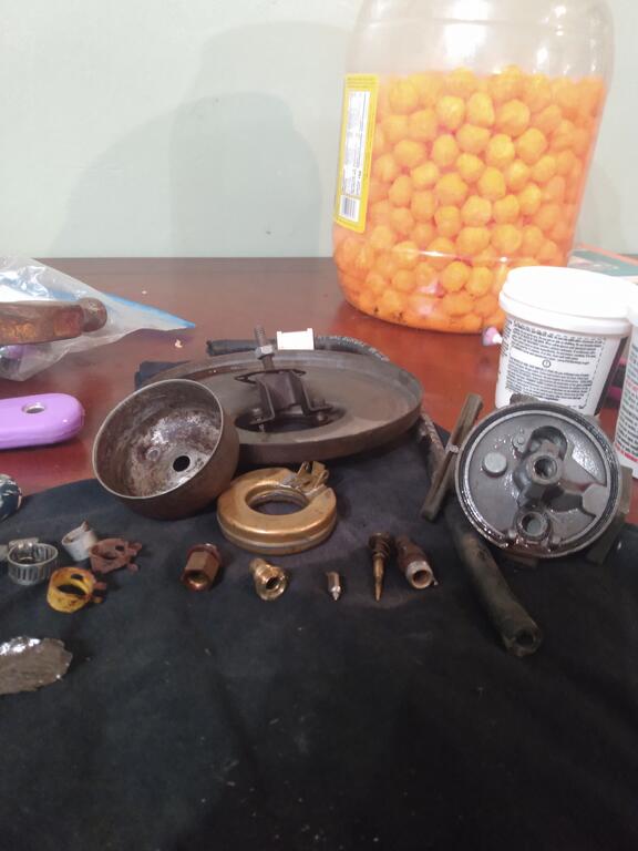

Jimdad85 12 #35 Posted September 28, 2021 Getting an early stary to the day... 1 Share this post Link to post Share on other sites

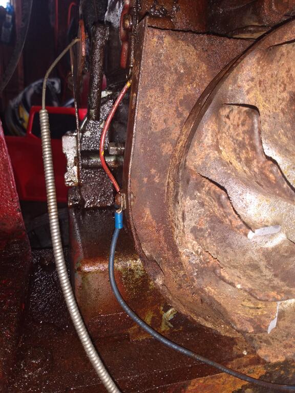

Jimdad85 12 #37 Posted September 28, 2021 There is a plunger style switch on/off labeled ignition in the wires seem to run inside the motor which I would assume would be for the coil I believe that is some sort of kill switch Share this post Link to post Share on other sites
Gregor 4,848 #38 Posted September 28, 2021 19 minutes ago, Jimdad85 said: Getting an early stary to the day... Could be, and BRING BACK MY CHEESE BALLS ! 1 Share this post Link to post Share on other sites
Jimdad85 12 #39 Posted September 28, 2021 Cheeseballs make a great carb cleaner...everyone knows this. I believe i have a stuck valve🙄. Motor turns freely by hand so far each direction..then "stops" dont want to force it..creeping oil down spark hole and wait..any other ideas Share this post Link to post Share on other sites

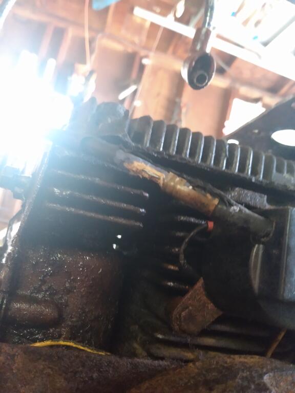

pfrederi 21,177 #42 Posted September 28, 2021 (edited) Looks like a big mouse nest in the hole for the fuel line in the air shroud. You have a Sears engine made by Tecumseh. HH100 I would think. Could be solid state ignition be careful. I will have to look up some stuff. Edited September 28, 2021 by pfrederi Share this post Link to post Share on other sites

Gregor 4,848 #45 Posted September 28, 2021 13 minutes ago, Jimdad85 said: Well I have good news and bad news was able to get the motor to turn several rotations using the flywheel and some love valves both up open and close but when I pass the tight spot there's a very tight high pitched squeak there is oil in the crankcase I don't know if that's a flat spot on a bearing or what you think that might be Pull the shroud, and get rid of that mouse nest, or whatever else is in the, before you turn it over anymore. Walnut shells could tear up a coil, or stator pretty quickly. Share this post Link to post Share on other sites

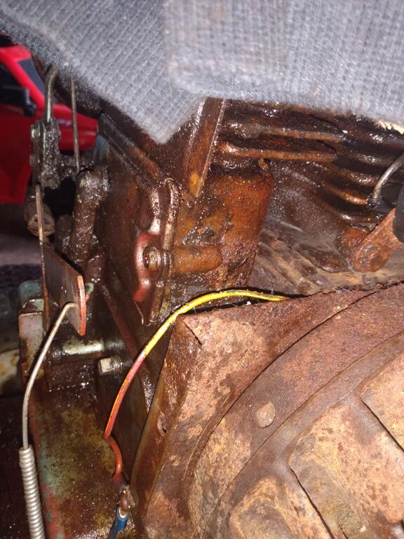

pfrederi 21,177 #47 Posted September 28, 2021 Be very careful the wire that goes to eh dash switch is probably a kill wire for the SSI. DO NOT apply any power to it that would destroy the SSI Share this post Link to post Share on other sites

Jimdad85 12 #50 Posted September 28, 2021 So the wires for "ignition" one went to battery and the other grounds behind the shroud with a wire running to the wierd bog thing .coil? Share this post Link to post Share on other sites
