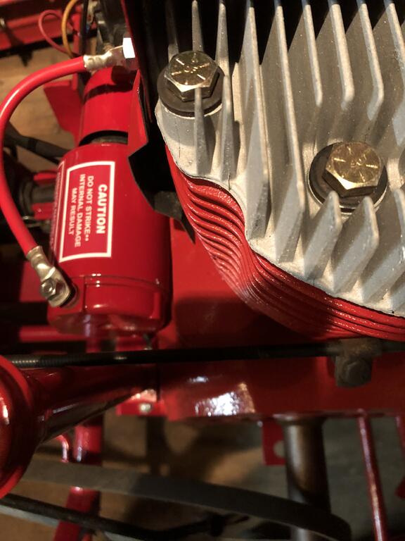

WheelhorseBob 1,550 #6 Posted September 29, 2021 16’s have this notch in the cooling fins in my experience. Share this post Link to post Share on other sites
kpinnc 19,060 #7 Posted September 29, 2021 14 hours ago, WheelhorseBob said: 16’s have this notch in the cooling fins in my experience. Bob, if that engine is yours- I'm sending my next one to you for rebuild... 1 Share this post Link to post Share on other sites

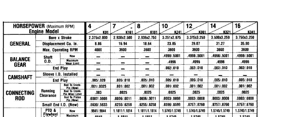

Shuboxlover 490 #8 Posted September 29, 2021 Taking the head bolt count out of the equation, am I correct in saying that if I took the head off and measured the bore and stroke, that would tell me for sure? If that's the case, what is the bore and stroke for a 16hp? or 14, 12, 10 for that matter? Thanks so much!!! Share this post Link to post Share on other sites
pfrederi 21,301 #9 Posted September 29, 2021 page 1.6 of Kolher K series service manual Share this post Link to post Share on other sites
