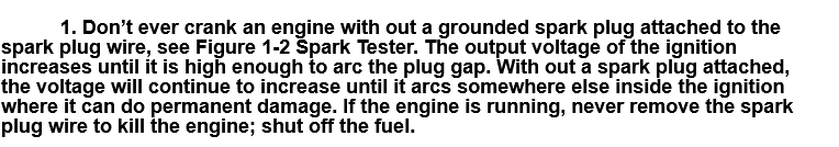

Gregor 4,848 #1 Posted September 25, 2021 (edited) I have been researching Tecumseh SSI, and other ignition systems. I ran across an article, although I am not certain of the author, I believe it might be a guy named Dave Cave from Gas Engine Magazine. Again, I'm not sure, but I did read this, I am sure most of us are guilty of this, while checking compression, or whatever. It's something I was not aware of. Here is a link to the complete article. http://enginesandmagnets.com/id9.html Edited September 25, 2021 by Gregor 3 1 Share this post Link to post Share on other sites
Maxwell-8 4,371 #2 Posted September 25, 2021 Intresting, I am guilty as well, intresting article, so voltage will keep raising whitin the coil. And may do damage to thing like burn the points or condensor? Share this post Link to post Share on other sites
ebinmaine 80,765 #3 Posted September 25, 2021 13 minutes ago, Maxwell-8 said: Intresting, I am guilty as well, intresting article, so voltage will keep raising whitin the coil. And may do damage to thing like burn the points or condensor? Or worse yet, the coil itself. @Gregor Thanks for posting this. 1 Share this post Link to post Share on other sites

gwest_ca-(File Mod) 12,489 #5 Posted September 25, 2021 10 minutes ago, Maxwell-8 said: Intresting, I am guilty as well, intresting article, so voltage will keep raising whitin the coil. And may do damage to thing like burn the points or condensor? Most likely burn a hole in the case of the coil to get to the coil mounting bracket or burn a hole in the plug wire. Older products with the shaft-driven magnetos also carried the warning. Wico, Fairbanks Morris and Edison-Splitdorf were common. 4 Share this post Link to post Share on other sites
