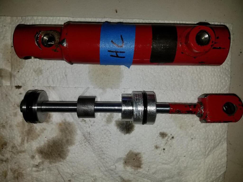

Brockport Bill 2,428 #1 Posted September 23, 2021 I took the challenge to rebuild a leaky 416h lift cyl - ordered a hydro lift cylinder O RING repair kit ( $17 ). It was difficult getting snap ring off .... then getting piston rod out... but otherwise learning as i go and making progress. To mirror what i was doing I removed a second leaky 520HC lift cylinder therafter and looked at them side by side..................... I had planned to replace the O RINGS side by side for the two cylinders. I would have guessed as a NEWBIE to these type repairs that lift cyl were same and interchangable????? They are NOT the same. There is a large spacer piece in the cyl that came from the 520 HC that would appear to shorten the travel distance of the piston rod??? I actually planned to do a couple other cyl from a couple other WH I recently got. But now I am confused. Are there different lift cyls for different models? Do I have to be sure I replace each cyl back onto the exact tractor I removed it from? Are there different cyl model #s ? I looked at the diagrams online and they appear to be the same without that spacer? Any help and insights would be helpful - many thanks !!!!!!! Last thought - could there be a chance this one with spacer had the spacer added - or perhaps the one without had a spacer removed? 1 1 Share this post Link to post Share on other sites

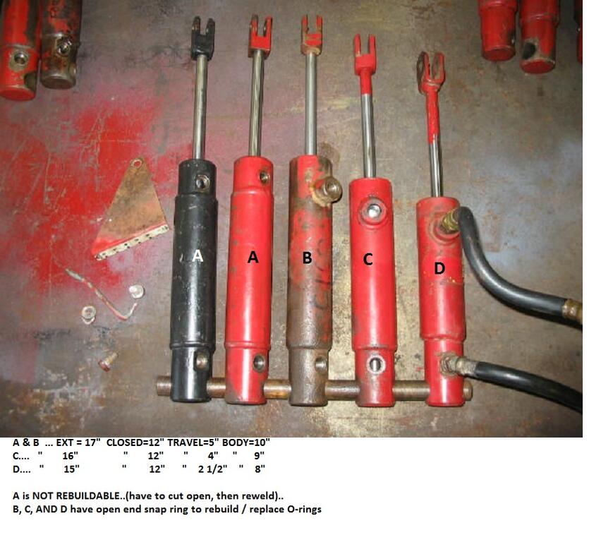

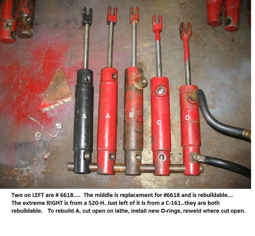

daveoman1966 3,884 #3 Posted September 24, 2021 (edited) This MAY help... Edited September 24, 2021 by daveoman1966 3 Share this post Link to post Share on other sites
Brockport Bill 2,428 #4 Posted September 24, 2021 yikes - thanks for the time and effort to send along - that's amazing info --- lots of variations - I wonder what the difference is internally on the cylinders you show --- If you look at the two photos I display, the 520 HC has that spacer? Coincidentally, my cyl from the 520HC is 8 3/4 inches, with an internal spacer of 3/4 inch, and the 416H cyl is 8 inches with no spacer - thus, minus the 3/4 inch spacer they are "equal". Share this post Link to post Share on other sites
