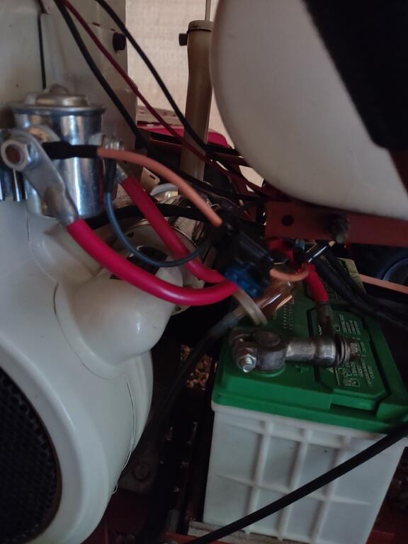

ebinmaine 77,821 #2 Posted September 22, 2021 A fuse in every circuit wouldn't be overkill. I too eliminate all ammeters from my tractors. The have a place in this world 🌍. Just not on my equipment. I wired my Cinnamon Horse C160 with 2 fuses. One is a maxi fuse for the battery. The other I believe I used a 20 or 25 amp ATC in the battery to ignition switch wire. I can get pics later today or tomorrow. Share this post Link to post Share on other sites

ebinmaine 77,821 #8 Posted September 23, 2021 On 9/22/2021 at 5:33 PM, squonk said: You can fuse anything. Just put a fuse in large enough to handle the maximum amount of current (starter draw) expected under normal conditions and matched to wire size and length of circuit. If you have a starter draw of say 60 amps a 80 A fuse will be sufficient. A 6 foot long #6 wire is rated at 100 amps https://jascoautomotive.com/automotive-wire-amperage-capacity-chart/ So if I want to leave the ammeter and fuse it... And it reads ((30A??))... Then I should be a fair amount more electrically safe if I install a 30 amp fuse in that wire.... That could be a possibility for Colossus in particular. @Bentoolong I have only one fuse in my C-160. It's the 867 that 2. The C160 fuse is in the wire from battery to ignition switch. It is 15 amp at this time. Share this post Link to post Share on other sites
