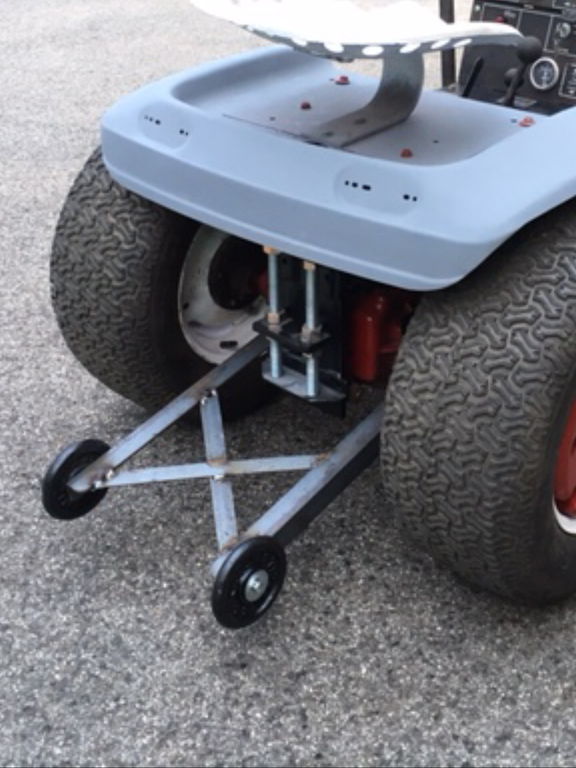

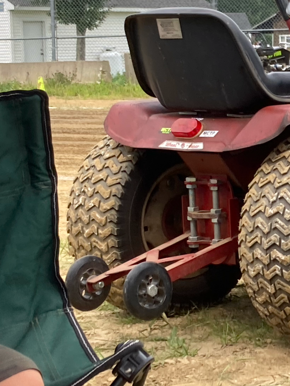

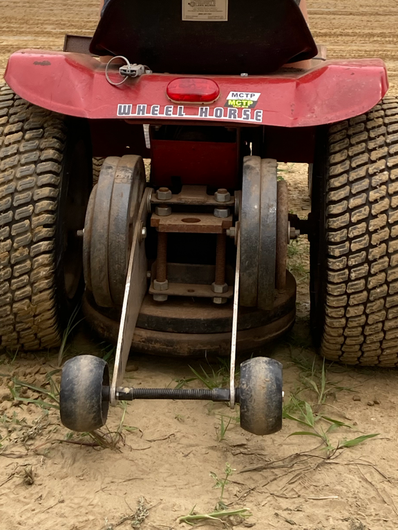

TonyToro 1,189 #28 Posted October 3, 2021 Here are a few different ideas for hitches and Wheelie bars. Our club is 5” off the ground max and 5” behind the rear portion of the wheel. Must be able to support the weight of the tractor. 1 Share this post Link to post Share on other sites
