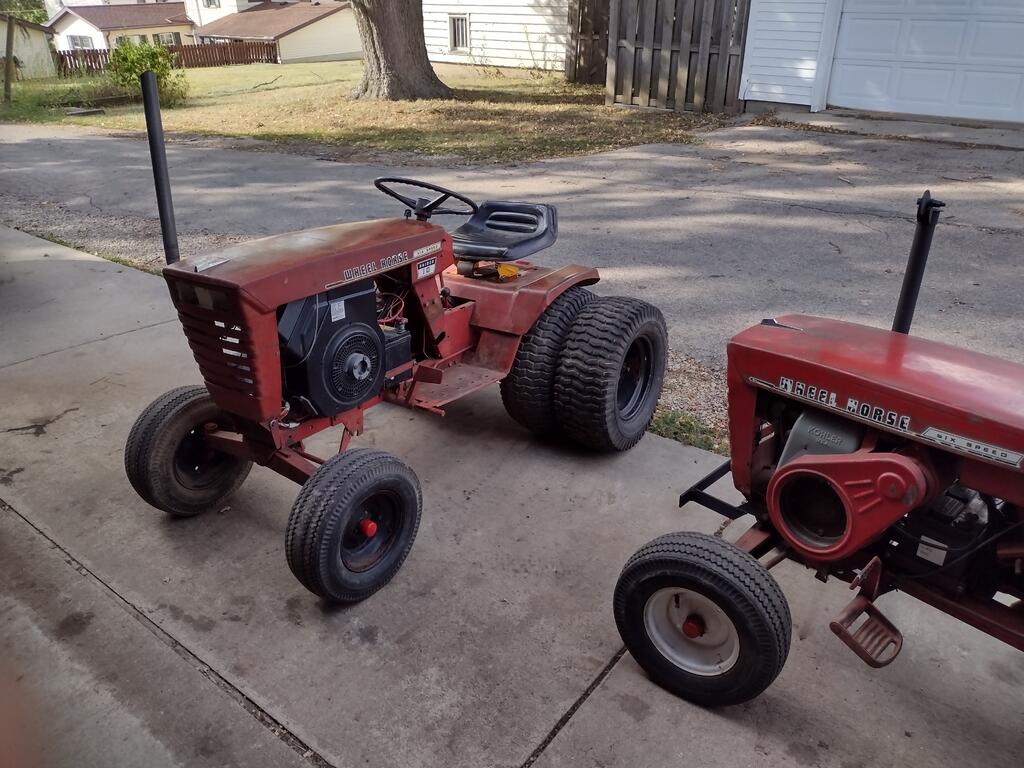

Sam Pasch 450 #1 Posted September 20, 2021 Hello all. I haven't been on the group for quite some time because my wheel horse hasn't had anything new or any trouble occuring. However I recently added a second horse to the garage. It is a raider 10 that has had a command swap and some pretty spectacular duals. I traded it off of my friend for my wrecked simplicity 7790 diesel. He built it about 3 years ago and it sat for 2. All it needed was the battery charge and it even ran on the 2 year old gas. I call it Home-brew because it been made from bits and pieces of various tractors. 5 4 Share this post Link to post Share on other sites

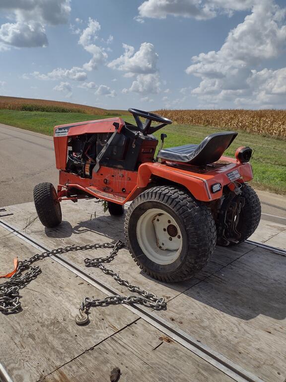

Sam Pasch 450 #2 Posted September 20, 2021 Here is the tractor I traded for. It sadly found its way off my trailer and into a ditch. 5 Share this post Link to post Share on other sites

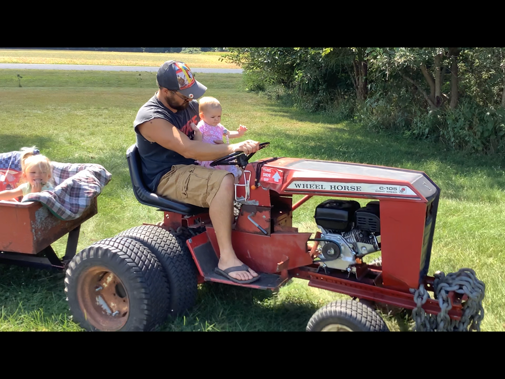

Pullstart 71,212 #3 Posted September 20, 2021 Welcome back! You don’t have to need a fix or have a problem to visit though you know…. Nice dually, and I like the name too! Here’s it’s younger dually cousin, The WHRat WHRecker. It had a Predator swap and frequently parades my nieces around. 1 4 Share this post Link to post Share on other sites

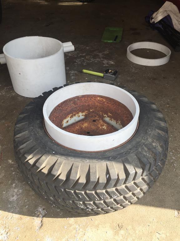

Sam Pasch 450 #4 Posted September 21, 2021 37 minutes ago, pullstart said: Welcome back! You don’t have to need a fix or have a problem to visit though you know…. Nice dually, and I like the name too! Here’s it’s younger dually cousin, The WHRat WHRecker. It had a Predator swap and frequently parades my nieces around. On your duals is there a spacer ring between the wheels? Mine doesn't have one and the tire tends to walk off center. Share this post Link to post Share on other sites
Pullstart 71,212 #5 Posted September 21, 2021 1 minute ago, Sam Pasch said: On your duals is there a spacer ring between the wheels? Mine doesn't have one and the tire tends to walk off center. Yes, @SylvanLakeWH put this one together. He used 12” PVC and I happen to have about 10’ of it left. 1 1 Share this post Link to post Share on other sites
Sam Pasch 450 #6 Posted September 21, 2021 1 minute ago, pullstart said: Yes, @SylvanLakeWH put this one together. He used 12” PVC and I happen to have about 10’ of it left. I haven't thought of that. Probably a lot cheaper that the 100 dollar spacer kits I've been seeing online 1 Share this post Link to post Share on other sites
oliver2-44 11,734 #7 Posted September 21, 2021 There’s also a drawing of how to make WH style square steel spacers in them”Drawings Section Share this post Link to post Share on other sites
Gregor 4,848 #8 Posted September 21, 2021 8 hours ago, Sam Pasch said: and some pretty spectacular duals. At the show this past weekend, I saw a GT with duals on the front. Don't quite get that,but to each his own I guess. Share this post Link to post Share on other sites
SylvanLakeWH 32,459 #9 Posted September 21, 2021 9 hours ago, pullstart said: Yes, @SylvanLakeWH put this one together. He used 12” PVC and I happen to have about 10’ of it left. A pic of build might help: 2 Share this post Link to post Share on other sites
