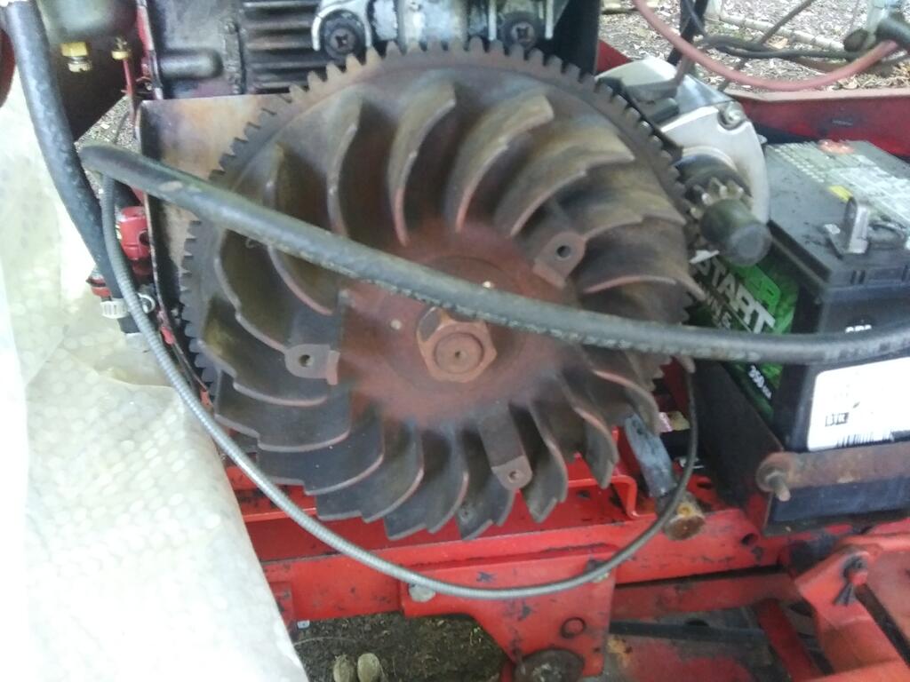

upstateyankee50 59 #11 Posted September 22, 2021 On 9/20/2021 at 3:53 AM, ebinmaine said: I'm not sure what to recommend from here. You've done what I'd know to do and then some. Next step to me would be to remove the flywheel and verify the key is good and flywheel is timed right. A manual would help you with that. At that point it would be in your best interest to verify spark timing using a bench test like @Gregor has done on his small block Tecumseh engines in the past. I am wondering about the wire coming from the engine having power and if that's appropriate. you questioned the small black wire that attaches to the unit ;my daughter snapped a few pictures of it today and at the left top you can see that wire that is attached ;my thoughts are it is a hot wire that sends power to the unit and using a test light and spinning the motor over lights up 'now if there is an adjustment on the unit as when the pins rotate and hit that might be the problem as well 'as with a 12 horse I had before with the breaker-less ignition system there was a way to adjust the pins as they rotated around and hit ; thought this one might be different ; 1 Share this post Link to post Share on other sites
ebinmaine 78,278 #12 Posted September 22, 2021 Manual may explain if or how to adjust gaps. 1 Share this post Link to post Share on other sites
Gregor 4,847 #13 Posted September 23, 2021 Once you have that nut off the flywheel, you may be able to see if the key way in the crank, at least lines up with the key way in the flywheel. You will still have to remove the flywheel to be sure the key isn't partially sheared. I don't think there is any adjustment to the pins per se. All you can adjust is the gap between the pins and the ignition module, which is what sets the timing, but don't quote me on any of this. 1 Share this post Link to post Share on other sites
