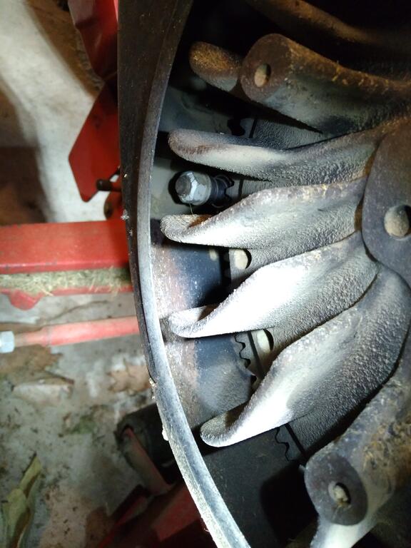

the jeep driver 29 #1 Posted September 19, 2021 Hello. I have a 1985 Wheel Horse 417A 31-17KE01. I'm having a few issues with it... First is starting it. When I turn the key, one of three things will happen; 1. cranks the engine over. 2. the starter activates (makes a whirring noise) but does not turn the engine over. My guess, I don't think the rod is pushing the pinion gear out to catch the flexplate. 3. something makes a loud grinding noise; my guess, maybe the rod is pushing the pinion out, but not far enough to catch the flexplate? Options 2 and 3 are occurring more and more often.... There is a cover over the end of the starter where it would make contact with the flexplate; I can't figure how to take the cover off to watch what is happening when I try to start it. I could pull the starter off and lube the pinion rod and put the starter back, but I thought I'd see what the Forum thinks I should do. Many thanks. Share this post Link to post Share on other sites

the jeep driver 29 #6 Posted September 20, 2021 It occurred to me this morning that I'd be able to see if the pinion gear (now I know it's the Bendix, thank you!) was engaging the flexplate if I took off the grass screen. I did so; I can see the end of the starter, and when I turn the key the starter does move the flywheel. Battery is now dead and junk, so I'm off to Interstate to buy a new one before work. I'll pull the starter and inspect it. @pacer, what am I looking for on the Bendix? Missing teeth? Share this post Link to post Share on other sites
