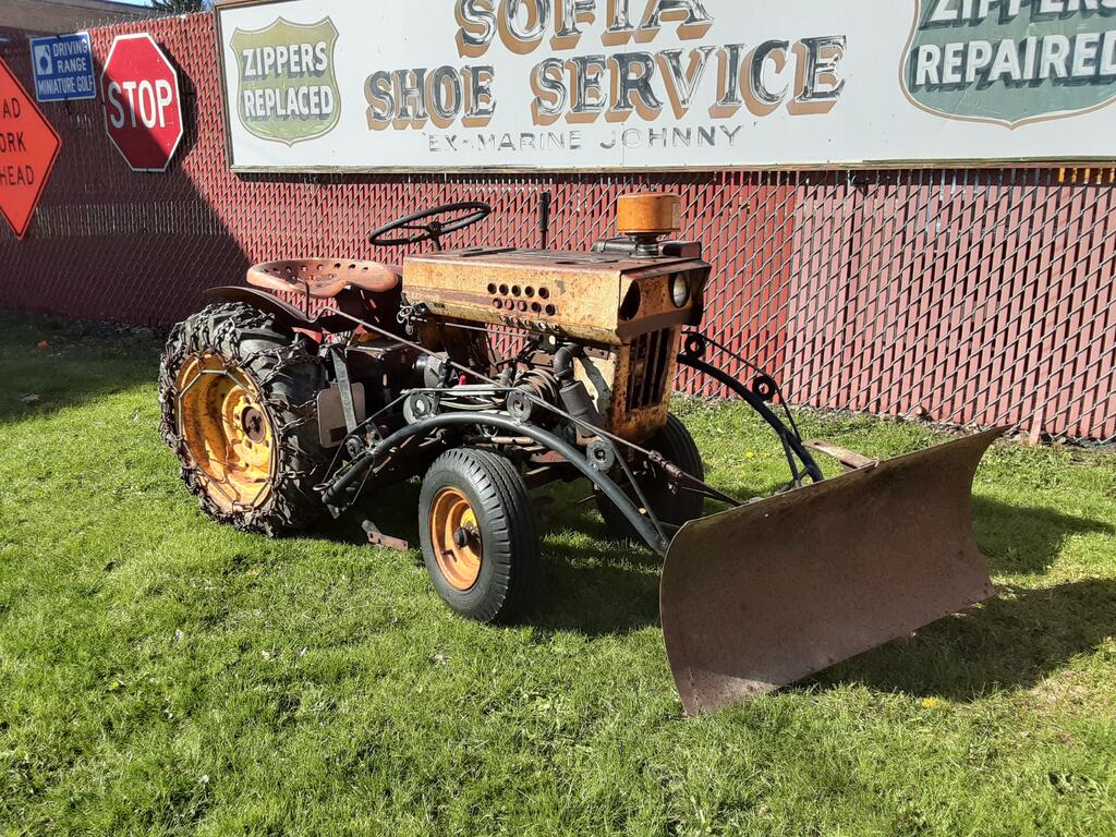

adsm08 4,155 #1 Posted September 18, 2021 (edited) So I picked up a new project today. I know almost nothing about this tractor, except that it is small, and red. Most of the ID tags are painted over, faded, damaged, or otherwise illegible. I have figured out it is a Speedex S-17, with optional electric start, and apparently a 2-speed transmission, and a plow. My boy likes tractors, likes to play with tractors, and has been asking me to teach him to paint, and he wants to drop a blade with me when the snow hits. He also is a few years yet from really growing into the 800 Special that he has claimed as his own, so when I saw this sitting along the road for $100, I figured I couldn't go too wrong. It's a mess now, but we are going to restore it together. Edited September 18, 2021 by adsm08 8 6 Share this post Link to post Share on other sites

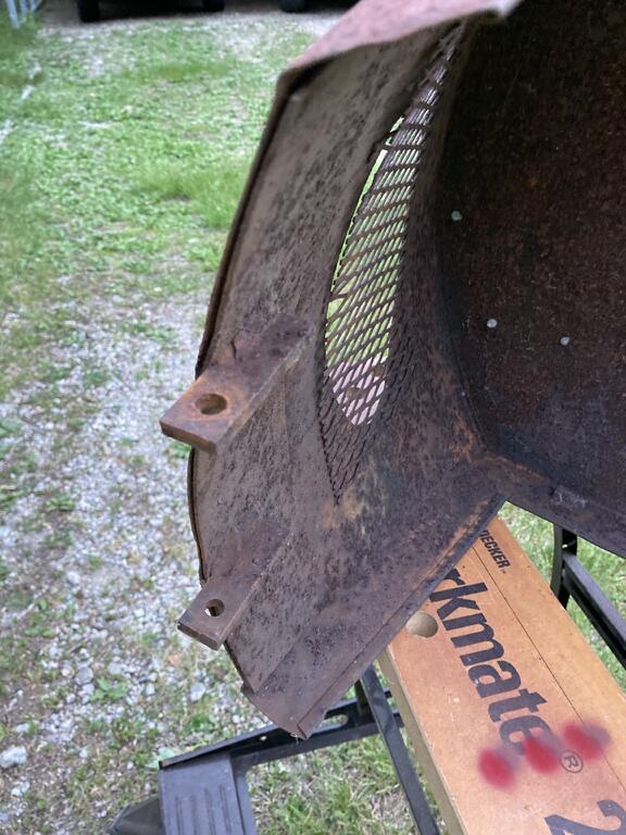

adsm08 4,155 #14 Posted May 20, 2022 Update and picture dump!!!!! Got the rusted, damaged grill replaced: Painted flywheel cover and hood: And a few other parts Steering: Other things: The engine, and cover, are currently at work, for things.... Like new exhaust flanges: I'm going to weld some pipe to it to attach a stack muffler like I have on the 855. The new coil showed up today, so I'm going to get that installed tomorrow when I get to work, and hopefully it will have spark. Once that's working making the engine run should be easy enough, just need to find an air filter. And a hinge pin for the hood. Looking at the pictures of when I brought it home I apparently never had the pins. 6 Share this post Link to post Share on other sites

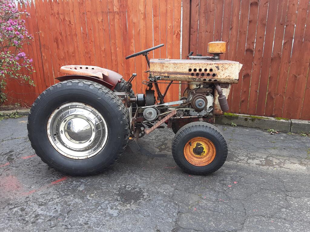

Blasterdad 3,163 #17 Posted May 20, 2022 2 hours ago, adsm08 said: Mine has an actual throttle that yours seems to not have, although I can believe that locking the engine forward would be troublesome. I Mine has a throttle cable in the same place as yours, it's just not on it, it was all bent up & rusted so I took it off, if you look real close at the pic you can see the two holes where it used to be. I found a running Briggs for it that's on it now, (same motor as original). I'm currently doing maintainance/restoring two decks at the moment, but when I'm done you've inspired me to dig her out & give her love, (I've had 2 new ag's in my shop for the front wheels for 4 years now, Lol). Keep up the good work! Looking good! 1 Share this post Link to post Share on other sites

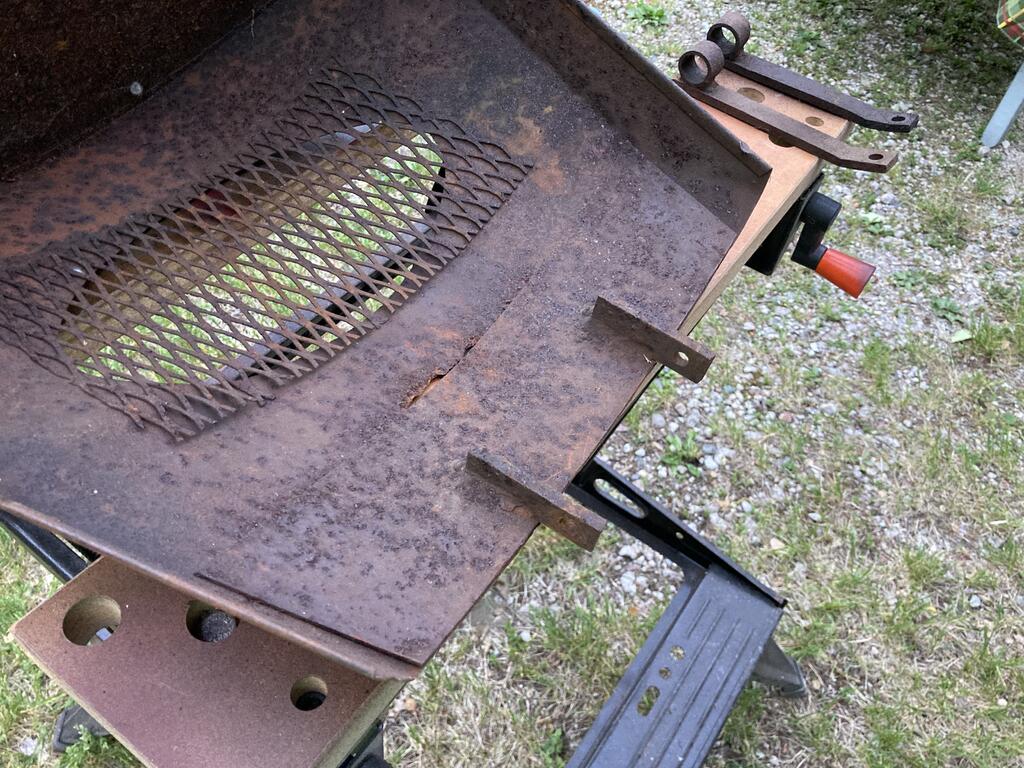

Blasterdad 3,163 #19 Posted May 21, 2022 Not much to it, just a piece of sheet metal with tabs welded to it, the two long brackets bolt to the front motor mount bolts. I'm guessing they had bushings in them at one point... I did find a killer Speedex site though, has all the manuals & exploded parts views for free, I'll see if I can post you the link... 1 Share this post Link to post Share on other sites

Blasterdad 3,163 #22 Posted May 21, 2022 Mine just had rubber bushings in them with a steel sleeve in them that rotted away long ago, even with new ones it's a bad design, I like your Idea, I was going to do something similar, those brackets move side to side too easily... My hood is pretty well shot, I've got a WH parts hood I was thinking about chopping down, It'll be a "SpeedHorse" Lol. 1 Share this post Link to post Share on other sites
