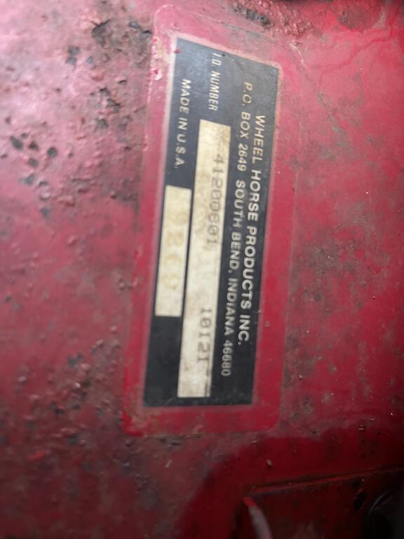

Bens vintage tractors 1,556 #35 Posted September 18, 2021 Figured someone may be interested in the serial number. Share this post Link to post Share on other sites

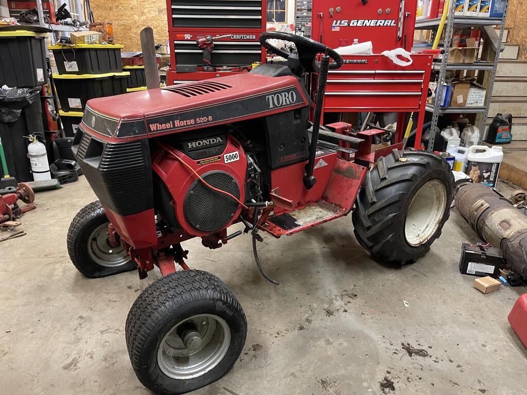

Bens vintage tractors 1,556 #41 Posted September 20, 2021 Engines sitting on the chassis. Getting ready to mount it tomorrow. 4 6 Share this post Link to post Share on other sites
ebinmaine 81,046 #42 Posted September 20, 2021 Looks right at home. Any fitment issues?? Share this post Link to post Share on other sites
Bens vintage tractors 1,556 #43 Posted September 20, 2021 1 hour ago, ebinmaine said: Looks right at home. Any fitment issues?? Nope gonna fit like a glove. I actually thought the Honda was much bigger than it is lol. 1 1 Share this post Link to post Share on other sites
rjg854 13,408 #44 Posted September 20, 2021 11 hours ago, ebinmaine said: Looks right at home. 4 Share this post Link to post Share on other sites
kpinnc 19,036 #45 Posted September 20, 2021 Looks great on there! I hope it works just as good as it looks! 1 Share this post Link to post Share on other sites
Handy Don 17,634 #46 Posted September 20, 2021 12 hours ago, Bens vintage tractors said: Engines sitting on the chassis. Getting ready to mount it tomorrow. Looking like an ideal re-power decision there. 1 Share this post Link to post Share on other sites
SylvanLakeWH 32,776 #47 Posted September 20, 2021 Looks great! 1 Share this post Link to post Share on other sites
WheelhorseBob 1,550 #48 Posted September 21, 2021 Have to admit it looks very nice! Can you get the gauges working? 1 Share this post Link to post Share on other sites
Sparky-(Admin) 26,621 #49 Posted September 21, 2021 What was the Honda originally mounted in or to? Was it a generator? Wondering what the 5000 decal references Share this post Link to post Share on other sites
