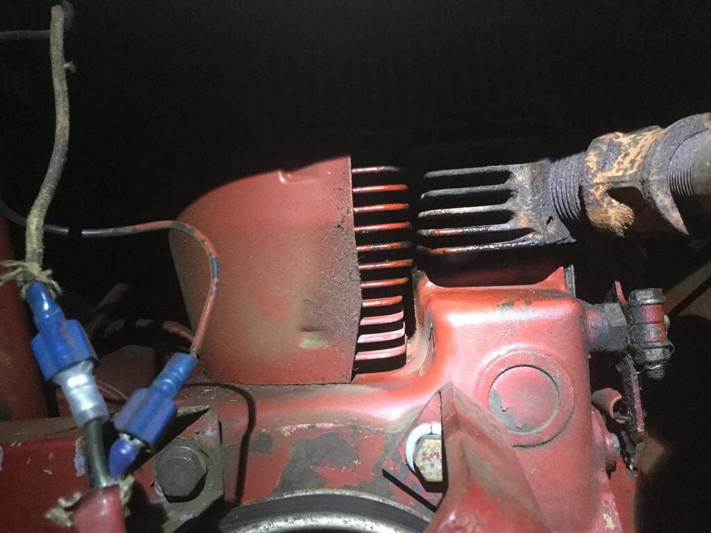

JimSraj 566 #1 Posted September 17, 2021 (edited) Noticed some oil on the cooling fins of the k321 on my GT14 today after finishing mowing. Nothing up around the head. It’s on the exhaust side as in the picture. Ideas? Edited September 17, 2021 by JimSraj Add photo. Share this post Link to post Share on other sites
Gregor 4,847 #2 Posted September 17, 2021 If you really want to know, I think I would pull some ti work. It may be coming from the bearing plate side, and the flywheel is blowing oil blowing through the fins. Not much else left, if there is nothing around the head. Share this post Link to post Share on other sites

953 nut 64,127 #4 Posted September 17, 2021 Take a look at the breather between the carb. and exhaust, oil accumulation from there could be picked up by the cooling fan. 1 Share this post Link to post Share on other sites
WHX?? 55,025 #5 Posted September 17, 2021 Bad seal on the flywheel side? Not likely to be the bearing plate gaskets they sell pretty well unless the plate it warped. Share this post Link to post Share on other sites
