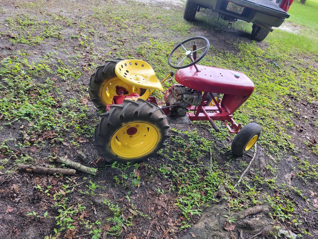

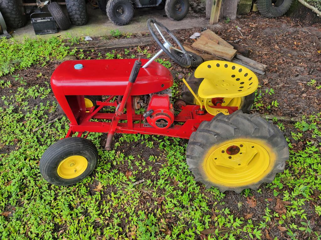

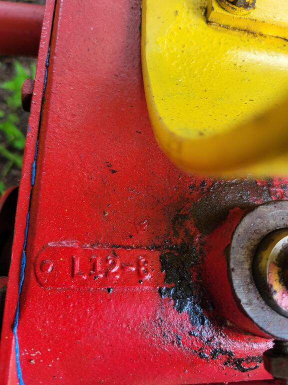

Rjmjr69 14 #1 Posted September 17, 2021 (edited) I recently purchased this cool little machine which is sorely not complete however I would love to bring her back to it's former glory. Problem from the start is I am unsure what model etc I actually have. I can only find one badge/stamp under the seat on the right side which is labeled L12-8. It has clearly been repainted and missing a good deal of components I will be researching and doing as much reading as possible. Can anyone point me in the right direction in procurement of parts such as the proper engine and a belly mower etc etc. Attached are pictures of the tractor. Thank you all and thank you for hosting such an informative site. Robert Edited September 17, 2021 by Rjmjr69 2 2 Share this post Link to post Share on other sites
AMC RULES 37,259 #2 Posted September 17, 2021 '58 Ride-Away Jr. 3 Share this post Link to post Share on other sites
8ntruck 9,289 #3 Posted September 17, 2021 to the forum. You have found a good place for information. Lots of good folks here willing to help and advise. Looks like one of the late 50's or early 60's RJ models. I am not an expert on these, but somebody who is will be along soon. Have fun with it. Share this post Link to post Share on other sites
kasey54 305 #4 Posted September 17, 2021 Nice little tractor.Probably had a K-91 Kohler power plant in it with that long exhaust pipe and heat shield originally. Share this post Link to post Share on other sites
Achto 32,633 #5 Posted September 17, 2021 Very sweet find for your first , or your 2nd or 3rd or 4th...... What you have is either a 1958 or 1959 RJ 58. Originally it would have had a 4hp Kohler K91 (most common) or possibly a Clinton 4hp. 1 Share this post Link to post Share on other sites

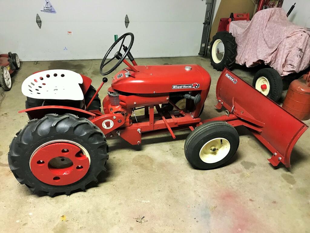

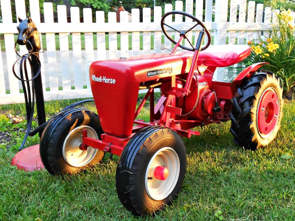

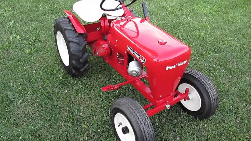

Achto 32,633 #7 Posted September 17, 2021 Here is a picture of one done up properly. 4 1 1 Share this post Link to post Share on other sites
kpinnc 18,939 #9 Posted September 17, 2021 49 minutes ago, Achto said: Here is a picture of one done up properly. One thing to note- rear fenders were not standard in 58 and 59. They were an option. So if you don't have them, it doesn't mean the tractor is not complete. 3 2 1 Share this post Link to post Share on other sites

953 nut 69,147 #12 Posted September 17, 2021 The RJ-58 was the first four wheel garden tractor to use a geared transmission. Yours looks great (with the exception of the yellow ) but that can be cured. Many people use engines other than the K-91 it was born with and that is fine. This is your tractor and as long as you are enjoying it that is the main thing. 3 2 1 Share this post Link to post Share on other sites
J854D 145 #13 Posted September 17, 2021 The L12-8 is the casting date code for the transmission case. It means that the trans case was cast on Nov. 12, 1958 which would lime up with it being a RJ58/59. That’s not to say the tranny could not have been swapped out sometime, but it appears to be from that time period. -JD- 13 hours ago, Rjmjr69 said: I recently purchased this cool little machine which is sorely not complete however I would love to bring her back to it's former glory. Problem from the start is I am unsure what model etc I actually have. I can only find one badge/stamp under the seat on the right side which is labeled L12-8. It has clearly been repainted and missing a good deal of components I will be researching and doing as much reading as possible. Can anyone point me in the right direction in procurement of parts such as the proper engine and a belly mower etc etc. Attached are pictures of the tractor. Thank you all and thank you for hosting such an informative site. Robert 1 1 Share this post Link to post Share on other sites

WHX?? 58,070 #22 Posted September 17, 2021 Sounds like the fellas have you covered so I'll just You did good tho a RJ is a rare find in your area. The one with the hubcaps is a '59. 4 1 Share this post Link to post Share on other sites
