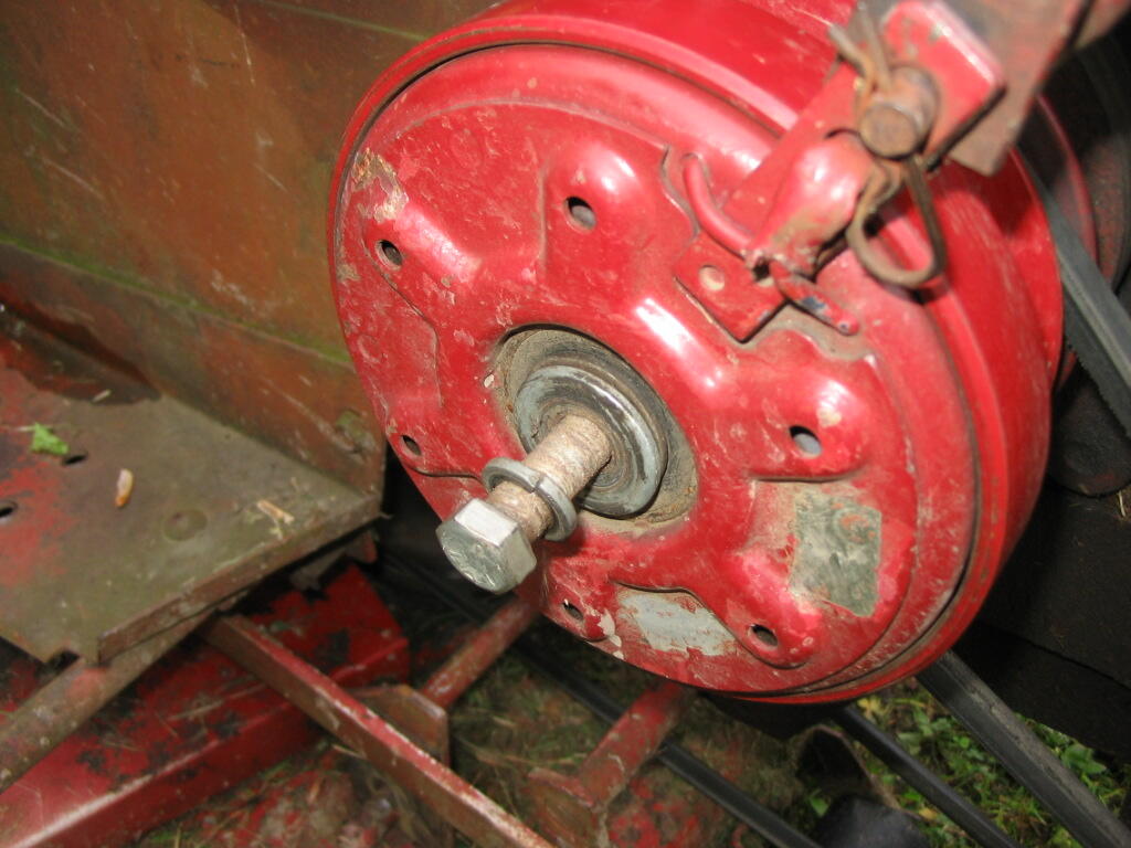

Wheelhorse#1 1,962 #1 Posted September 13, 2021 (edited) Hello all Can Anyone tell me how to remove the PTO clutch on a 73 12 automatic.Pulley puller I’m guessing ? Im going to try and go with a manual PTO as I don’t care for these electric clutches and cringe whenever I flip the switch 🥴 Looks like it’s keyed but can’t really tell. Here’s a pic of what I’m looking at ..thanks Edited September 14, 2021 by Wheelhorse#1 Share this post Link to post Share on other sites

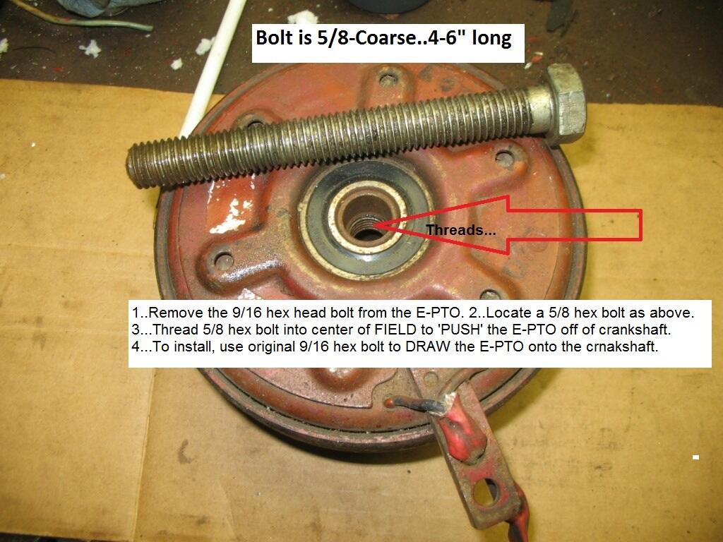

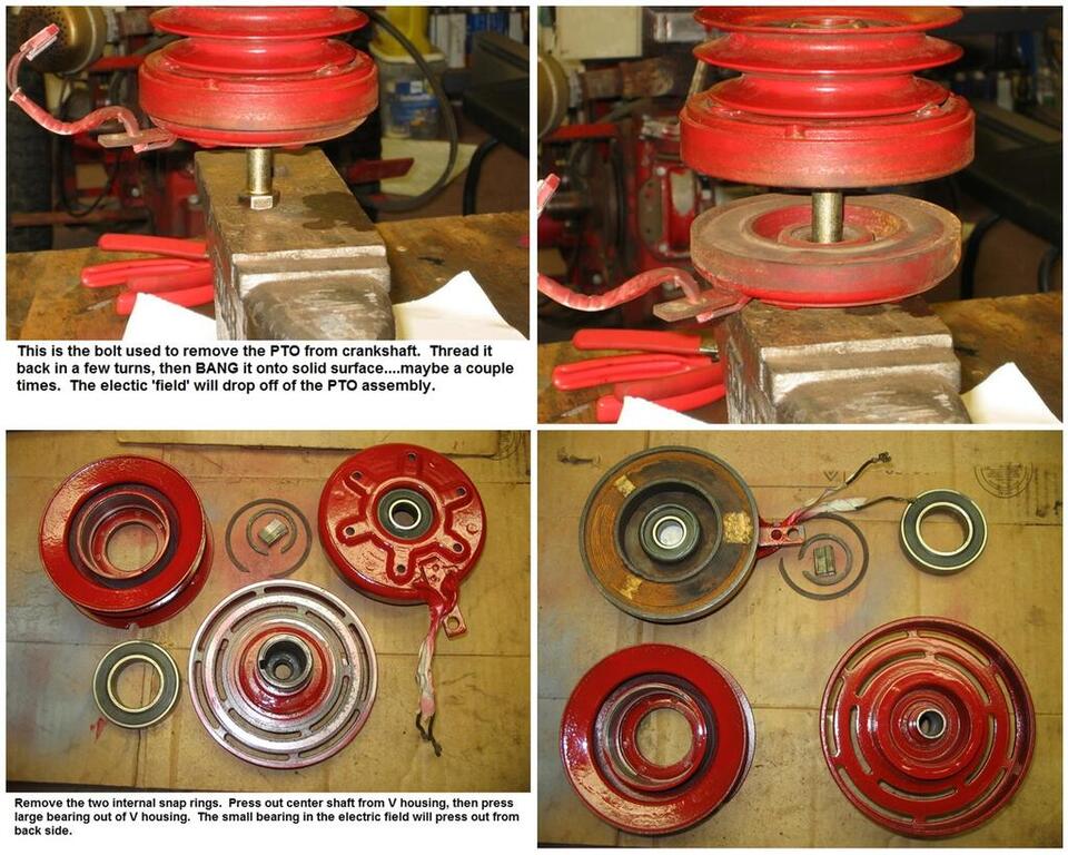

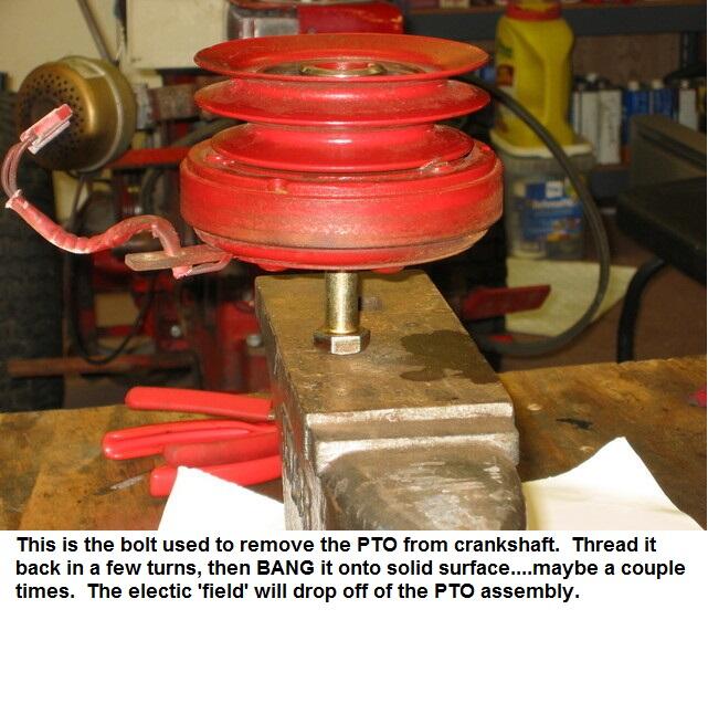

daveoman1966 3,884 #2 Posted September 14, 2021 (edited) Do NOT use any sort of 'puller' on that Electric PTO...you WILL ruin it. (1) remove the 9/16 center bolt. Then follow the directions in this pic... When you put it back on, use the oroginal 9/16 bolt to 'draw' it onto the crankshaft. If you need parts...I have some... Edited September 14, 2021 by daveoman1966 7 3 Share this post Link to post Share on other sites

Wheelhorse#1 1,962 #4 Posted September 14, 2021 10 hours ago, daveoman1966 said: Do NOT use any sort of 'puller' on that Electric PTO...you WILL ruin it. (1) remove the 9/16 center bolt. Then follow the directions in this pic... When you put it back on, use the oroginal 9/16 bolt to 'draw' it onto the crankshaft. If you need parts...I have some... Thank you Sir for this valuable information and the offer for parts. I’ll give This a shot later on this evening. Share this post Link to post Share on other sites
Wheelhorse#1 1,962 #5 Posted September 15, 2021 (edited) Worked like a charm.Didn’t have the right size bolt but had some all thread laying round. jammed a couple nuts on it and she slid right off ! I’ll try and take it apart after I get the motor rebuilt. Pulled the 301 off and pressure washed the rest.Had about 10lbs of grease on it. Edited September 15, 2021 by Wheelhorse#1 1 Share this post Link to post Share on other sites
