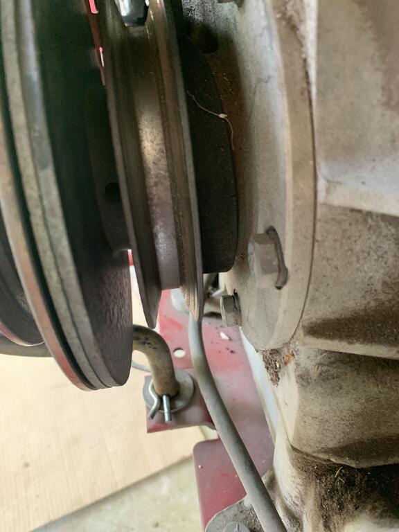

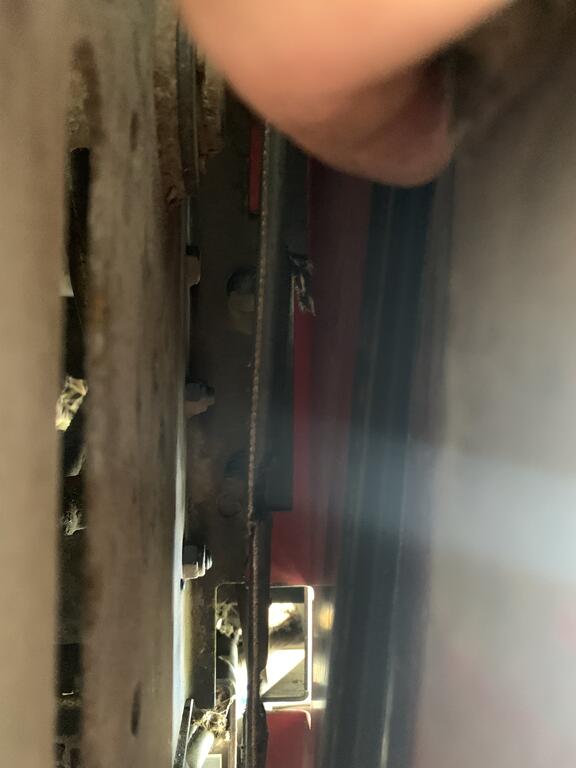

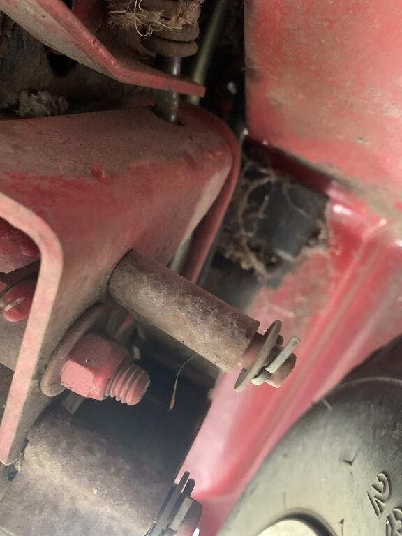

8ntruck 9,218 #9 Posted September 14, 2021 I've never worked on a 520H, so I am just expressing opinion now. The pictures look like brake linkage, which is usually on the right side of the tractor. The drive belt between the engine and transmission is on the left side of the tractor. It sounds like something has gone wrong in the lever, linkage, spring, or idler pulley that applies pressure to the drive belt for clutching action. You might want to remove the drive belt cover to see what is going on. Share this post Link to post Share on other sites
Skipper 1,792 #10 Posted September 14, 2021 (edited) Unless I got it all wrong, the drivebelt is on the right side. ? Always sit in the seat when you talk sides on a tractor, my granddad thought me Hope that still applies, or I have said a lot of BS for a long time now What we are looking at on the pics, is the brake linkage, up under the dames skirt ( fender pan ) left side. Taken from in front of rear wheel. Looks identical to what's on all the hydro trans tractors I have had apart, from c1x5's to 520's etc. Fender pan looks a lot like a classic type, so 520 may be a good bet. Off with the drive belt cover (other side than pictures are from), and lets see what's going on. Should be a simple fix. My bet is also on a belt issue on the drive belt. The one that runs from engine to transmission. That explains all your problems. Cover is the side panel, next to your right leg, and it comes off with a few screws and bolts. 2 on top, next to you right leg, one in the middle down low on the cover, next to your foot, and one on top up close to the engine, and one on the under sider of the cover, in front of your foot. Edited September 14, 2021 by Skipper 1 Share this post Link to post Share on other sites

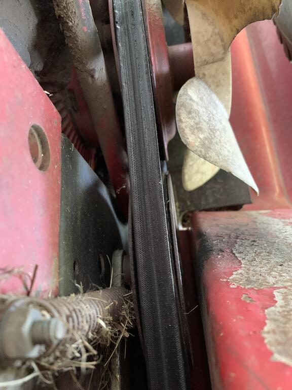

lynnmor 9,013 #18 Posted September 19, 2021 Remove the right rear tire and the vertical panel above the right floor board. You can then inspect the idler pulley and spring, plus do some cleaning. Download the owners manual and parts manual from the manuals section of this website. Share this post Link to post Share on other sites
DaBears1 1 #19 Posted September 19, 2021 Have removed the side panel air hosed all the debris out, idler pulley, spring and fan all are in good working order. Some rust but everything spinning without the wobbles Share this post Link to post Share on other sites
DaBears1 1 #20 Posted September 19, 2021 Spring also rust, but seems to have good tension as I had to really push on it to get the belt loose Share this post Link to post Share on other sites
