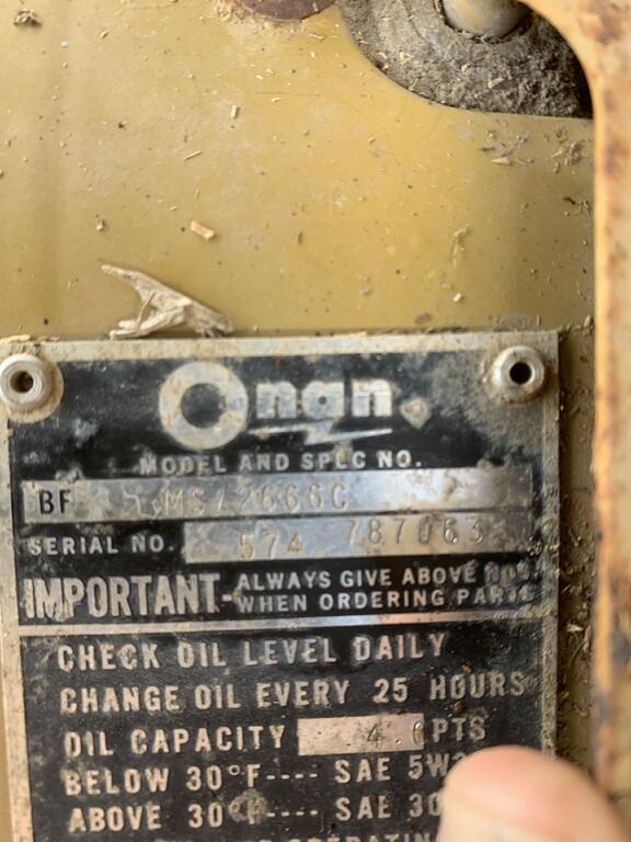

Jds 1 #1 Posted September 12, 2021 (edited) I’m looking for a rebuild kit for a onan engine hopefully someone can point me in a good direction. This was my granddaddy’s old garden tractor and I’m looking to restore it. It runs one one cylinder at present. Im not sure if the year has granny accidentally threw out the manuals to garden tractor. It a Sears SS/16 model# BF MS/2666C serial# 574 787063. Edited September 12, 2021 by Jds 1 Share this post Link to post Share on other sites

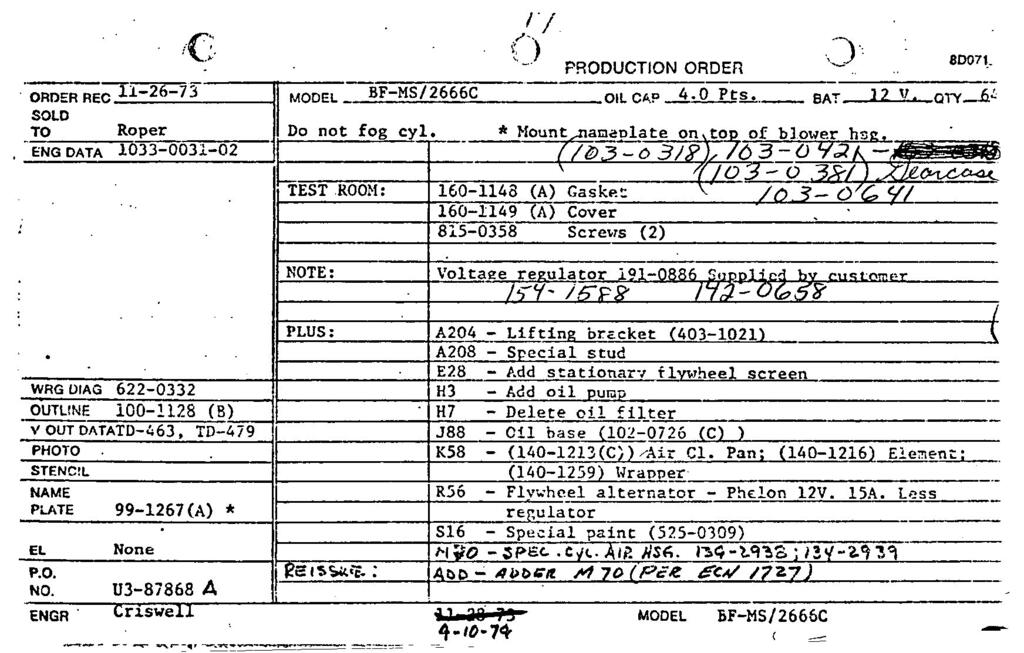

onanparts.com 185 #6 Posted September 19, 2021 Hi and welcome to Red Square! Your Onan was shipped to Roper/Sears in May 1974. Start with a compression check and go from there. Service manual: Onan Production Order. 1 Share this post Link to post Share on other sites
