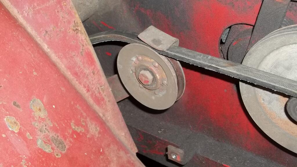

dcrage 631 #2 Posted September 10, 2021 Sounds like you do NOT have your belt guard on. Guard must be in place with the proper belt routing to get the belt to stop moving when the clutch is disengaged. 2 1 Share this post Link to post Share on other sites
gwest_ca-(File Mod) 11,785 #3 Posted September 10, 2021 Welcome to Red Square. What model of tractor do you have? The belt guard must be installed to support the belt for clutch operation. Garry 1 Share this post Link to post Share on other sites

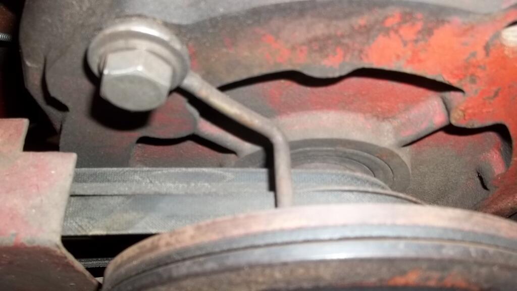

953 nut 62,630 #4 Posted September 10, 2021 When you depress the clutch the lower rail of the belt guard must catch the slack of the belt. Also There are guides at the engine pulley and idler that need to be in place. 3 1 Share this post Link to post Share on other sites

Ed Kennell 43,387 #7 Posted September 11, 2021 to the You came to the right place. The lower flange on the belt guard supports the slack belt. This support along with the belt guides on the idler pulley and the engine pulley prevent the belt from contacting the engine pulley and stops the belt from moving. 1 Share this post Link to post Share on other sites

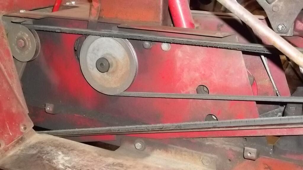

edgro 680 #8 Posted September 12, 2021 Why is there two belts on the tractor in the picture? I have not seen that before Share this post Link to post Share on other sites
953 nut 62,630 #9 Posted September 12, 2021 16 minutes ago, edgro said: Why is there two belts on the tractor in the picture? I have not seen that before The picture is f a 953 and the shorter belt runs the hydraulic pump for the lift. Share this post Link to post Share on other sites
