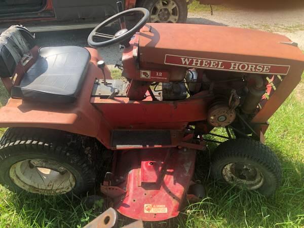

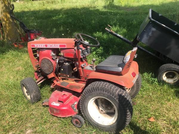

Rhett26 2 #1 Posted September 10, 2021 Hi looking at this tractor for winter project. Did Bolens 1000 last winter and enjoyed journey. like this due to hydro. Does not run. Wants 300 which is too much for not running. Looking to see if it looks complete and correct. Thanks 1 Share this post Link to post Share on other sites
953 nut 69,148 #2 Posted September 10, 2021 That appears to be a 1973 12 HP "No-Name". In '73 the line didn't give names like "Bronco" or C-120 to any of their tractors. Being an automatic it is a shot in the dark as far as the transmission goes, I'd tell the seller $ 100 as is or $ 300 if you can test drive it. 4 Share this post Link to post Share on other sites
pfrederi 21,145 #3 Posted September 10, 2021 42 minutes ago, 953 nut said: That appears to be a 1973 12 HP "No-Name". In '73 the line didn't give names like "Bronco" or C-120 to any of their tractors. Being an automatic it is a shot in the dark as far as the transmission goes, I'd tell the seller $ 100 as is or $ 300 if you can test drive it. Share this post Link to post Share on other sites
ebinmaine 80,642 #4 Posted September 10, 2021 1 hour ago, 953 nut said: That appears to be a 1973 12 HP "No-Name". In '73 the line didn't give names like "Bronco" or C-120 to any of their tractors. Being an automatic it is a shot in the dark as far as the transmission goes, I'd tell the seller $ 100 as is or $ 300 if you can test drive it. 29 minutes ago, pfrederi said: I'll "third" that. If you can't prove the engine and transmission are any good you have to assume that's a parts ONLY rig. 1 Share this post Link to post Share on other sites
ohiofarmer 3,475 #5 Posted September 13, 2021 As I look at that tractor and how straight it is, no body parts missing, and looks like nobody has touched it, I would buy it if I wanted a project. It looks to have been stored inside,so a tractor that just mows lawns is nearly 100% good transmission. Take your own battery and see if the engine turns over. If not, put a jumper wire to the coil, negative to ground, and jump the starter with a bit of carb cleaner [the good stuff which is mostly lacquer thinner] and it should bark off. Tractors are higher this fall simply because there is a shortage of new ones. I would try for $200. If that tractor listing is a few weeks old, then maybe you will get it for that. If you make it run or even fire a bit, that's enough for even 250 or three hundred. If my own requirements were for running tractors or non running for 100, I would only have one tractor and would have missed out on a very nice C-160. Buy the thing and i will stop by and help you out on my way to Ann Arbor to help you out and give you some hints on easy fixes Share this post Link to post Share on other sites
