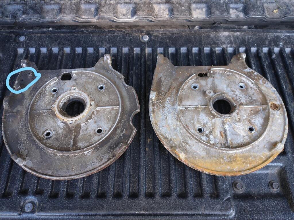

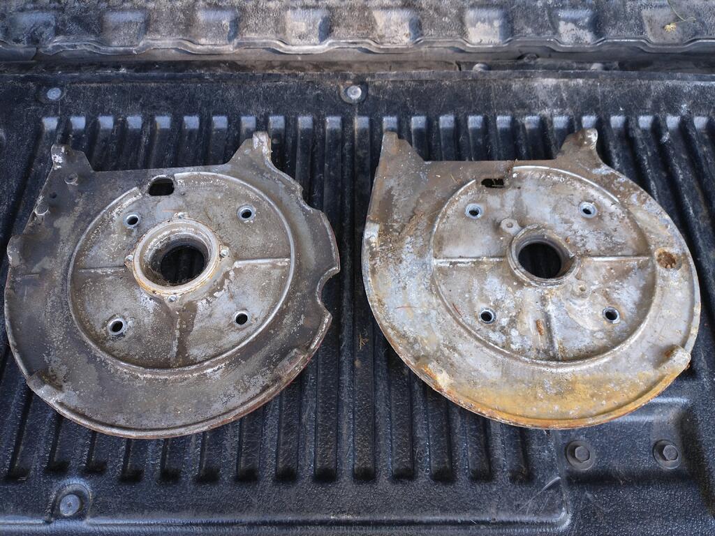

squonk 47,421 #8 Posted September 10, 2021 (edited) These are the 2 I have. I think the one on the right was off of an older K301. Has the rear timing hole. The other is off of a K341. Has the 4 holes for the stator. Physically they are the same size. If you need either of these you can have them CHEEP! Edited September 10, 2021 by squonk Share this post Link to post Share on other sites
pfrederi 20,885 #9 Posted September 10, 2021 If the recipient engine is a breakerless looks like he would need the one on the left. Share this post Link to post Share on other sites
squonk 47,421 #10 Posted September 10, 2021 Plate on my rebuilt K321 pretty much identical to the one on the left. Share this post Link to post Share on other sites
pfrederi 20,885 #11 Posted September 10, 2021 Breakerless trigger needs the mounting points. (Would have to be drilled and tapped.) Share this post Link to post Share on other sites
Shuboxlover 488 #12 Posted September 10, 2021 Both of the engines (donor and recipient) have points. Thanks 1 Share this post Link to post Share on other sites
