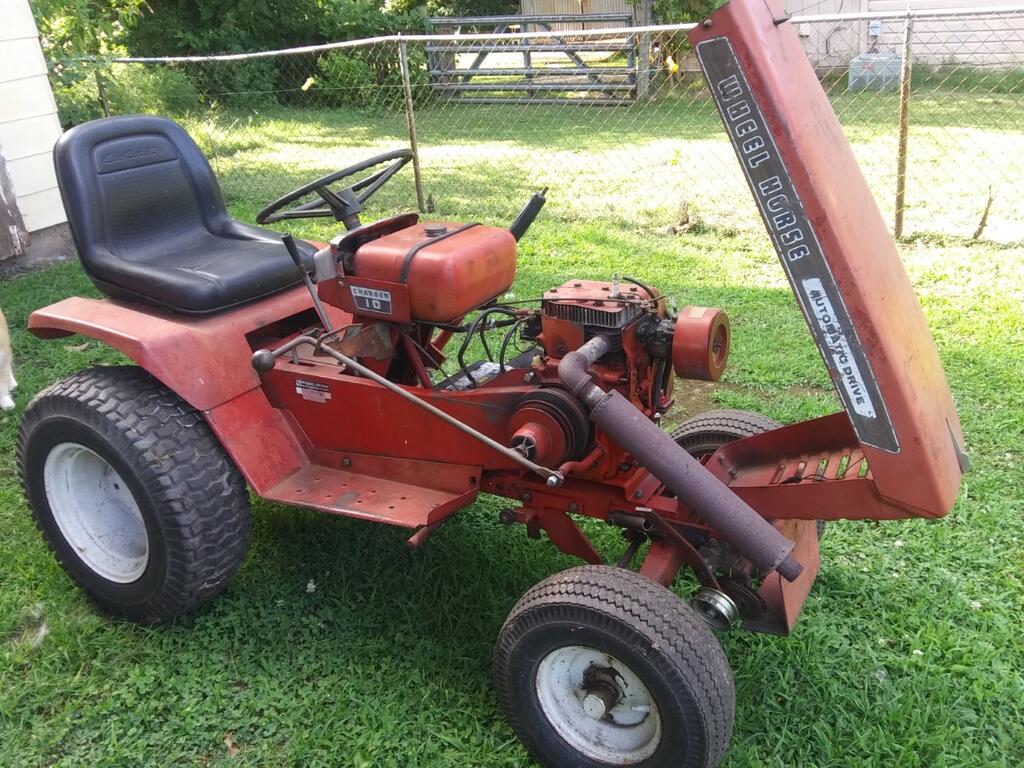

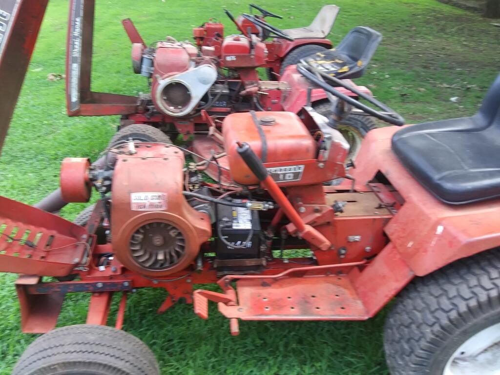

ebinmaine 79,734 #2 Posted September 8, 2021 Can you post some pics of the tractor, engine, and carb so we can see what we're up against? I'm thinking you'll be in need of a carb rebuild to start. 1 Share this post Link to post Share on other sites

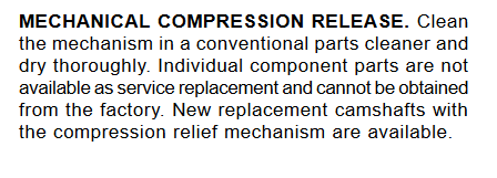

Gregor 4,848 #4 Posted September 9, 2021 (edited) 10 hours ago, upstateyankee50 said: I let the motor creep its way up the steep incline I don't quite get this. Did the motor start? Are we in fact dealing with a Tecumseh 10 HP? I don't know if the HH100 has Automatic Compression Release or not, but did you check for any compression at all? Pull the plug, and hold your thumb over the hole while cranking. Any compression? I guess that answers that. Edited September 9, 2021 by Gregor 2 Share this post Link to post Share on other sites

upstateyankee50 59 #9 Posted September 9, 2021 19 hours ago, ebinmaine said: Can you post some pics of the tractor, engine, and carb so we can see what we're up against? I'm thinking you'll be in need of a carb rebuild to start. i did have the carb rebuilt but I am not sure if the shop did put a new kit in to it; I did buy a brand new carb for it from a dealer here and he said it is the correct one for this motor ;well after installing that one the tractor still wouldn't start even when primed ;so that is when I decided to have a repair shop rebuild the one that came on the motor ; lME-29 Share this post Link to post Share on other sites
