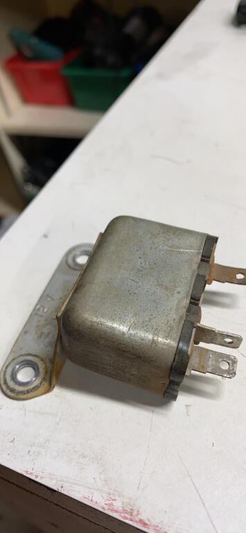

Tbloss98 0 #1 Posted September 7, 2021 Need a new relay for my mower, can find any part number or any relay that would work as a replacement, if anyone knows the part number please let me know Share this post Link to post Share on other sites
Handy Don 16,601 #2 Posted September 7, 2021 Welcome to the Forum. Please add some more info: Model and Serial number of your machine and a picture of where this relay was being used, please? Share this post Link to post Share on other sites
stevasaurus 23,689 #4 Posted September 7, 2021 Your profile shows 314-8 as favorite...is this what you have?? 1 Share this post Link to post Share on other sites
WHX?? 56,594 #5 Posted September 7, 2021 Yes a little more info on the mower please. It's not a relay I recognize in a horse. Share this post Link to post Share on other sites
Snoopy11 5,731 #6 Posted September 7, 2021 Odd how similar that looks to a rectifier or some type of resistor... but depending on what the relay is for, potentially maybe headlights... not sure... there are universal ones you can buy that will work fine... unless you are wanting to keep a 100% stock horse... Don Share this post Link to post Share on other sites
gwest_ca-(File Mod) 12,234 #7 Posted September 8, 2021 The first low oil relays looked like that but don't recall one ever failing. If this what it is there are special instructions to remove and service the low oil switch without damaging it. This relay was also used as a kill relay on the earlier Cxx5 models that used magneto ignition with a battery type of ignition switch. 1 Share this post Link to post Share on other sites
