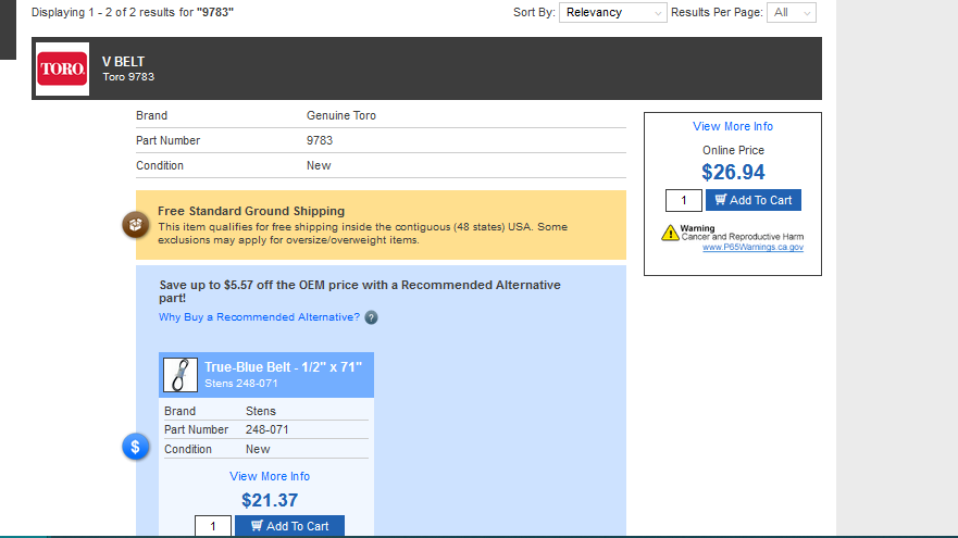

JimSraj 585 #1 Posted September 7, 2021 I’d like to hear from some of you about what you think is the best type of belt to use for pto to mower deck double center spindle on a 1969 GT14. Share this post Link to post Share on other sites

JimSraj 585 #5 Posted September 8, 2021 (edited) Thanks One and all. I’m going to check out all the suggestions. There’s a tractor Supply and an Advance Auto nearby. Between them I should be able to get belted. Lincoln, at A-Z Tractor has the Stens belts and I am probably going there for a set of double D blades this week. Edited September 8, 2021 by JimSraj Share this post Link to post Share on other sites
