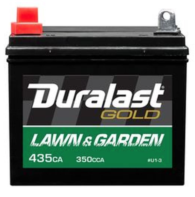

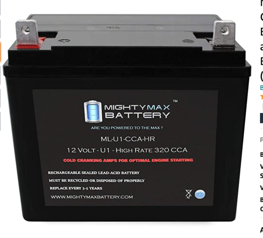

pfrederi 20,869 #26 Posted September 10, 2021 U1 L&G batteries come in U1L and U1R. You want the U1L (determines which side the positive terminal is on.) The U1L should work on your Electro with out having to move any wires. (assuming some previous owner didn't change something.) Share this post Link to post Share on other sites

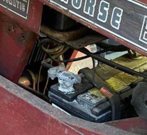

gregorpb 4 #27 Posted September 10, 2021 Glad I asked! Looking at the U1L batteries, it still looks like their terminals are nut and bolt connectors. In the pics I have of the Electro, the terminals look like standard car post battery terminals (see attached). Guess I'll find out when I pick it up, but I'm hoping to have a battery with me. Share this post Link to post Share on other sites
pfrederi 20,869 #28 Posted September 10, 2021 Electros originally came with Grp22NF batteries. The had top terminals and used clamps as in your picture. You could use a modern Group 22 NF battery but they are pretty pricey. Until you are sure the tractor will be useable I would go with an Group U1L battery. You will have to put some shims in the battery box (or get a newer small batter box designed for L&G batteries). While not pretty and not a long term solution you can put a 1/4" bolt through the clamp and the battery terminal. To test out your new machine. (just make sure the Positive clamp/terminal are not touching anything) Also leave the negative terminal disconnected until the last step of hooking things up. Share this post Link to post Share on other sites
