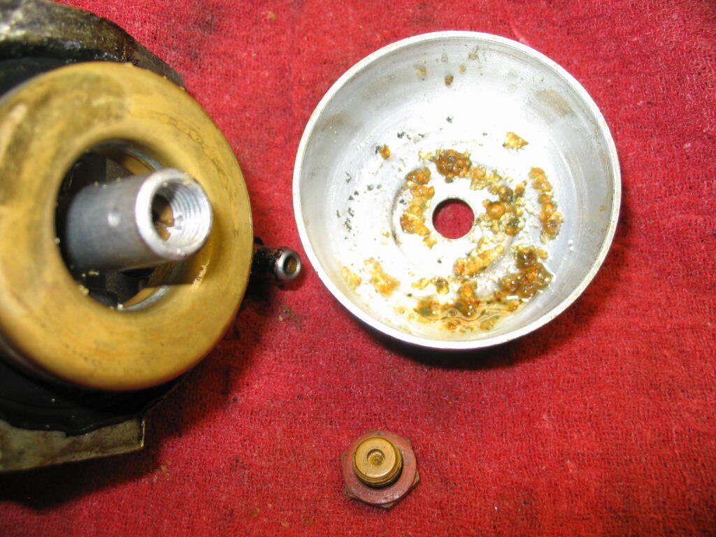

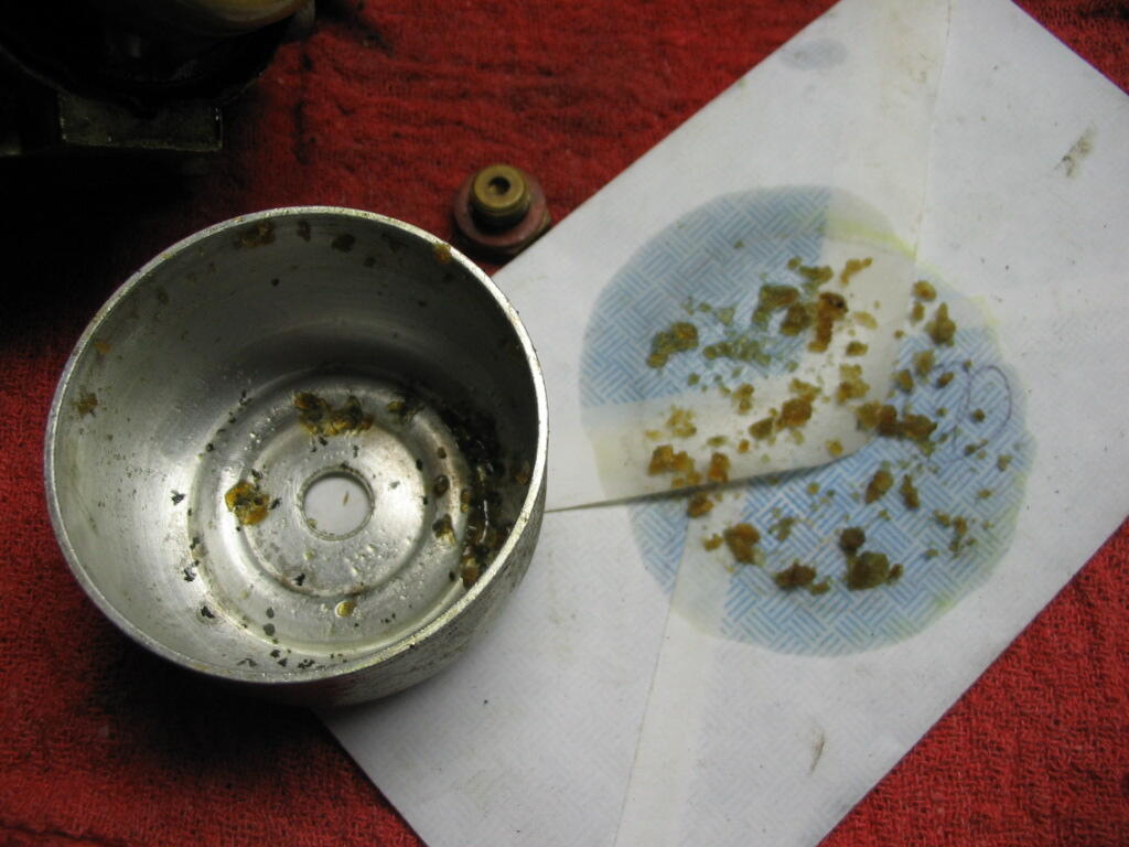

daveoman1966 3,884 #11 Posted September 7, 2021 The Electro 12 was made in 1968-69-70. The K321 (12hp) Kohler was made to run on REAL GAS...not the ethanol mix **** that is at most filling stations today. Look for ETHANOL FREE gas and use ONLY that gas. To find an outlet station, just google ETHANOL FREE GAS in your ZIP CODE...there'll be locations. ps...here is what regular gas looks like in your carb bowl...after about a month or so. Share this post Link to post Share on other sites

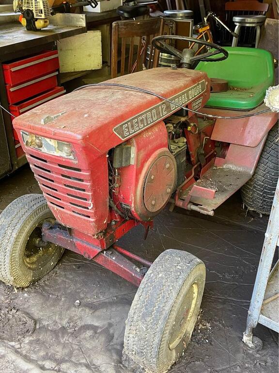

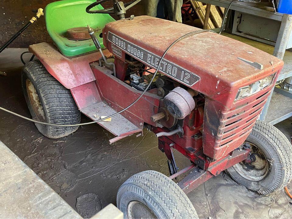

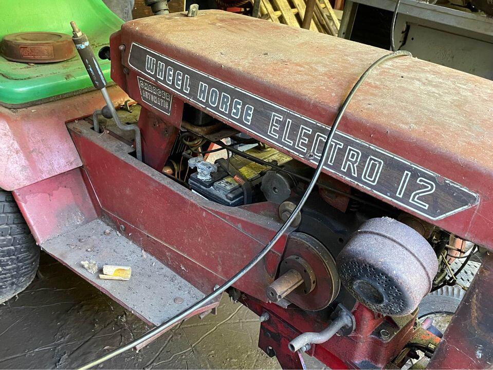

gregorpb 4 #13 Posted September 8, 2021 Hey all! Thanks so much for the welcome and the info to start. I haven't picked the tractor up yet, but here are the few photos I have so more. Will pick the horse up next week and will post more pics. 1 Share this post Link to post Share on other sites
oliver2-44 11,628 #14 Posted September 8, 2021 O....my eyes, my eyes Be kind to that poor mistreated horse and cover up that Green seat with some black VHT Vinyl Dye. ok, I know you don’t even have it home yet 1 Share this post Link to post Share on other sites

Skipper 1,792 #16 Posted September 8, 2021 (edited) Congrats. It can become a really good tractor! A few things I noticed: See if PO has the PTO clutch parts laying around. As it sits there, there is no PTO on the engine, and you will not be able to use any powered tools before that's sorted. Also, if a deck (or other attachments) for it is sitting around in the shed, that might be a good thing to get too. In that case, get all the mounting gear for that also. Seems the air filter cover is on the seat. You might in general want to check that you get all parts to put it back together again. On the gas and ethanol. Yes ethanol is a bad thing for these old machines, but there are ways to get around it. There's stabilizers you can mix in the fuel, and just a dash of good 2 stroke oil will do the trick too. Not a big issue if handled. It's if you don't do anything, it becomes a problem. That muffler that's on it, can be a bit loud, and you could find a used (or new repop) of the Nielson type to put on it. It will be a much more enjoyable ride. If you want to get another seat for it, the best available match IMO, is the low back michigan seat that's on it.......in black! Last peace of advice. Check the engine and trans oil before you try to crank it. If it's there and looks like oil, then fine. If not................. And then when you have it running, change the oil + filter on trans if there is one. (don't remember on that model) It can be a really good little machine, with some $$ and some TLC. Just my Edited September 8, 2021 by Skipper Share this post Link to post Share on other sites
Handy Don 16,944 #17 Posted September 8, 2021 6 hours ago, Skipper said: Seems the air filter cover is on the seat If the carb has been left open in a barn setting, there's a good chance critters have made a home in there. But more concerning to me is that it looks like that machine has been in a flood. The muddied floor and the water marks on the tires are the tipoff. Caution advised. Share this post Link to post Share on other sites

ohiofarmer 3,442 #21 Posted September 9, 2021 on the fron of the engine in the first picture...... Is that electronic ignigtion and not a coil? Just curious. Share this post Link to post Share on other sites
pfrederi 20,869 #22 Posted September 9, 2021 Triangular shaped object is the coil for a breakerless ignition system. They work really well no timing issues no points to worry about....but if a trigger fails replacements are very hard to find and pricey...Also like any self energizing ignition it will be destroyed if you apply voltage to the M wire... 1 Share this post Link to post Share on other sites

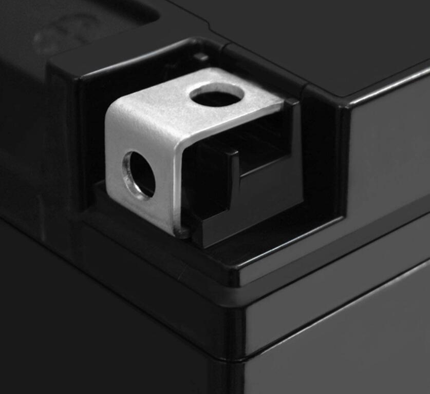

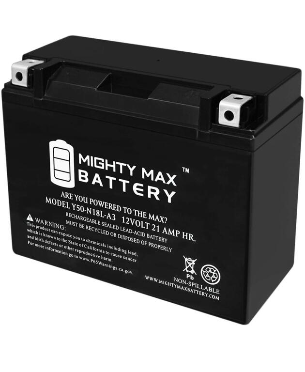

gregorpb 4 #23 Posted September 10, 2021 dumb question - from the pictures, it looks like I'm going to have to change the battery leads to accommodate this battery. What size nut and bolt leads should I be getting? Electricity is not my thing Share this post Link to post Share on other sites
pfrederi 20,869 #24 Posted September 10, 2021 (edited) That is a motor cycle battery. Will be be too small for your battery box. You should just get an L&G tractor battery from just about any auto parts store Wally World Edited September 10, 2021 by pfrederi Share this post Link to post Share on other sites
Handy Don 16,944 #25 Posted September 10, 2021 7 minutes ago, pfrederi said: That is a motor cycle battery. Will be be too small for your battery box. You should just get an L&G tractor battery from just about any auto parts store Wally World If you'll be starting often in very cold weather, you might consider going from 275 to a higher CCA (cold cranking amps), maybe 330. Share this post Link to post Share on other sites
