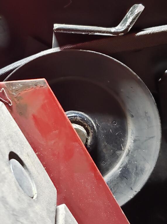

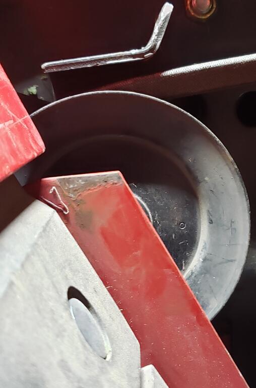

Jsieao 10 #9 Posted September 8, 2021 Ok, so no movement on the hubs or drive pulley. Looking at the tensioner pulley, there seems to be some play there. The first photo shows the position of the pulley after normal clutch pedal operation. The second photo is after I manually pulled the pulley backwards. How do I adjust that travel for the pulley? The trunion on the other side only adjusts the pedal travel, correct? Share this post Link to post Share on other sites
gwest_ca-(File Mod) 10,499 #10 Posted September 8, 2021 The trunnion only adjusts the pedal position for operator comfort. Better check the lever the trunnion connects to. It is connected to the cross shaft with a roll pin that may have sheared allowing the lever to rotate on the shaft. 12 is the lever 13 is the pin https://www.partstree.com/models/73429-312-8-toro-garden-tractor-sn-200000001-200999999-2000/clutch-system-assembly-8/ 1 Share this post Link to post Share on other sites
Jsieao 10 #11 Posted September 9, 2021 Thanks again for the helpful advice. The pin was indeed sheared. I was unable to find a spring coil pin at any of the local hardware stores so I ordered a package of them that will hopefully show up before too long. I have something serving the purpose for the time being so I can get some grass cut. This apparently had been the case since I got it over a year ago, as the clutch pedal is now in a more favorable position. I probably should have hung onto that drive belt that I just changed out, as that wasn't the problem at all!! 3 Share this post Link to post Share on other sites
