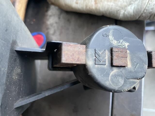

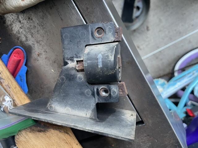

AHS 1,701 #1 Posted September 7, 2021 Ok, is it the same coil for M10, M12, M14 and M16? I’ve heard that only Kohler coils will fit the air plate that is on the coil. Has anyone else had this trouble? I have heard Kohler coils are expensive? It’s Kohler 47-584-02 I should be looking for? Share this post Link to post Share on other sites
Achto 32,795 #2 Posted September 7, 2021 26 minutes ago, AHS said: It’s Kohler 47-584-02 I should be looking for? It appears that a M10 - M16 use the same coil. Here is one source for OEM and aftermarket coils for you engine. OEM $118, aftermarket $75 http://psep.biz/store/kohler_ignition_coils.htm 1 Share this post Link to post Share on other sites
Bill D 3,158 #3 Posted September 8, 2021 If the spark plug wire is chewed off by mice it can be replaced, I've done it. Share this post Link to post Share on other sites
Turftech 82 #4 Posted September 12, 2021 Replaced one on an M10 a few years back, used an aftermarket coil, had to file the notch in the plate bigger to get it to set flat. Still works great. Checked my files, $26.12 in 2018. Share this post Link to post Share on other sites
