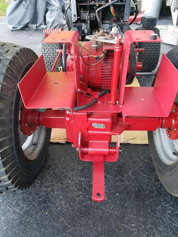

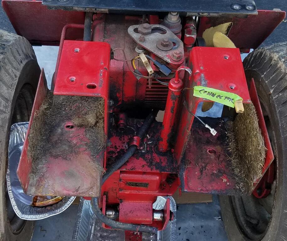

Brockport Bill 2,478 #4 Posted September 7, 2021 so here's a follow up question - ( it's a 520HC ) - and thanks for that info -- where does the air go? Seems like there would be an "air bound effect" -- i dont know a technical term. I suppose if the fill tube is used for the second filling "topping off" the oil after doing the tractor movement you suggest then we would expect the oil to displace the air ? yes/no? But how does air escape???????? As a side note when i did the tranny oil change - i added the new oil through the fill tube.... but i had totally removed one of the two bolts in the top of the tranny housing that holds seat bracket down allowing for "venting" -- but now i have those two bracket bolts reinstalled. Thanks again !! I attached 2 photos of before and after cleaning and some modest painting - the tractor was covered in "black caked oil" when i got it this spring. 4 Share this post Link to post Share on other sites
