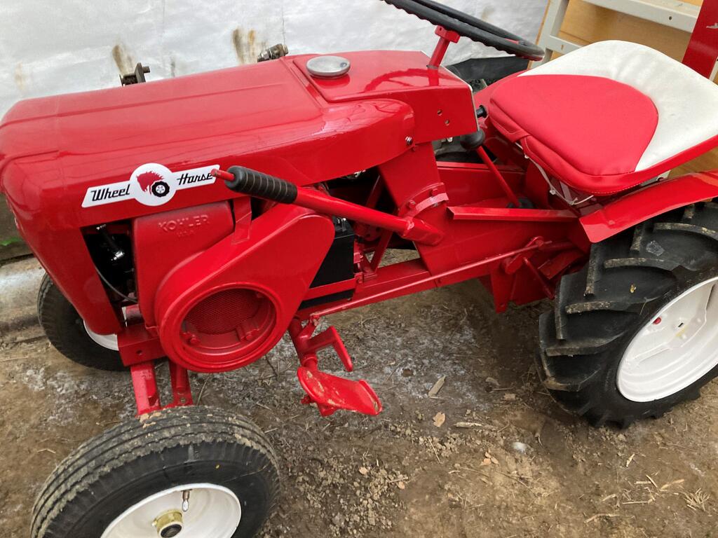

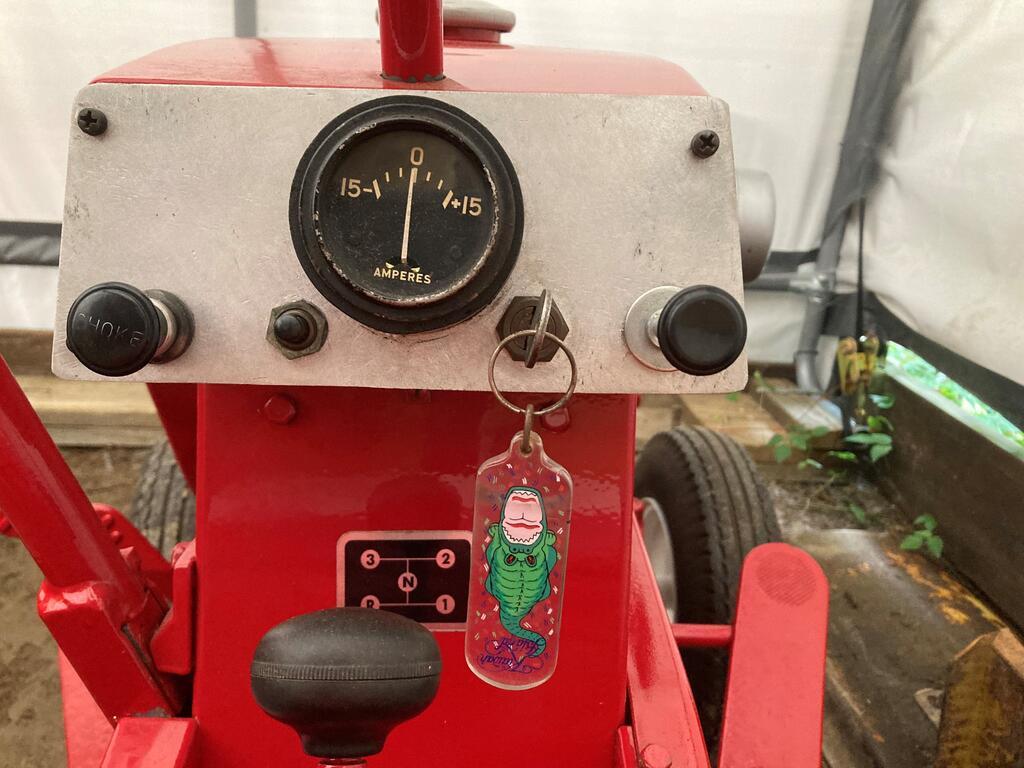

Ron S 4 #1 Posted September 4, 2021 I put this on the end of a different thread but then realized it was ended in 2014 (I'm new here forgive me for duplicate) I just got this 701 and I ordered a dash fro Glen Petit (perfect) I think the choke, ammeter, key and starter are fairly correct but throttle cable is obviously wrong. Can someone point me to a place to purchase the correct one? Was it a locking cable? Thanks, Ron 2 1 Share this post Link to post Share on other sites
Achto 32,109 #2 Posted September 5, 2021 (edited) 51 minutes ago, Ron S said: Can someone point me to a place to purchase the correct one? Was it a locking cable? Check for Willys Jeep throttle cables. You will find them in Army green and black so pay attention to that. Some times you will find locking ones but not all the time. Edited September 5, 2021 by Achto 1 1 Share this post Link to post Share on other sites
Ron S 4 #3 Posted September 5, 2021 Thanks, was the original locking type? Share this post Link to post Share on other sites
Achto 32,109 #4 Posted September 5, 2021 1 hour ago, Ron S said: Thanks, was the original locking type? I don't believe so, but I could be wrong. Share this post Link to post Share on other sites
Handy Don 16,963 #5 Posted September 5, 2021 1 hour ago, Achto said: I don't believe so, but I could be wrong. I thought it depended on the year, but I could be wrong, too! 1 Share this post Link to post Share on other sites
wallfish 20,231 #6 Posted September 5, 2021 You can probably get a correct shifter knob and front wheel bearing covers from Glen too if you're wanting full on originality. Typically those small things don't really effect the value but I get it with going as much as original as possible once you get that far. Nice tractor! I think they were locking because the vibration will usually close the throttle Share this post Link to post Share on other sites
Ron S 4 #7 Posted September 5, 2021 Thanks everyone, I guess what wallfish is saying is that my shifter knob is wrong and bearing covers are missing. This is my first wheelhorse in a fairly wide tractor collection. I bumped into it when I went to buy a motor for my IH 782. I am just learning about WH. I will email Glen but I also understand he is retiring. Anything else anyone sees wrong in the picture I would love to know. I am ordering knurled thumbscrews for the hood to replace the stainless hex hardware the last owner put in. Thanks again, Ron 1 Share this post Link to post Share on other sites
wallfish 20,231 #8 Posted September 5, 2021 1 hour ago, Ron S said: This is my first wheelhorse in a fairly wide tractor collection There's a non-wheel horse section to post pics of your collection in. Just say'n. Many here collect or are still interested in other brands too so... That's a nice find for the first one! Correct foot rests and the unique double belt guard isn't missing. The steering on those aren't the greatest or the tightest radius. Going through every steering component and replacing or tightening things up can help make a difference. 1 Share this post Link to post Share on other sites

Ron S 4 #12 Posted September 6, 2021 BTW what is the correct shift knob, anybody got a picture? Thanks! Share this post Link to post Share on other sites
wallfish 20,231 #13 Posted September 7, 2021 44 minutes ago, Ron S said: BTW what is the correct shift knob, anybody got a picture? Thanks! On the main page ( click on the big REDSQUARE banner) then scroll down through the different sections to the picture gallery. Here's what's in there for pics of 701. It's the small round knob common to all in that era. You can add yours in there as well Share this post Link to post Share on other sites
