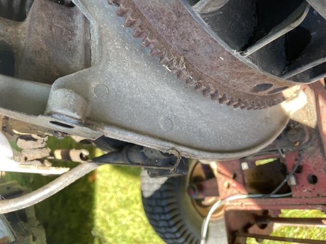

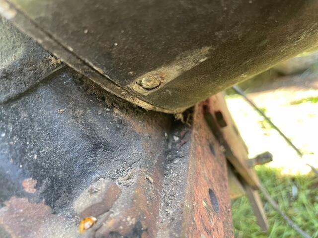

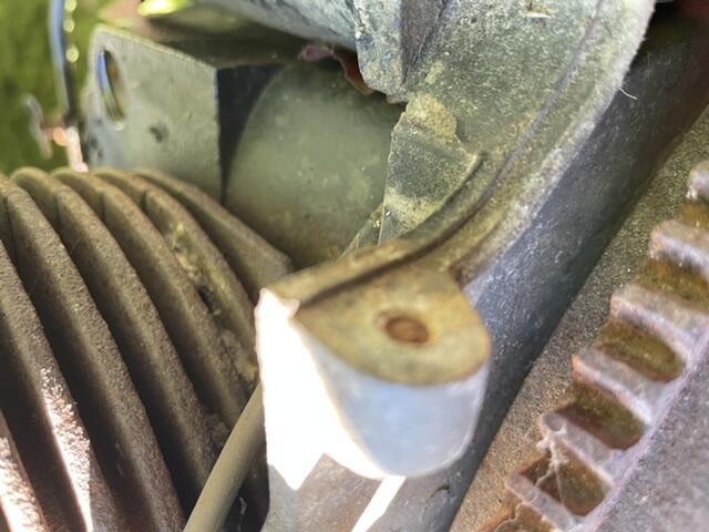

AHS 1,695 #1 Posted September 4, 2021 Ok, let’s the pictures do the talking! 4 bolts; two on bottom 2 on the sides. 3 out of 4 broke. Steel bolt into cast. I sprayed them with pb blaster. I was wondering what to do so that none of them break! There a fine line between drilling the out and breaking of a piece of the cast. (The motor) I’m all ideas! Share this post Link to post Share on other sites
RandyLittrell 3,944 #2 Posted September 4, 2021 I would keep spraying them and let them soak for a day or so, then use a punch if possible for a starting point to drill them out. That is a plate on the motor that could be replaced if things go south. Use a propane torch and put some heat on the aluminum, then spray will help too. Randy 2 Share this post Link to post Share on other sites
8ntruck 9,066 #3 Posted September 4, 2021 Ouch! Soak with penetrating oil of choice, then drill with a left hand drill? Good luck. 1 Share this post Link to post Share on other sites

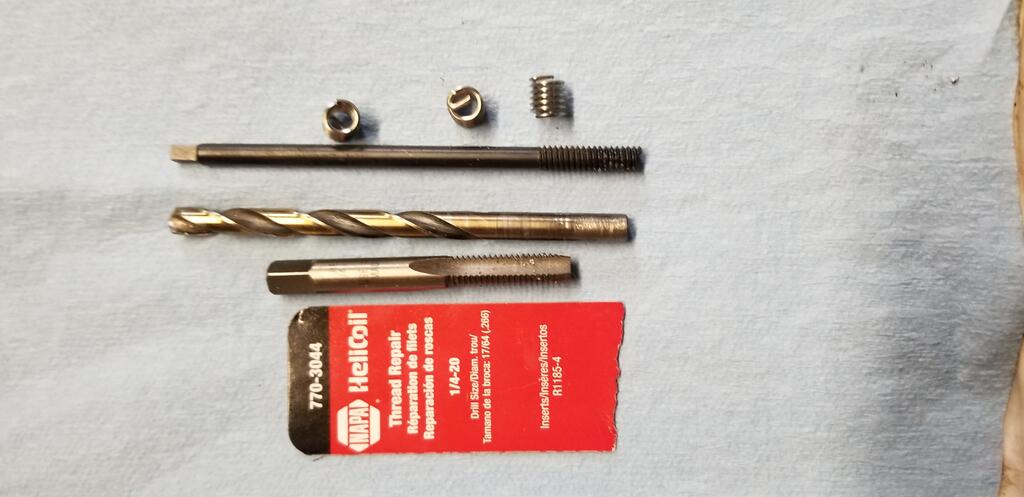

gt14rider 1,248 #5 Posted September 4, 2021 Just this same thing last week, get a helicoil from napa, did all 5. Put some loctite on coil. Share this post Link to post Share on other sites

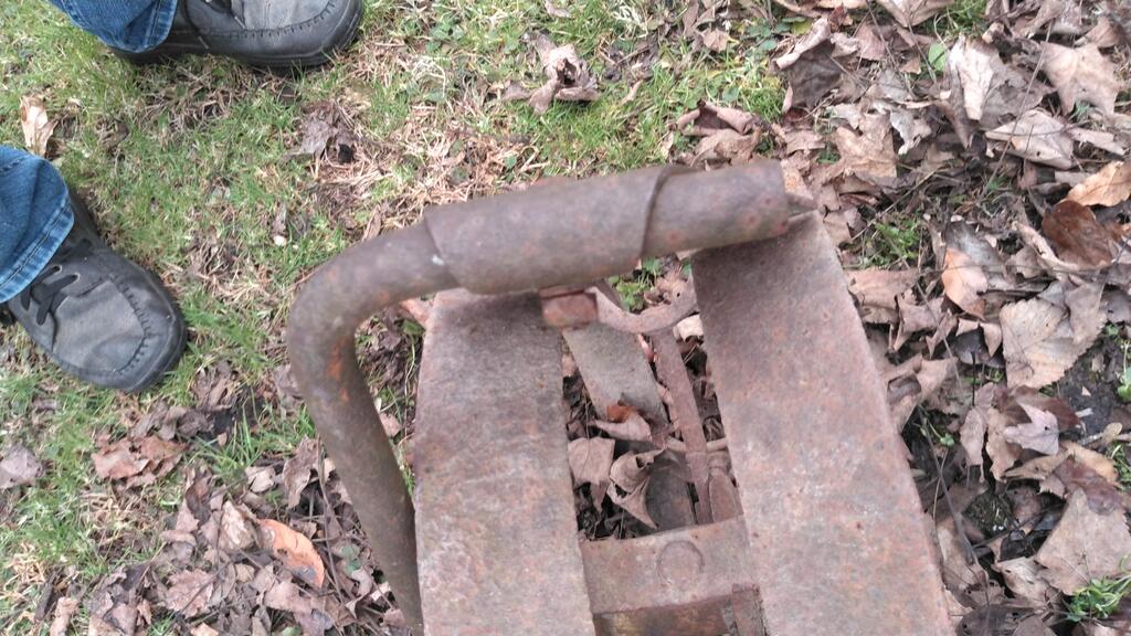

Bill D 2,997 #12 Posted September 6, 2021 Sorry to highjack this thread, but I had to share this. This is a picture of a nut holding the wheel scraper assembly for an old corn planter. This machine is rusted beyond repair and has been sitting outside for well over 60 years. The nut came loose with no heat or penetrating oil, just a 12 inch adjustable wrench. My Dad and I couldn't believe it. Just thought I'd share this. I have had the same issues on engines that you are having. I was able to weld a nut to the bolt. I then warmed up the aluminum with a propane torch and soaked it with penetrating oil. I had to reweld the nut several times but eventually all the bolts came out. 2 Share this post Link to post Share on other sites
oliver2-44 11,632 #13 Posted September 6, 2021 9 minutes ago, Bill D said: Sorry to highjack this thread, but I had to share this. This is a picture of a nut holding the wheel scraper assembly for an old corn planter. This machine is rusted beyond repair and has been sitting outside for well over 60 years. The nut came loose with no heat or penetrating oil, just a 12 inch adjustable wrench. My Dad and I couldn't believe it. Just thought I'd share this. Years ago they used “white lead” as anti-seize. It last and works almost forever 2 Share this post Link to post Share on other sites
Bill D 2,997 #14 Posted September 6, 2021 3 hours ago, oliver2-44 said: Years ago they used “white lead” as anti-seize. It last and works almost forever That explains it. Thanks. 1 Share this post Link to post Share on other sites
