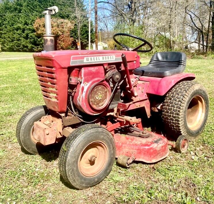

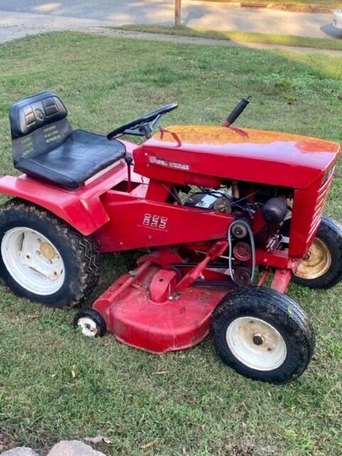

Greentored 3,220 #1 Posted September 3, 2021 30+ years of cutting grass and I've never put a fresh set of blades on a machine, just sharpen, balance and go. Now 'lawn duty' the 1277 and 'lil booger' 655 are due, and i'd love to slap a brand new set under em! Do you folks have a preference, opinion, or favorite blade? The 1277 is now running a 16hp Kohler and 42" deck, so I can likely slap about anything under there and it'll swing it. May have to stay a bit conservative on the 655 for obvious reasons. Both are rear discharge decks if that makes a difference. Thanks fellas! 1 Share this post Link to post Share on other sites
