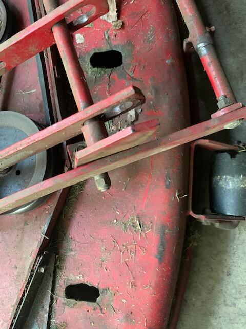

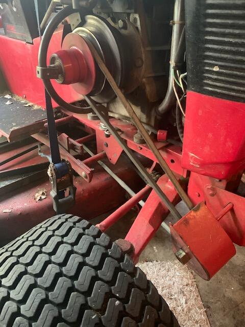

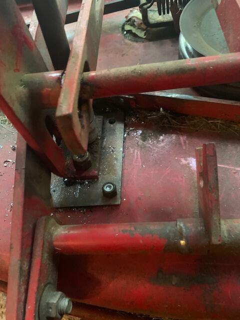

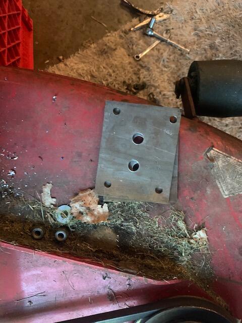

Sewman 20 #1 Posted September 2, 2021 I picked this 520H up at a decent price because it had the vac-bagger on it BUT the deck mounting brackets pulled out of the deck & the PO had a ratchet strap going over the hood & hooked on each side of the deck to mow.I've been looking for a deck & can't find one so I decided to plate it.It ended up not being too bad of a job. 2 3 Share this post Link to post Share on other sites
Pollack Pete 2,273 #2 Posted September 2, 2021 Common problem on those mower decks.Looks like you've got it covered.Good job.Keep that deck clean.....top and bottom. 1 Share this post Link to post Share on other sites

peter lena 10,090 #4 Posted September 2, 2021 @Sewman agree with others on the save , with what you have , hope you manage to find a good spare deck , notice none of the lift frame movement areas have any lubrication on them , but the movement points are wallowed out . make a point of using chassis grease on those areas , for a smooth deck / frame follow. did you clean out the bottom side ? oil soak it down to kill off the rust and lubricate the metal ? decks are typically not looked at till they fail , hope you recover yours , concentrate on the lubrication of the shell , that's what cause the bracket break off . regularly drop mine to check it over , always do a lubricant addition to the hidden areas . just my own experience , pete 1 Share this post Link to post Share on other sites
JoeM 10,317 #5 Posted September 2, 2021 Nice fix! That is one I have never scene before. Strap A Matic! 1 1 Share this post Link to post Share on other sites
Handy Don 17,563 #6 Posted September 2, 2021 (edited) 45 minutes ago, JoeM said: Nice fix! That is one I have never scene before. Strap A Matic! Ingenious (and hilarious)! Surely got OSHA's highest rating. Edited September 2, 2021 by Handy Don 2 Share this post Link to post Share on other sites
kpinnc 19,008 #7 Posted September 2, 2021 Nice job on the repair! Amazing (or frightening) how folks come up with a method to get things done. My first wheelhorse's PO sold it to me because it was hard to crank and left an uneven cut when mowing. He had replaced a deck guage wheel with a round block of wood that was more than an inch smaller than the other side. I didn't say a word... And the hard starting issue was because the positive post on the battery was covered in dark green corrosion. He replaced the starter but never cleaned the battery terminals. I guess some folls just should not attempt maintenance of any kind. 3 Share this post Link to post Share on other sites
