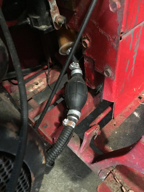

SylvanLakeWH 32,607 #8 Posted September 2, 2021 I put an in line marine bubble and it works like a charm… couple squeezes and she fires right up… 2 Share this post Link to post Share on other sites
Esbrian 16 #9 Posted September 2, 2021 (edited) 27 minutes ago, SylvanLakeWH said: I put an in line marine bubble and it works like a charm… couple squeezes and she fires right up… Glad to see im not alone with this issue! Was pretty pissed when it started, as I'd finally gotten my deck to behave after 2 weeks of drama, but it was pretty gratifying to get it running again Edited September 2, 2021 by Esbrian 2 Share this post Link to post Share on other sites

kpinnc 18,978 #11 Posted September 2, 2021 (edited) 8 hours ago, SylvanLakeWH said: I put an in line marine bubble and it works like a charm… couple squeezes and she fires right up… I've used these for my tractors that have the fuel tank under the seat for years. Best cheap fix for saving batteries and starters. Otherwise you can kill the battery before the onboard fuel pump can refill the carb. No question that keeping good fuel lines is a good thing, but you will never find all the places in the fuel path that allows some air into the system. Edited September 2, 2021 by kpinnc 1 Share this post Link to post Share on other sites
