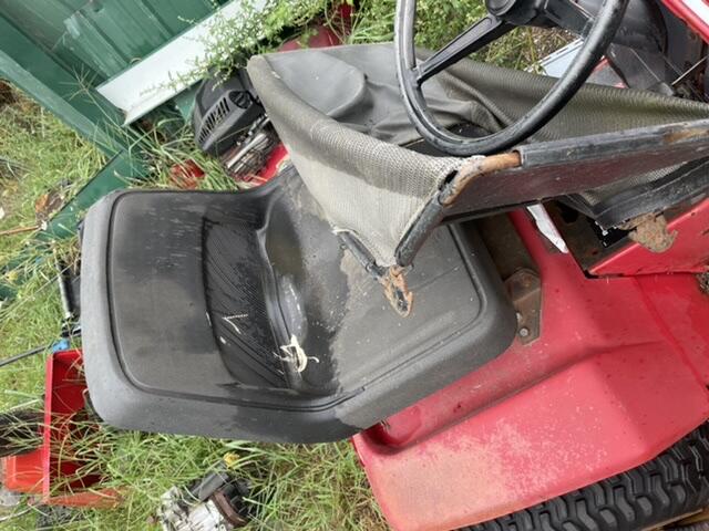

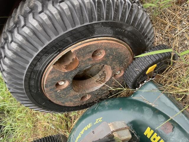

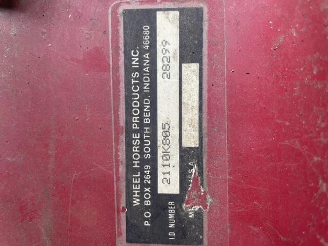

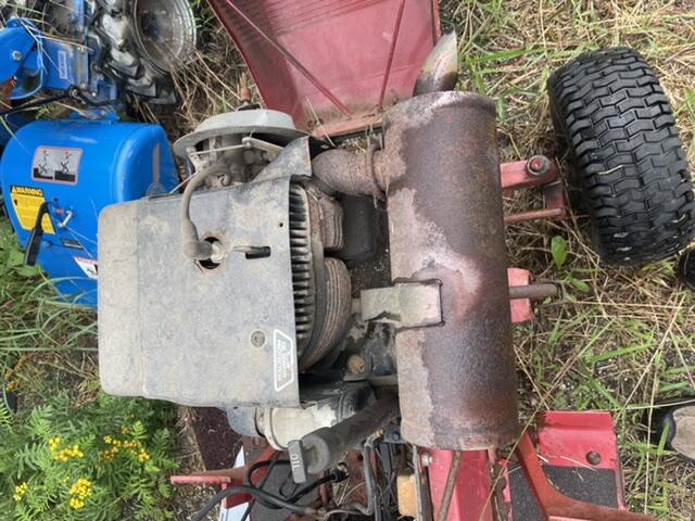

AHS 1,594 #1 Posted August 30, 2021 I’ve been waiting for this…. For about a year! For $175!! It’s got 4 inflated tires… bonus!! A M10 and a unripped seat and a muffler with NO holes and wheel weights!! With smaller tires (I think) and 1” axles. It’s got water in the gas tank… the gas cap with the gauge is missing the clear peice. The wheel weights alone would cost $150 easy!😀 the pics are probably upside down, you’ll just have to stand on your head.😀 4 4 Share this post Link to post Share on other sites

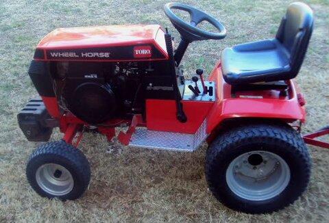

kpinnc 17,147 #4 Posted August 30, 2021 My 310-8 was my first tractor 25 years ago. Still the most dependable hardest working machine I have. Mine is a 1987 (looks like yours is 87 or newer), and still runs strong! Of course I dressed it up a little... 6 Share this post Link to post Share on other sites

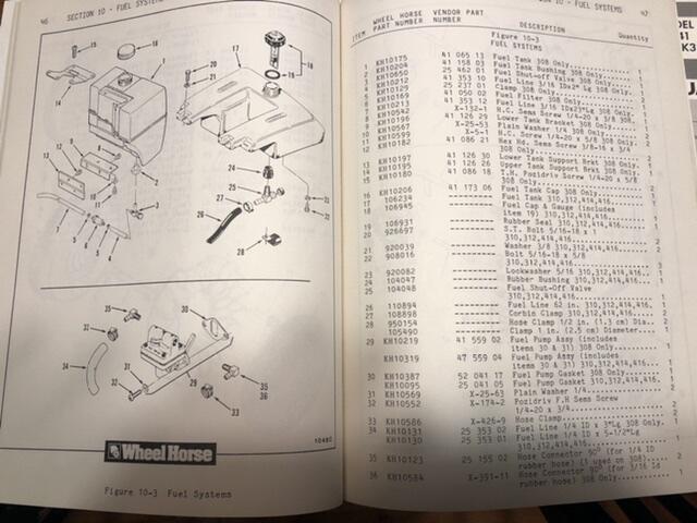

AHS 1,594 #11 Posted September 2, 2021 For my 310-8 what’s the part number for the gas tank shut off valve and the grommet? The tank is empty, and the gas line is hard and cracked! I wanna start all new! Share this post Link to post Share on other sites
WheelPuke 78 #12 Posted September 3, 2021 (edited) According to my 1988 300/400 Series Parts & Service Manual the parts that fit your 310: Shut off valve number is: 104048 fuel line from the petcock is: 110894 Corbin clamp number is: 108898 Rubber bushing, as the manual calls it : 104047 Good thing I re-read before I posted because I almost called it a feces off valve. Darn phones. Edited September 3, 2021 by WheelPuke Left off a part 3 Share this post Link to post Share on other sites
WheelPuke 78 #13 Posted September 3, 2021 I’ll attach this in case I am referring the the wrong fuel system. Let me know if it is legible. If not I can email you a better resolution photo if you’d like. 1 Share this post Link to post Share on other sites
