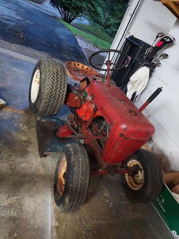

HorsePower58 12 #1 Posted August 30, 2021 Hey good people, I picked up an RJ58 and it has what looks like a set of rear wheels/tires from a C-1XX series maybe. Not sure. Just thought I would inquire if someone knew where original or close to original rear wheels for an RJ style tractor could be found. Here's a picture of what's on there now. Also, because of the wheels that are on it, I'm wondering if that's why the toolbox and rear fenders are not there, or if this is normal for a later rj58 to not have those. According to transmission tag, its H - 27 - 8 (August 27 1958). 1 2 Share this post Link to post Share on other sites

Achto 29,421 #3 Posted August 30, 2021 (edited) 37 minutes ago, HorsePower58 said: I'm wondering if that's why the toolbox and rear fenders are not there, or if this is normal for a later rj58 to not have those. I do believe that fenders and tool box were an option. (could be wrong on that) Original rear tires would be 6-12's, rims for this size tire will fit from many other brands of tractors that used this tire size. Here is one source for tires. https://www.millertire.com/categories/lawn-garden-tires/6-12/ Edited August 30, 2021 by Achto 3 1 Share this post Link to post Share on other sites

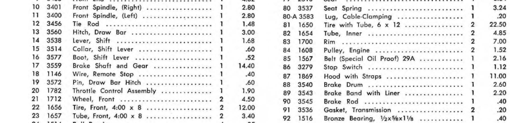

Gregor 4,847 #5 Posted September 1, 2021 Ref. # 22, front tire. Ref. #81, rear tire 1 Share this post Link to post Share on other sites
formariz 12,045 #6 Posted September 1, 2021 On 8/30/2021 at 3:19 PM, Achto said: I do believe that fenders and tool box were an option. (could be wrong on that) Original rear tires would be 6-12's, rims for this size tire will fit from many other brands of tractors that used this tire size. Here is one source for tires. https://www.millertire.com/categories/lawn-garden-tires/6-12/ Welcome aboard . All above is correct. I always liked them better without fenders or tool box with ags. Gives them an even "older look". Still has the often missing original belt guard. 2 Share this post Link to post Share on other sites
