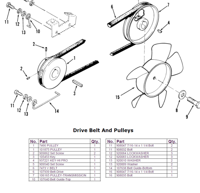

cjb398 39 #1 Posted August 30, 2021 I need to replace the drive belt on a 1980 C-175 Automatic. The 01-17KE01 TIPL (shown below) seems to list two numbers for the belt. 7343 and 107939. Are these two numbers for the same belt? I ordered the 7343 belt but am second guessing myself. Share this post Link to post Share on other sites
gwest_ca-(File Mod) 12,454 #2 Posted August 30, 2021 From the belt charts Transmission drive belt 108502 - (HB/5L x 83" or 5/8" x 83") The 107939 is for twin 8-speed models. 107939 replaced by 93-9809 - (HB x 83.5" or 5/8" x 83-1/2") 7473 is for single 8-speeds - Transmission drive belt 78-7100 replaced by 7473 - HB x 81.9" or 5/8" x 81.9" Share this post Link to post Share on other sites
cjb398 39 #3 Posted August 31, 2021 9 hours ago, gwest_ca said: From the belt charts Transmission drive belt 108502 - (HB/5L x 83" or 5/8" x 83") The 107939 is for twin 8-speed models. 107939 replaced by 93-9809 - (HB x 83.5" or 5/8" x 83-1/2") 7473 is for single 8-speeds - Transmission drive belt 78-7100 replaced by 7473 - HB x 81.9" or 5/8" x 81.9" Thank you! In looking at this file and looking again at my model number, I was wrong on what I had and what I needed on several accounts. First, what I have and is stamped on the identification plate is a model 11-17KE01, not a 01-17KE01. That means it is a 1984 model, not 1980. And that means that the belt should be the 108502 and not the 7473 I originally thought. Got the right one on order now! Share this post Link to post Share on other sites
