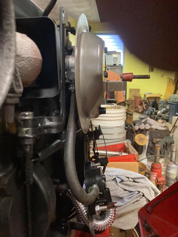

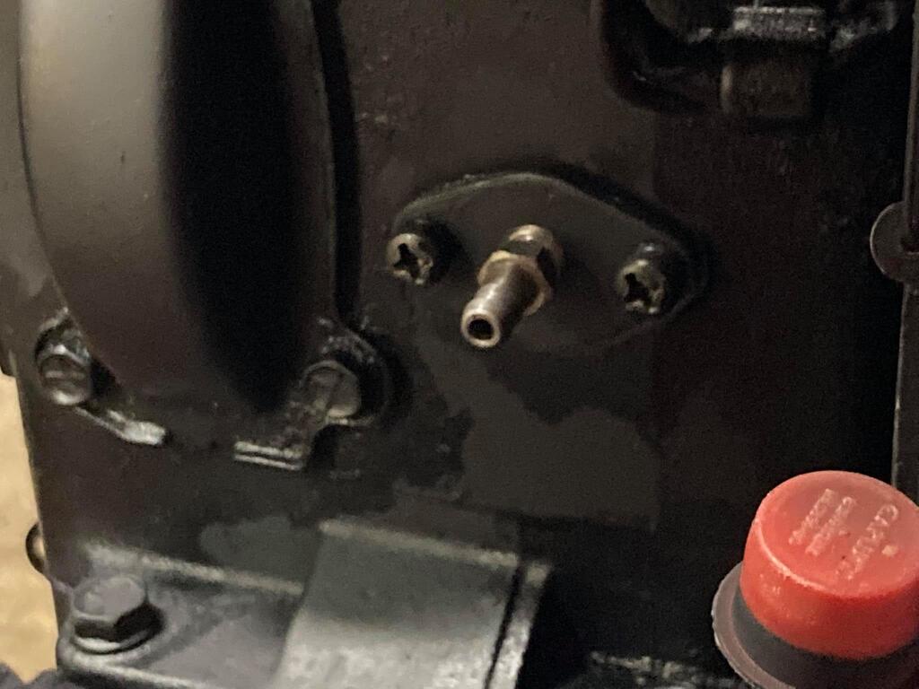

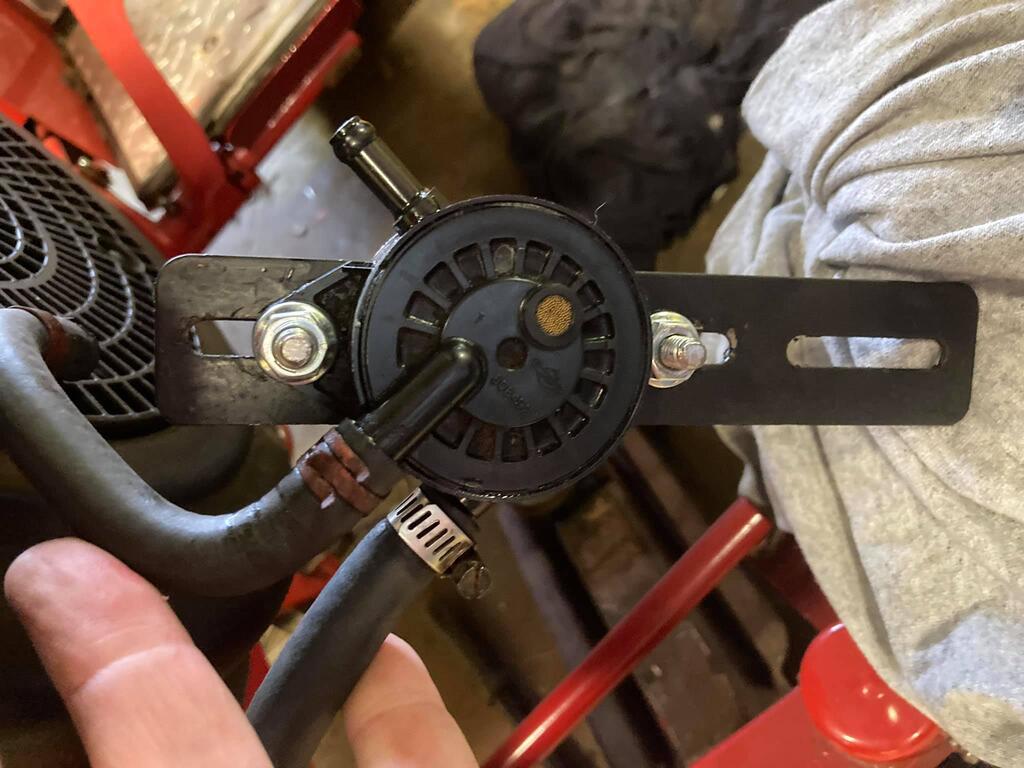

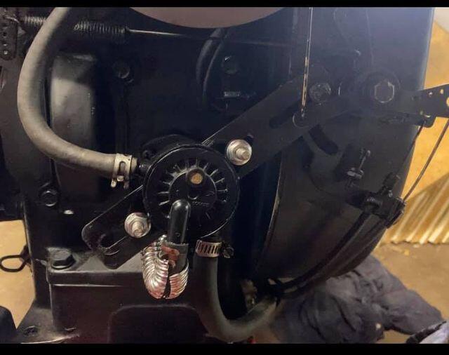

"Manic-Mechanic" 1,485 #1 Posted August 30, 2021 (edited) Hello, finally made use of a fuel pump plate & nipple of an old K241. Grew tired of the old diaphragm going bad , leaking fuel into the sump, draining the oil, etc. Then after rebuilding several only to have them fail some other way, time to change it out! Just removed the Shroud bolt aside the Choke/Throttle Linkage and fit just nice & tight. The bracket was too simple! A straight piece of slotted steel to accommodate 1/4-20 Carriage Bolts. I harvested the Pulse Pump off a Briggs Intek 17hp, however, many manufactures use these, as does Kohler. A piece of hose protector around the line as it circled under the bracket back to the vacuum nipple. The pre-formed double 90 rubber fuel line and protector loom came with a Briggs Carburetor Kit for my Ariens Snow Thrower No more stalling going into full throttle. No more hard starts. The new Carburetor from I Save Tractors, still in the box.... Edited August 30, 2021 by "Manic-Mechanic" Description per picture. 6 1 Share this post Link to post Share on other sites

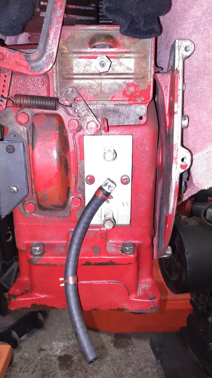

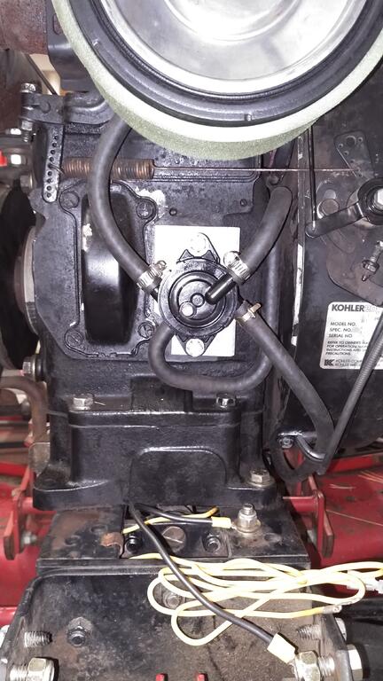

Bill D 2,997 #4 Posted August 30, 2021 (edited) I've been doing this for the last two years now. Works great. I make the mounting plates using stainless steel so I don't have to paint them. Edited August 30, 2021 by Bill D 1 2 Share this post Link to post Share on other sites

"Manic-Mechanic" 1,485 #9 Posted September 1, 2021 (edited) On 8/30/2021 at 11:47 AM, Bill D said: I've been doing this for the last two years now. Works great. I make the mounting plates using stainless steel so I don't have to paint them. I like that set up, nice and tight, and yes, no paint! I see the elbow too, I know I have one of those somewhere! Edited September 1, 2021 by "Manic-Mechanic" Share this post Link to post Share on other sites
