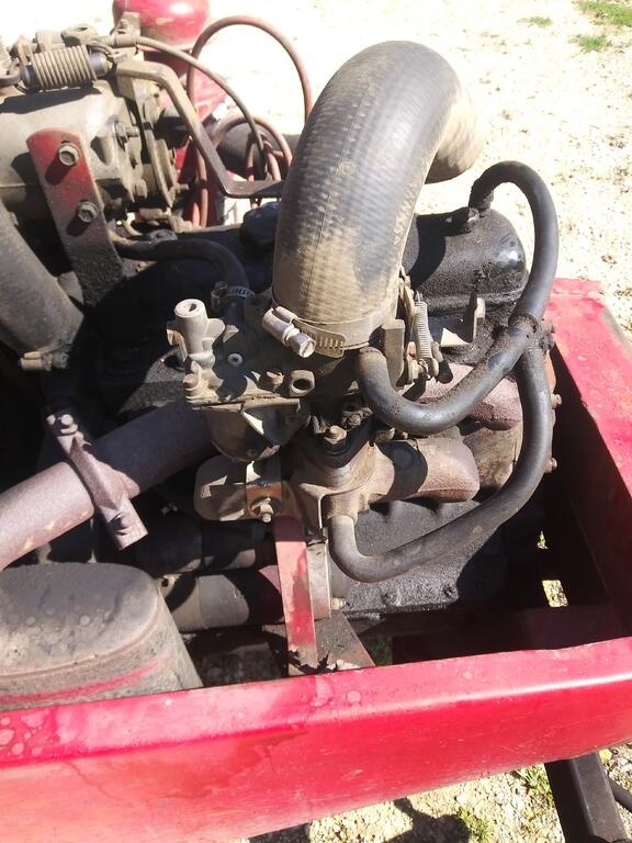

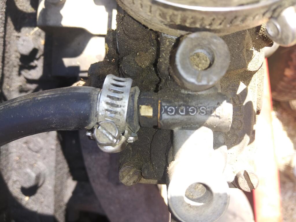

6wheeler 676 #1 Posted August 29, 2021 Hi all. I have a problem that maybe you all can help. My Toro Groundsmaster needs a carburetor. Or? At least a kit. The problem is? There is no tag on the carb. It should be on a tag on a bowl screw. Not. It is the Continental engine with a Solex down draft single barrel. The Model# is 30778 on the machine. Unfortunately I cannot find a part# on the parts viewer. My service manual just says it is a Solex and how to adjust it. Any help will be appreciated. Thanks Pat Share this post Link to post Share on other sites

6wheeler 676 #6 Posted August 31, 2021 Well? I found more info on the carb. It is a Solex BTE SDGD. Unfortunately, it does not have a kit. I can have rebuilt. For $550.00. So? I did the right thing and took it apart. I cleaned it. The accelerator pump was leaking like a screen door in a submarine. So? I took some right stuff silicone (which, incidentally IMO is the best) and created a light silicone skin over the inner and outer surface. Right Stuff is impervious to gasoline. Put it back in. Also a light coat on the old top gasket. And? Voila! No leaks. It is running quite well now. The PO had the governor completely set all wrong. I readjusted it to spec. I readjusted the air mixture screw. And? Now it starts and idles like it should. I am going to set up the valves next. It will finish the season. But? Since she goes through more oil than OPEC? I see a repower coming in ts future.😁😁😁 Share this post Link to post Share on other sites
