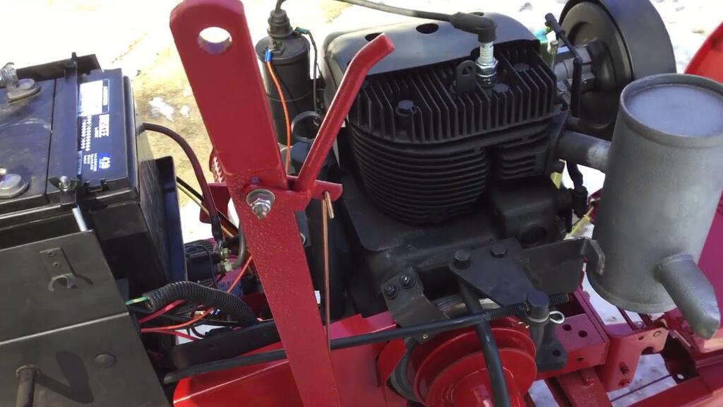

Mustang67ford 234 #1 Posted August 28, 2021 Hello, looking to get a 414-8 I found. It has a kohler k321s motor that looks like it is new. I noticed the 2 motor mounting bolts on the pulley side are off the side of the frame and not bolted. Did a search on the internet and found this pic. Is that normal? Is it bolted thru underneith somehow? Share this post Link to post Share on other sites
pfrederi 21,301 #2 Posted August 28, 2021 Welcome. Yes the right side is bolted up through the frame into the oilpan of the engine Share this post Link to post Share on other sites

Maxwell-8 4,371 #5 Posted August 28, 2021 My 16hp kohler on Amy my C175 is only bolted up with two bolts as the pan has no treads nor holes in the oil pan ( BUT it ain't the original engine) I believe this was my first question on the forum too , your are welcome @Mustang67ford Share this post Link to post Share on other sites
Ed Kennell 47,811 #6 Posted August 28, 2021 (edited) 52 minutes ago, Maxwell-8 said: up with two bolts as the pan has no treads nor holes Some use a "J" bolt hooked under the frame to secure the right side of the block. Oh, to the @Mustang67ford Edited August 28, 2021 by Ed Kennell 1 Share this post Link to post Share on other sites
