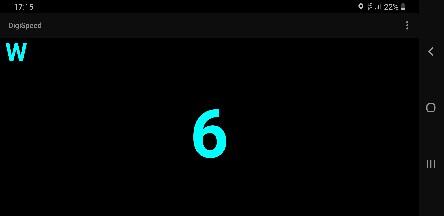

Bertie 314 #1 Posted August 25, 2021 On average my 1974, D160 with a kohler k341 engine on full throttle is averaging 9.6 kph (6 mph) on flat ground, uphill or downhill. What kph were they when new... anyone know please? Share this post Link to post Share on other sites

Bertie 314 #5 Posted August 25, 2021 (edited) Thanks guys its certainly quicker than any other wh I own or have ridden, I will change the settings on the app tomorrow to read kph from mph and check again... ps: it's on factory 15" rear rims Edited August 25, 2021 by Bertie Share this post Link to post Share on other sites

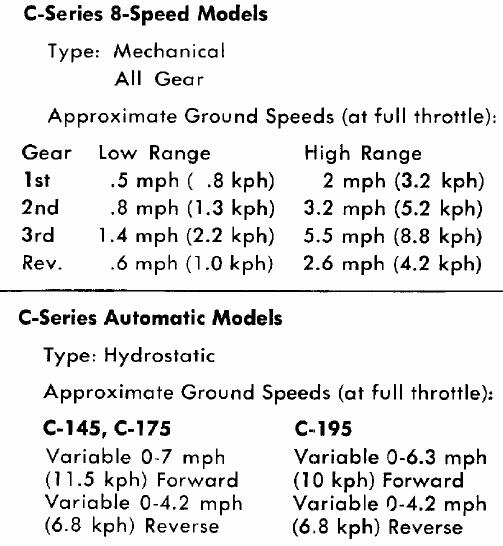

gwest_ca-(File Mod) 12,454 #7 Posted August 25, 2021 From the 1978-79 B, C and D-Series service manual 1 Share this post Link to post Share on other sites
Bertie 314 #8 Posted August 25, 2021 14 minutes ago, gwest_ca said: From the 1978-79 B, C and D-Series service manual Thanks for this, cant believe it's still strong at 47 years old 👍 Share this post Link to post Share on other sites
