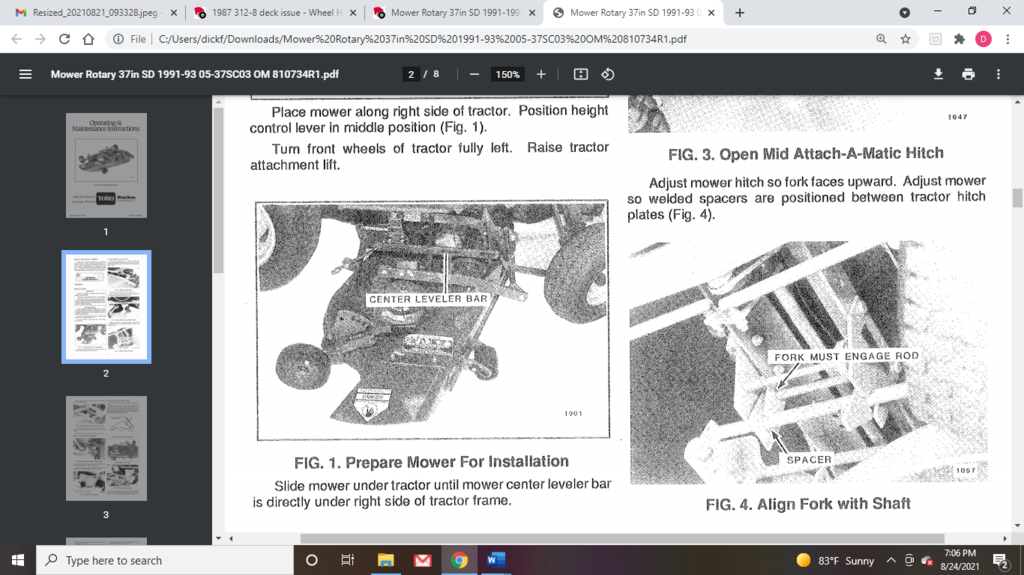

fourwheels0 191 #1 Posted August 24, 2021 I have a 87 312-8 with a 37 inch deck and bagger. The issue is the left front tire hits the deck why would this be. Yes it has 6 inch front tires. Share this post Link to post Share on other sites
dcrage 636 #2 Posted August 24, 2021 Are you sure that the deck is mounted into the small fork on the front attach-matic. All kinds of weird stuff happens when you miss that fork. 2 Share this post Link to post Share on other sites
953 nut 69,812 #3 Posted August 24, 2021 Here is a screen **** and the manual to help you out. Share this post Link to post Share on other sites
fourwheels0 191 #4 Posted August 25, 2021 Thanks I'll look into it. 1 Share this post Link to post Share on other sites
fourwheels0 191 #5 Posted August 25, 2021 Sure enough the deck wasn't mounted right. It was hanging crooked. Gonna be selling the deck and bagger setup. It will be listed soon. 2 Share this post Link to post Share on other sites
