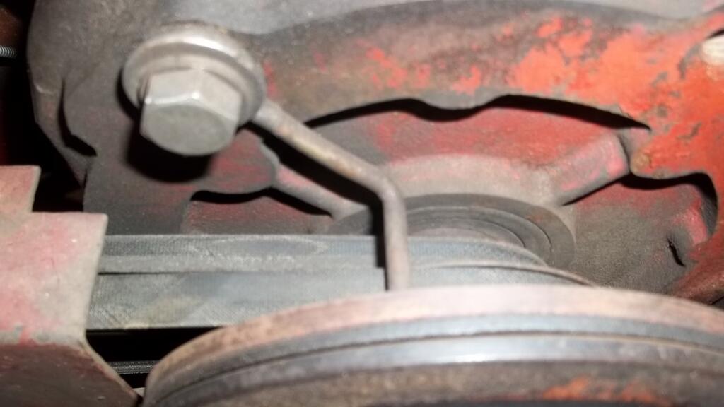

Bach-Ed 170 #26 Posted August 23, 2021 Just for the record my tractor has a belt guard. But If I had it on you wouldn't see a thing in the pictures. The original K series motor had a wire near the pulley. But the CH can't use that wire. 2 1 Share this post Link to post Share on other sites

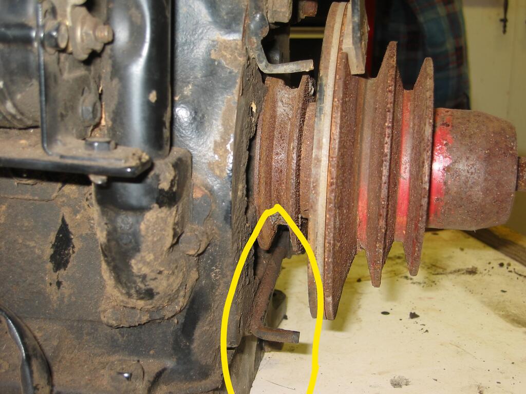

pfrederi 21,005 #27 Posted August 23, 2021 16 minutes ago, Bach-Ed said: Just for the record my tractor has a belt guard. But If I had it on you wouldn't see a thing in the pictures. The original K series motor had a wire near the pulley. But the CH can't use that wire. If with a new wrapped belt you still have problems i would look at bending some rod to make a guide. There are holes in your engine block that you can use. or you can weld a tab as used in later models on the bottom of your belt guard. 1 1 Share this post Link to post Share on other sites

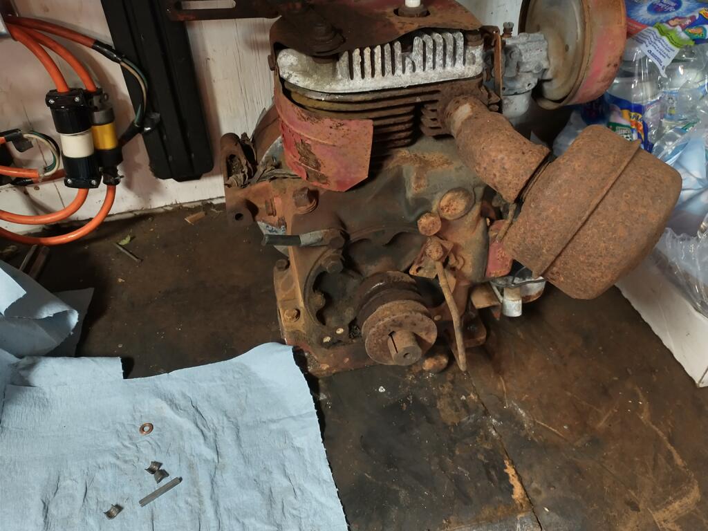

ebinmaine 80,112 #28 Posted August 23, 2021 28 minutes ago, squonk said: I'm m going to quote you Eric! I took this engine out of what looked to be an un-molested 702 and there is a wire on it. Very interesting... Share this post Link to post Share on other sites
Bach-Ed 170 #29 Posted August 23, 2021 That looks like a good idea to add to the lower flange. Share this post Link to post Share on other sites

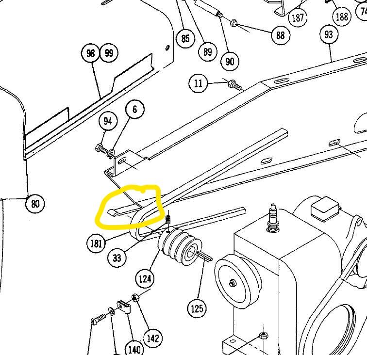

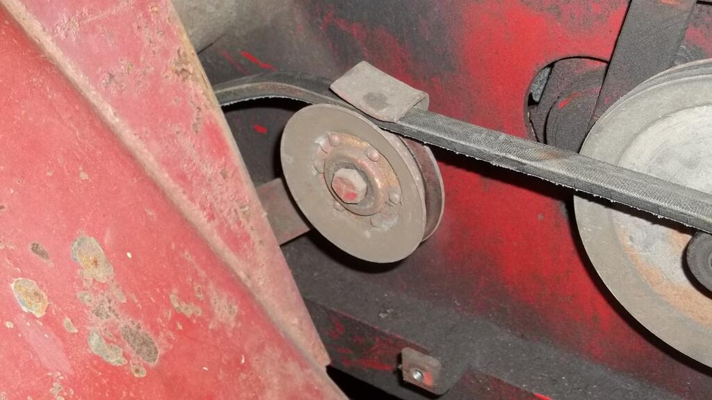

953 nut 68,227 #30 Posted August 23, 2021 Your belt guard needs to support the slack when the clutch is depressed. The wire retainer on the engine pully is there to keep the belt from coming off the engine pully. The tab on the idler helps the belt to stop when there is slack but the lower guard rail does the majority f the work. 1 Share this post Link to post Share on other sites

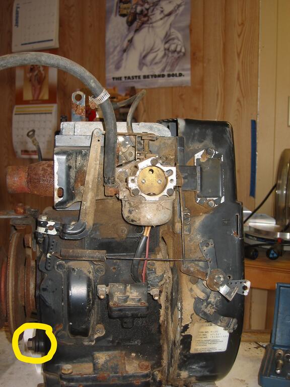

Bach-Ed 170 #32 Posted August 26, 2021 I am here to declare a victory! I went and ought a green NAPA belt and installed it. Replaced the guard. And Oh no It didn't fix it. Then thinking about what was said, I installed this bolt. into a mounting hole on the engine. TA DA and all is well. It just clears when the belt is engaged. It is a little grabby when I release the clutch, I'll learn the sweet spot. Now I have to go back and fix the it dies on the hill problem. 2 2 Share this post Link to post Share on other sites

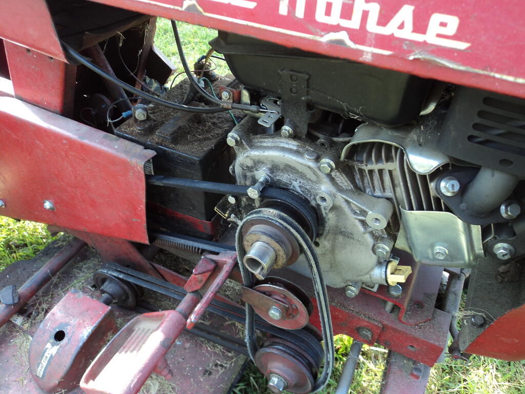

pfrederi 21,005 #34 Posted August 26, 2021 Your belt guard was hacked off considerably. In addition to you bolt you may want to fabricates a wire support at the bottom of the pulley similar to this 2 1 Share this post Link to post Share on other sites
Bach-Ed 170 #35 Posted August 26, 2021 pfrederi I think I will take you up on that. Especially after how the PO wacked that guard off. ebinmaine about rust in the pulleys do you mean on the wear surface of the pulleys? 1 Share this post Link to post Share on other sites
